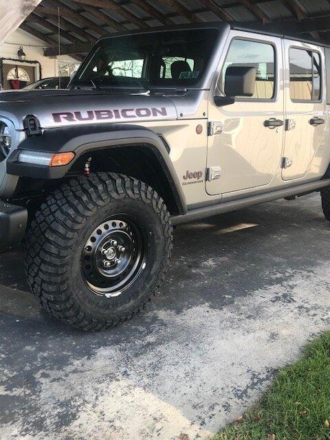

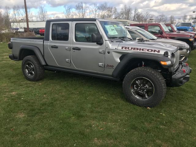

I went with factory steel spare wheels all around. I am a fan of them. The tires are 35". I have more plans for the JT, just getting started, but it will more of an overland vs rock crawler. I am a minimalist and prefer to have a more "stockish" vehicle than a overly modified vehicle. This is from experience and travels. I have a heavily modified 06 LJ Rubicon and a 91 Landcruiser with portal axles. Constantly wrenching on modified vehicles and always chasing the perfect set up.

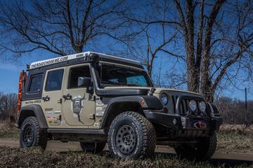

Not exactly the same wheel, but I like these on Jeeps. They are the steel wheel from the jeep commander.
I
That is my Jeep :)
I'm asking if anyone has ever tried these wheels on a Gladiator?
There is a post at the bottom of last page that says they were told the breaks will not clear, but I can not find a 100% confirmation from someone that really honestly tried to bolt them up.
Any help appreciated.
-Dan
