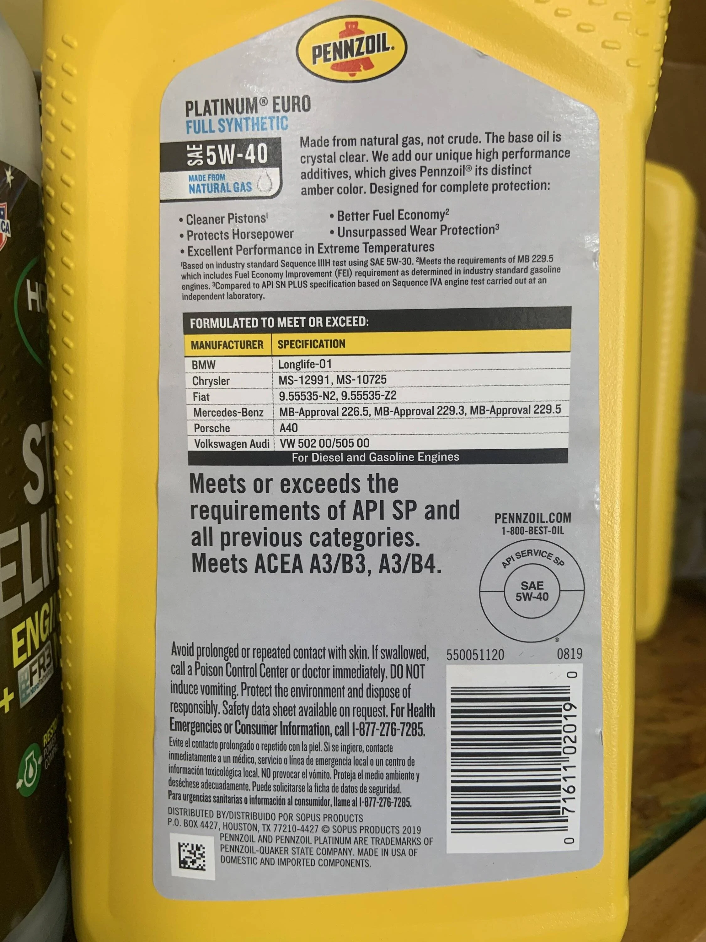

Kind of like Penzoils Super Duper oils, Nothing on their bottle says they are "Approved"?
Their labels states that it is formulated to meet or exceed the MS12991, nothing about whether it does or not.

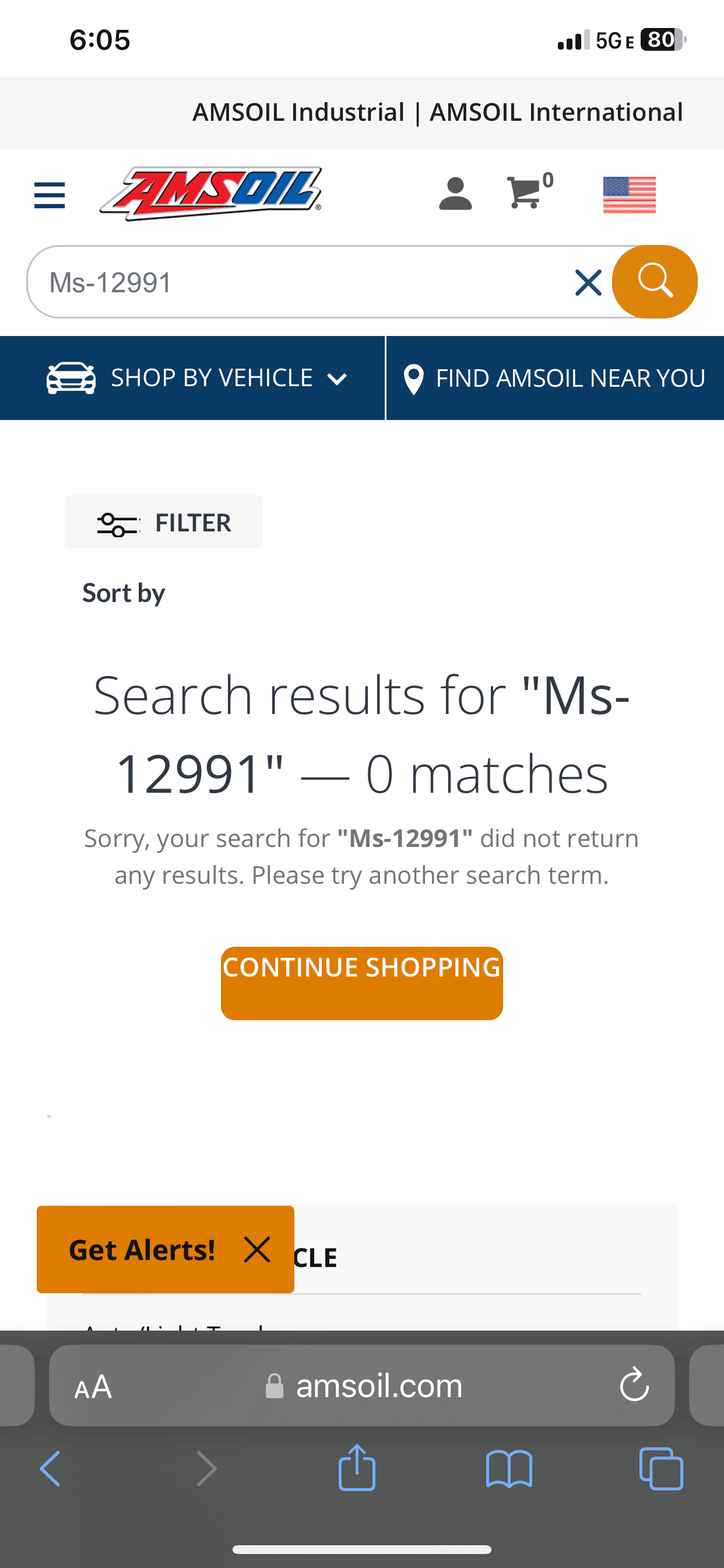

Have been known or commonly known??? Simple, if MS-12991 isn’t on the bottle don’t put it in.
I was recently shopping for gear lube so I also looked to see if some others around has upgraded their packaging or specs. I was crossing my fingers hoping Amsoil was there but it wasn’t listed on the bottles or website.

Amsoil does not list MS-12991…wish it did

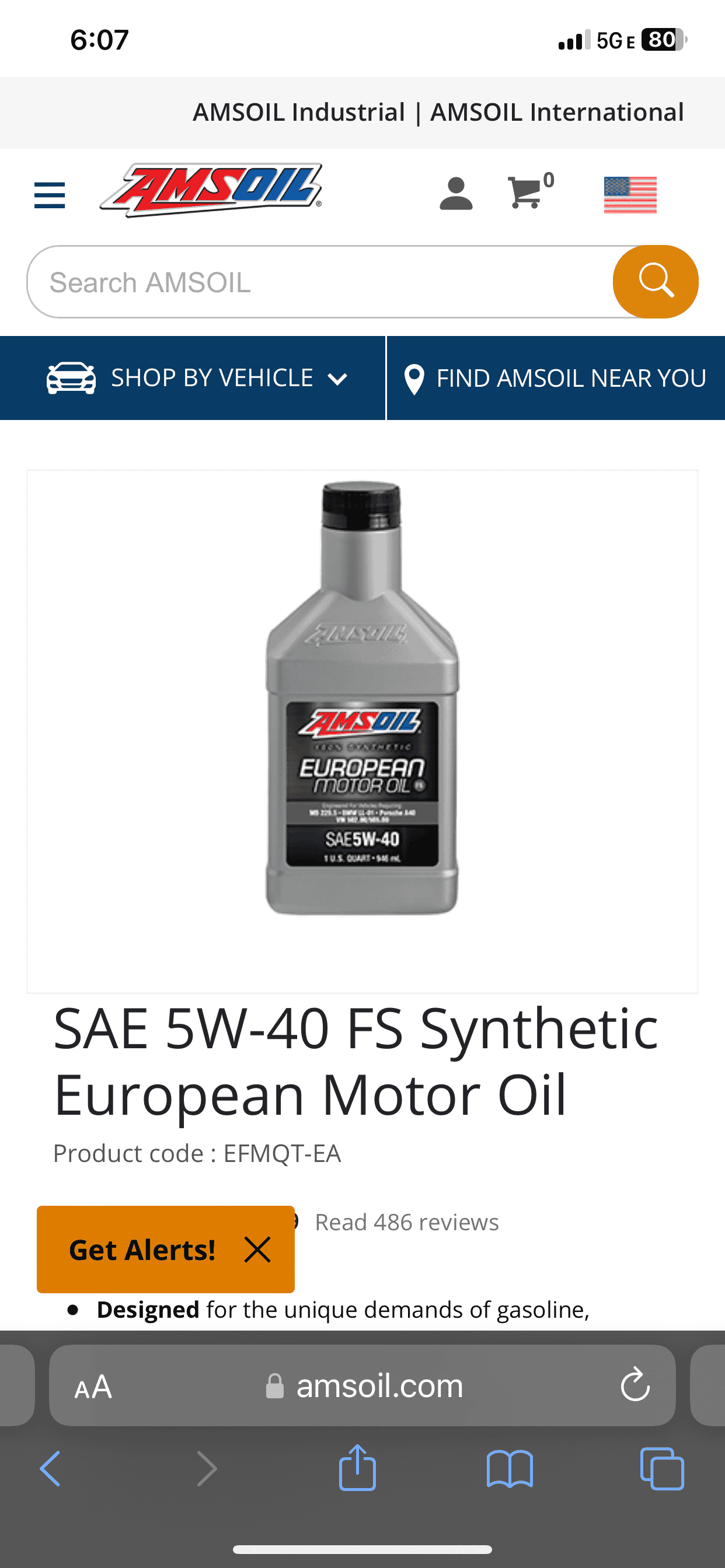

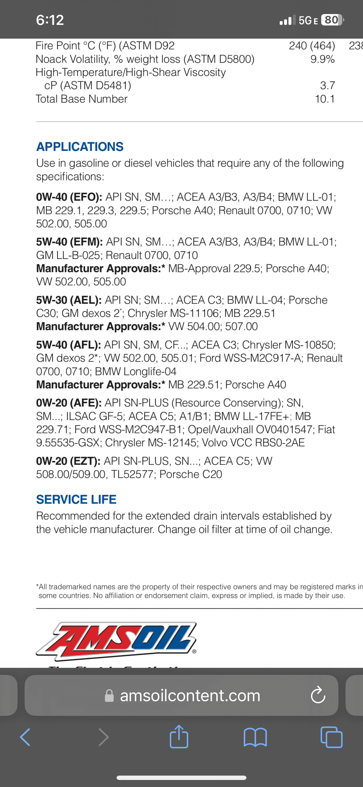

Amsoil tech support says that MS-12991 is an old outdated spec and that EFM 5W-40 exceeds it.

I purchased Amsoil last year sometime for my ED based on their website recommendation for which type. My first Amsoil purchase. Once received, No listing on the bottle to meet MS spec so I emailed them for clarification. The response was basically not going to happen do to cost, nothing about the product meeting/exceeding spec, yet Porsche and Mercedes were listed.
