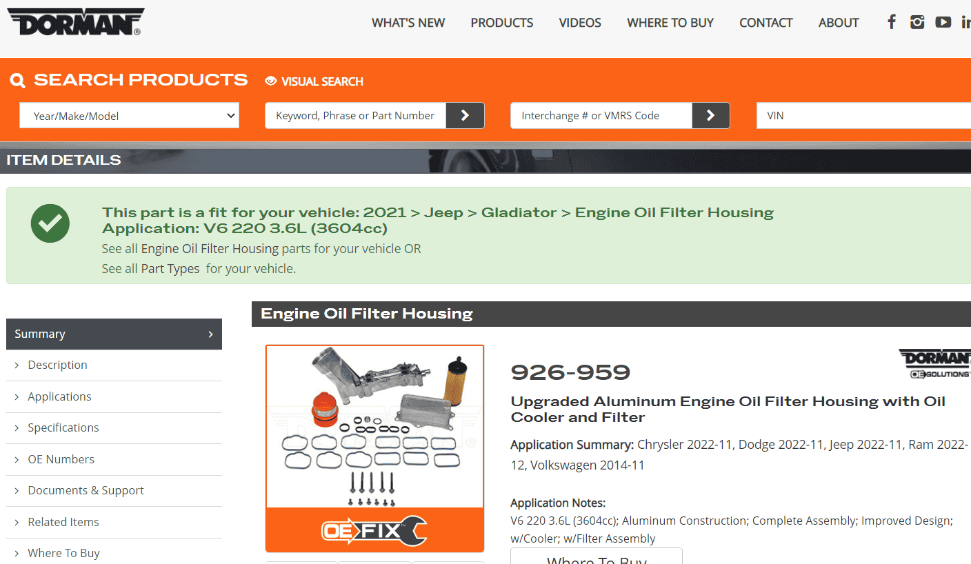

Are you replacing with another plastic cooler or going to the Dorman metal unit? A grand seems a little steep, not sure what your hourly labor rate is but this should not take longer than 2 to 3 hours with air or hand tools if the tech has done before,
FWIW, the Dorman all metal unit is not a direct plug and play on our Gen 3 PUG engines. The base will fit but the oil cooler you are expected to take off the removed plastic filter housing will not directly bolt on. You have to find a oil cooler from a Gen 2 Pentastar oil filter/cooler assembly.
Doorman does not catalog this unit for our Pentastar Gen 3 PUG engines.
The Dorman 926-959 complete unit shows as applicable to the JT according to their web site:
Cool, that is new then. They originally and still sell the housing without the cooler that still requires the Gen 2 parts.
