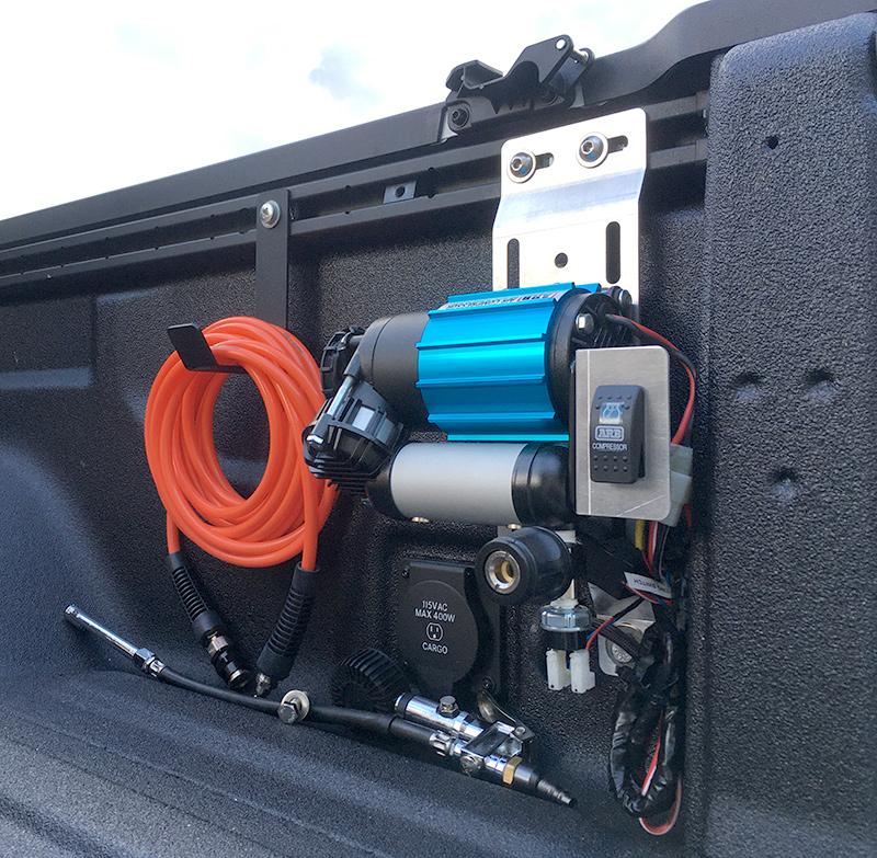

I offer a few different mounting options for the JT. I have one for the bed that mounts the single ARB compressor and one that holds the Twin ARB compressor and it also has an optional protective guard. No pics to show yet, but I also have a universal mount that works with the single or twin that mounts in the cab with a few different air chuck solutions. I am finishing prototypes within the next few days and be able to show the pre-production pieces for that one. Let me know if anyone has any questions.

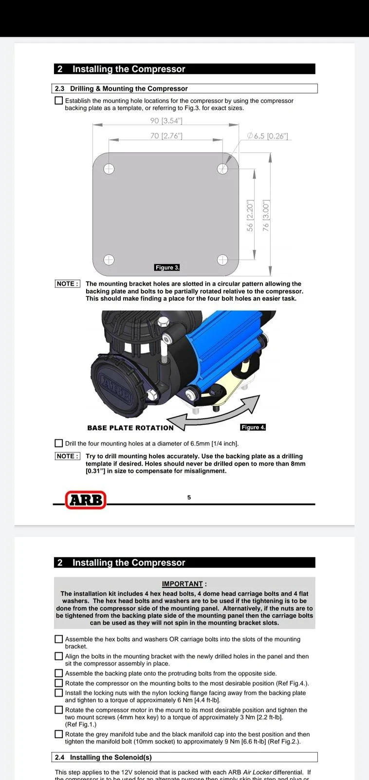

I have an older ARB CKSA12 and I wanted to make sure mine would fit your plate before I bought it so I have attached a plate diagram from the instructions. Also, I plan on using mine for airing accessories only like yourself and since my wiring harness won't reach all the way back can I ask if you just ran your own wiring and if so what gague wire?
Thanks for your help

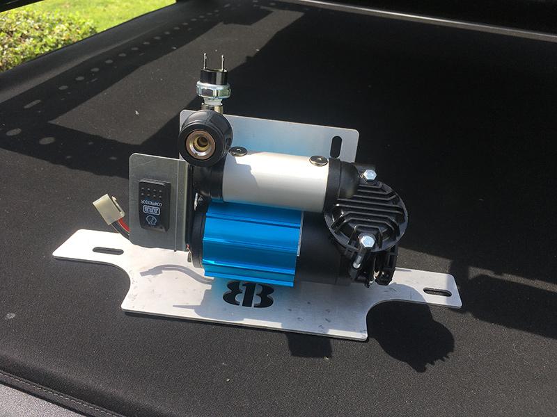

That looks like the same mounting plate for the newer single CKMA12. The Single compressor plate I have for the bed will work for that one. If using the in-cab mount for behind the rear drivers seat the one mount I have will work, it fits both the single and twin compressors.
