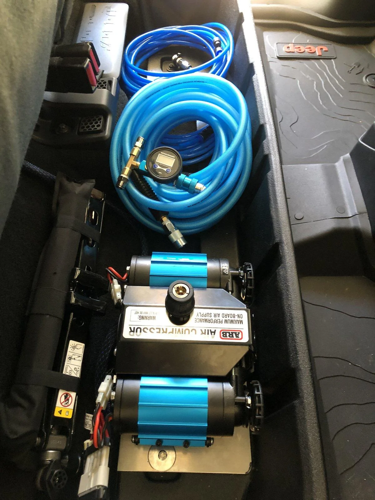

Here's what I did for those interested. I located the twin ARB compressor under the rear passenger seat. I fabricated a mounting plate from 1/8 aluminum that attaches where the two bolts holding the plastic storage bin in place go. I created an extension harness that attaches to the ARB harness and routed it along the frame rails and up through the rear seat drain grommet. The purple ARB trigger wire is connected to one of the Aux switches I installed last weekend. Lastly I assembled a 4 tire air up/down system similar to those available commercially.
