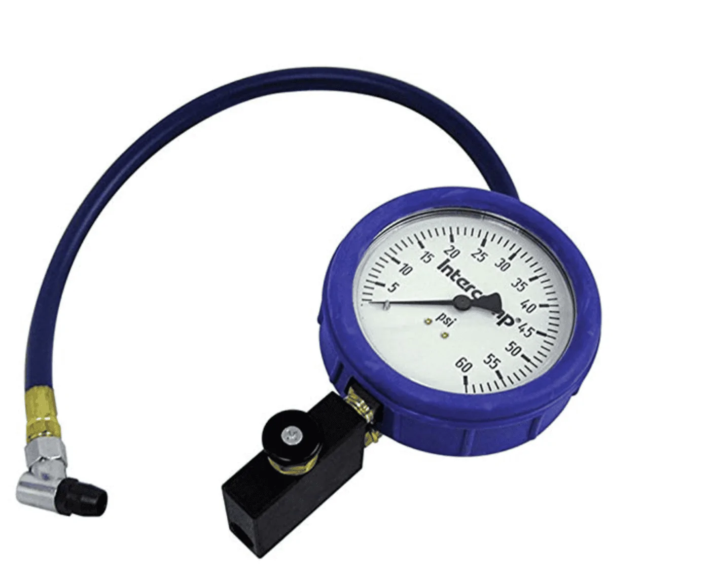

I went with this for a gauge/inflator...
https://www.quadratec.com/products/...MI-rrbh5PK5QIVUfDACh3JiwBHEAQYASABEgKrVPD_BwE
It's solid built, has a deflator button on the side which bleeds pressure off real gentle like. Gauge was consistent and matched my TPMS readings within a pound (gauge was lower than truck computer). Next time I fiddle with it I'll just know to match that.

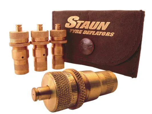

I deflate with these they work great
Ah that's cool, adjustable to the pressure you want, screw on and let them do their thing. Probably by the time you walk around screwing them on they'd be done and you can walk around and take them off. Pretty fast and neat.
Yes they are fairly quick, but super easy.

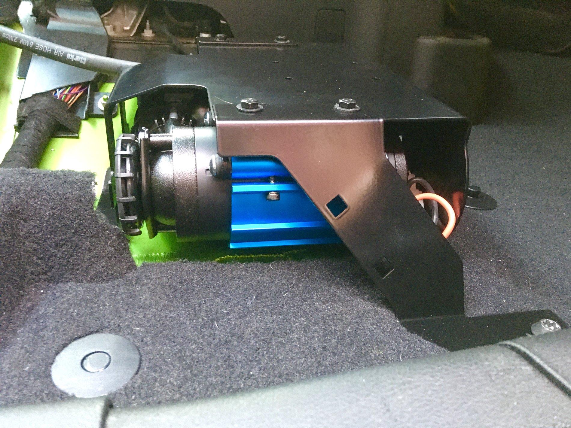

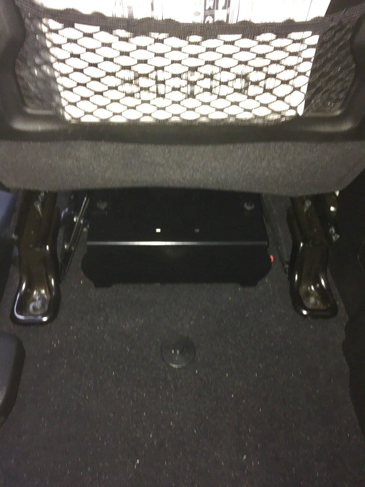

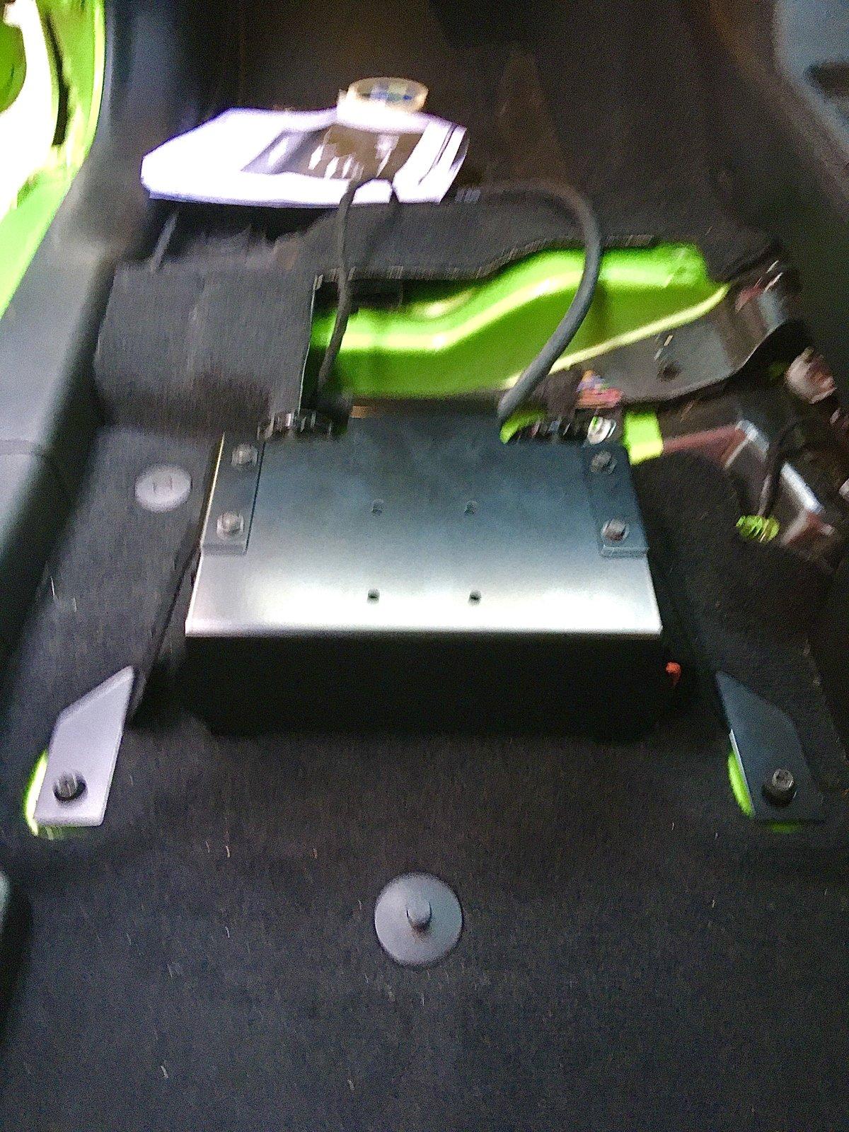

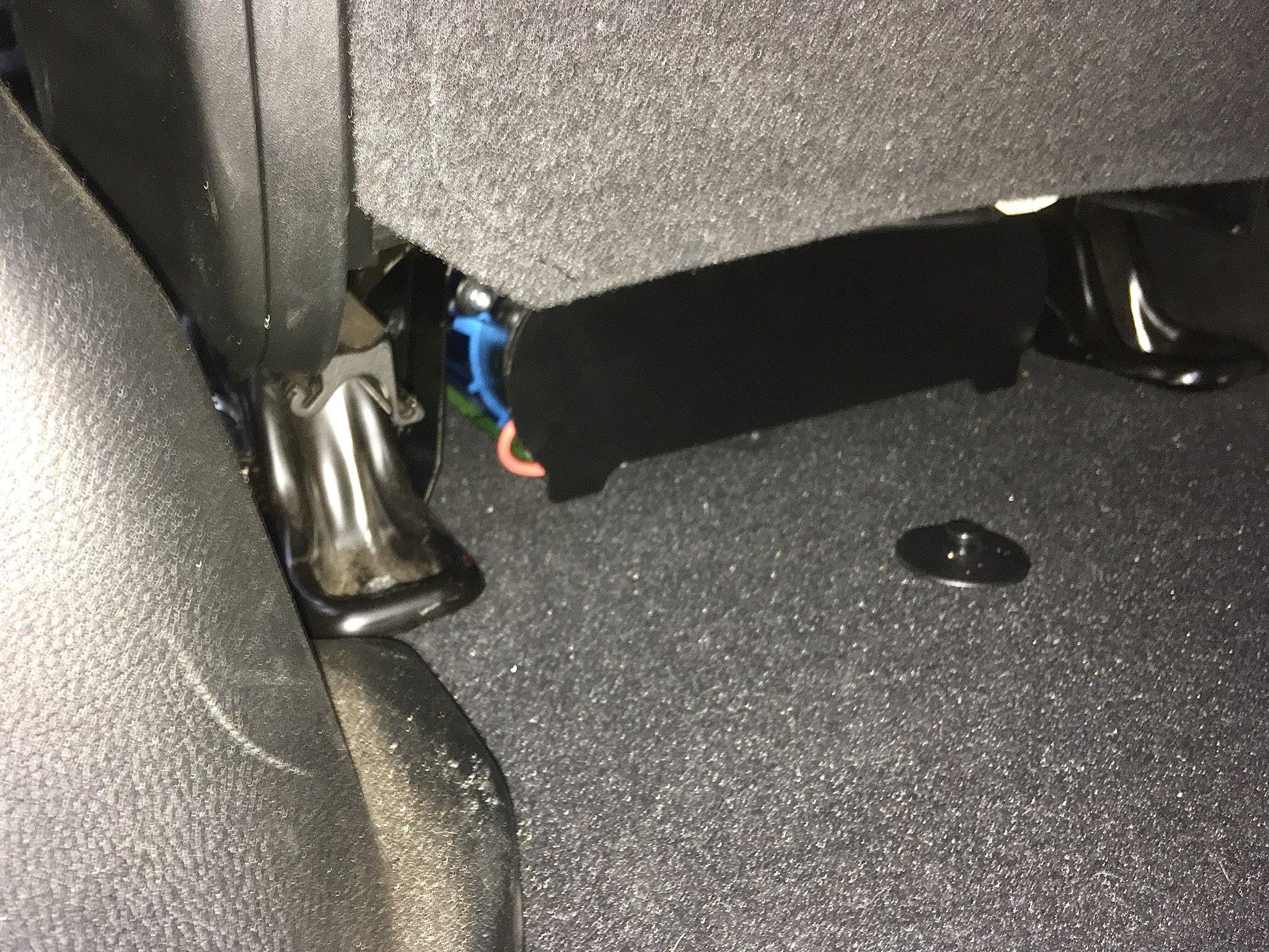

ARB has their own bracket out now. Further under the seat and has a guard for kicks. I'll be getting this setup.
Found on sister forum
Jeep Gladiator On Board Air... 2BD408DB-0B90-43F8-94B2-7EB3A61B0DA7

hawkijon

:like:... What is your method of filling..one hose for all tires?
I'm gonna run a line to each side seat with a closed end airchuck under each.
They'll be accessible from under the seat. IE not sticking out the side. Then I'll have 2 hoses made with a lead and T fitting then long enough to reach the tires. I'll also carry my 30ft hose for when air is needed past that.
That sounds great! give us a few pics when your system is complete!
