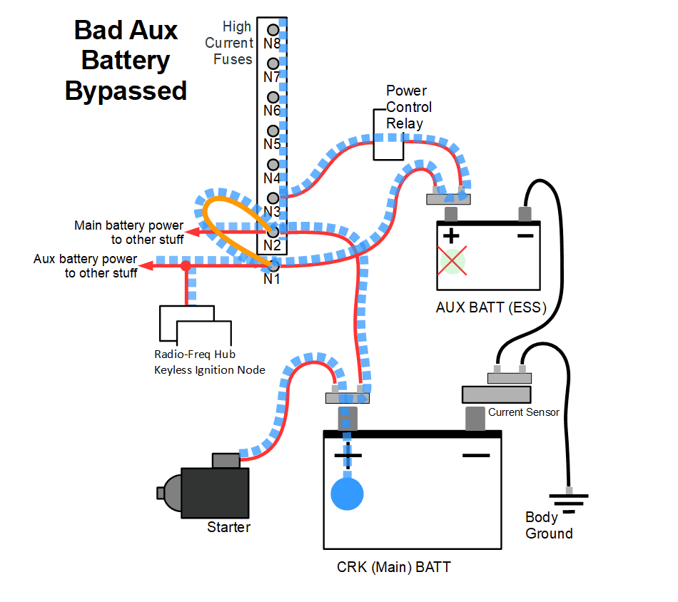

If you have a bad aux battery and can't locate a replacement, you can leave it's ground cable disconnected and run without it, you'll just have the ESS error light on. If you unplug fuse f42, the error light won't turn on.

Soak it in. There are a number of ways to roast this turkey!
So if you did this jumper wire trick to bypass a bad aux. battery, would it be best to disconnect the ground for the aux. at the current sensor?
jebiruph
Jerry
Dec 9, 2018
806
730
IA
2018 Wrangler JL 2024 Grand Cherokee L WL 2020 Gladiator JT
If you have a bad aux battery, you can leave it's ground cable disconnected and run without it, you'll just have the ESS error light on. Using the jumper will prevent the error light from turning on, the same as unplugging fuse f42.
OK, Thanks.

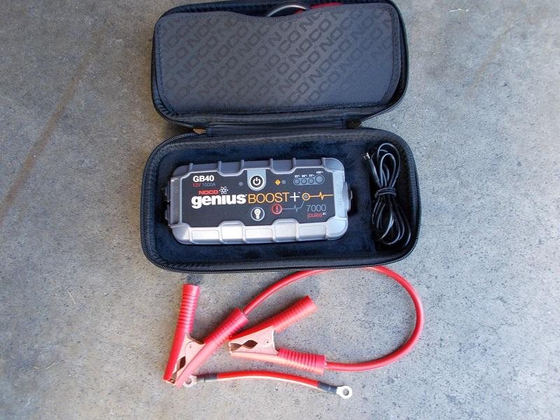

Am fabricating some flexible 8 ga. silicone insulated jumper wires to add to my NOCO GB40 Boost+ jump box kit to have all my bases covered "just in case".
