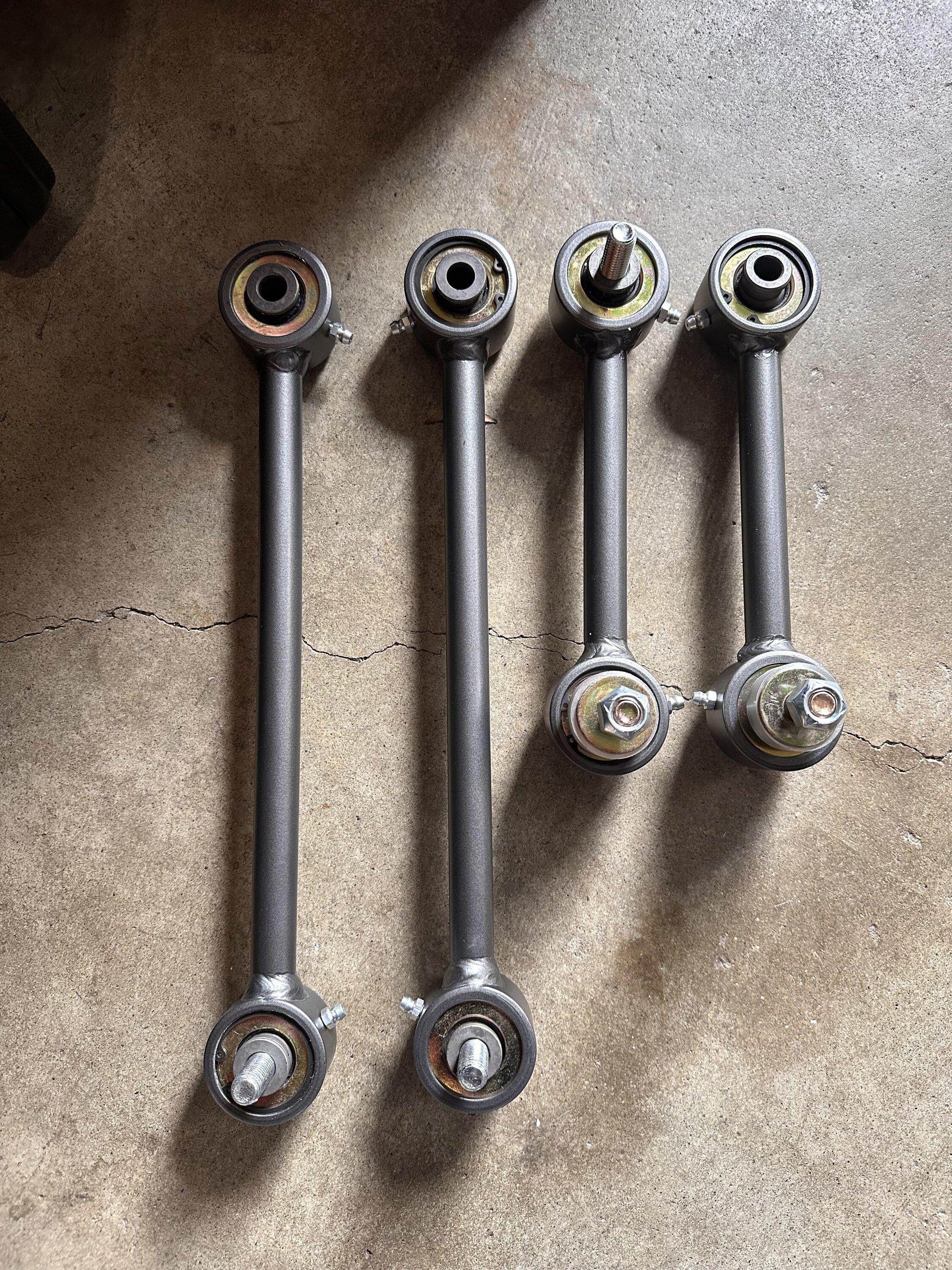

Happy with my Core 4x4 stuff so far. Seems like great quality, and overall the fitment has been perfect or close to perfect. I went with their T4 complete set (steering, front/rear track bars, front/rear UCA/LCA). I installed everything except the control arms (need help with those). Only issue I ran into was the adjustment nut on the pitman end of the drag link hits the brace that the joint mounts to because my lift isn't enough to require the ball joint to be extended out very far. And on the axel side of the track bar, the joint is a bit too large (wide) and isn't able to clear the hole that already exists in the brace, so per their advice I had to open up the hole a little with a grinder.
In any case, because of the results so far and their recent sale, I got their (new?) T4 front/rear end links to finish it all off.
Speak of the devil…
Jeep Gladiator Opinions on control arms...Metalcloak - Clayton - Rusty's 2E4DD4A4-6261-44EE-82F7-4EAE4EE02321
edit: Seems like I got some wrong hardware or there was a design change. There are 8 bolts and nuts, but the rear top bolts go into a fixed factory nut, not one that you torque down. Unfortunately the factory bolt is too short and the provided bolt is a different thread pitch.

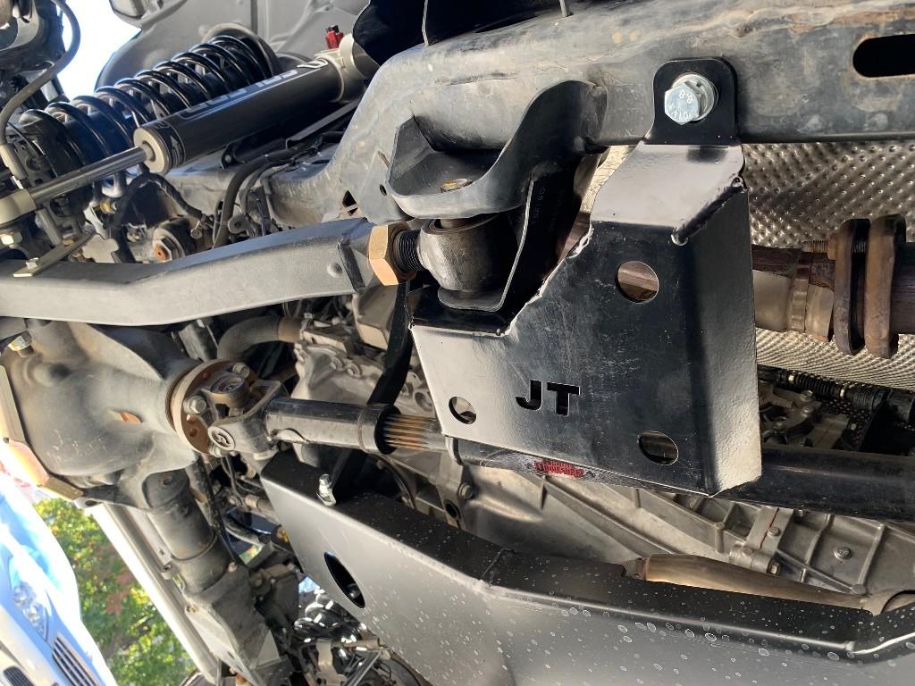

Clayton front lower control arm with brake extension bracket. Note: That arm and those skids have been scraped up now and painted. The arms do not dent at all. This pic is old.

I'm running that same bracket. It's a nice set up.
