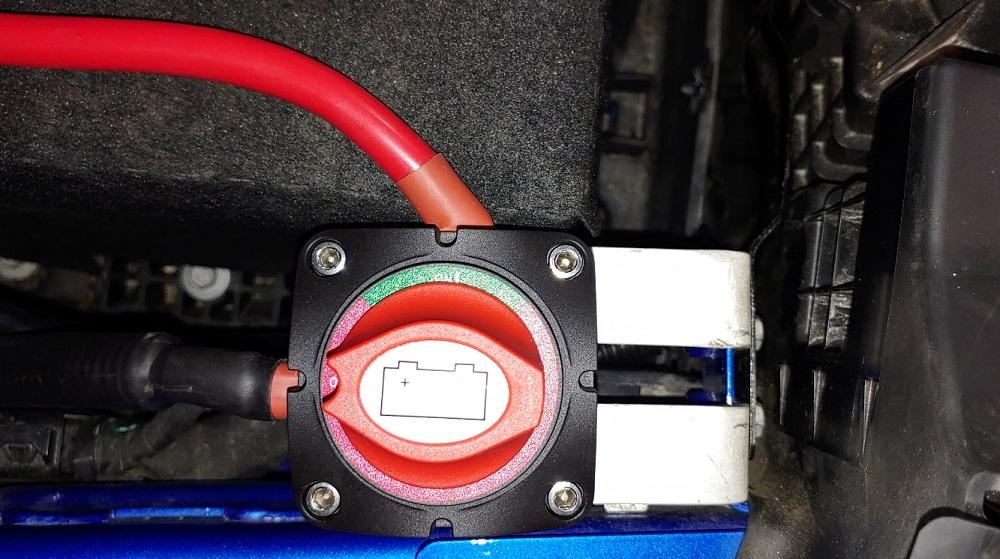

I've been using a manual disconnect but there's times getting the hood open and to it - sometimes it's really slippery or not so easy, so my next version will be switched electrically like show in the pics in the other posts.
Jeep Gladiator Overland catches fire for no reason 20201017_135923_HDR
It's off unless I'm using it...........

Yeah, there's a couple really really long discussions on making sure the front end isn't hot in case of accident. And then when someone posts a vehicle fire, it gets talked about again.
Switches, solenoids, disconnects, whatever.
Basically, don't leave a 6 gauge or better wire from the battery to the front bumper hot while driving.
