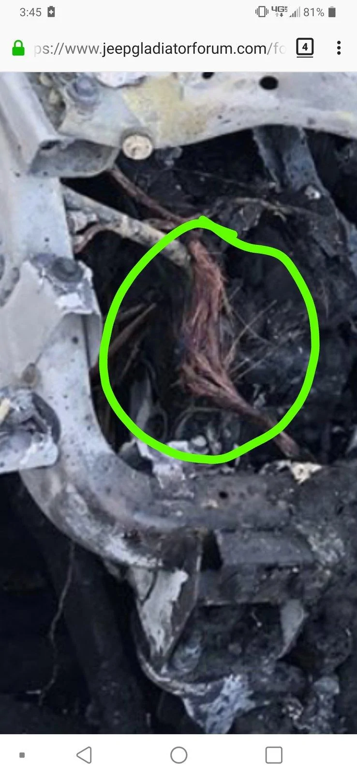

I’m no fire expert but it looks like it was awful hot around the electric power steering pump. Looks like it was behind the winch unless the winch wiring rubbed through on something under the hood. Man, that aluminum really melted!!! Either way, what a bitch.

That is the ground cable for the winch, it is routed over the top of the steel support for the breather box. The positive cable is gone, as is the battery. I'll guarantee you the insurance company is going to give him some shit.
So can someone explain this a bit to me. I'm thinking of putting a new bumper winch combo on and don't want to make this mistake.
Your positive cable will (unless routed through a relay) run directly to the positive pole of the battery.
If the cable shielding is damaged during installation, or subsequent to installation, this can/will provide a direct ground from the battery effectively turning your battery into a single use welding machine, which can/will result in what you see in that picture.
The positive cable should be run carefully to avoid any cuts or pinches during or after installation. Any decent manufacturer will provide additional sheathing with the positive cable in the form of a rubberized fiberglass sheath. I like to run that through plastic split loom with heat shrink at both ends and enough rings of electrical tape to keep the loom closed particularly in bends.
Routing the cable carefully, securing the cable with zip ties, adding armor to the cable and being conscious of how it crosses metal will ensure success.
Relay or no relay is another subject with two clearly divided fields of thought, but regardless a relay once the cable is energized it it is allowed to go to chassis ground you are going to have a very bad day.

I am going to say after reviewing the pictures, that this was an improperly installed winch. To an earlier question, circuit breakers are a better solution than a fuse (which is better than nothing) on a circuit powering an electric motor, but need to be installed as close to the power source (battery in this case) as possible to protect as much of the wiring as possible. I disagree that a properly installed circuit breaker would not have prevented this disaster. While there would have been damage, it would have been recoverable. This is not recoverable and was clearly allowed to burn for sometime prior to being extinguished. The other problem here is that without some method (CB, fuse, manual cutoff switch) at the battery to deenergize the circuit, it would continue to arc weld the chassis and burn critical systems even when the ignition was turned off. Even a handy fire extinguisher would do nothing to curtain the devastation.
Let this be a lesson to those installing high current equipment to ensure a proper and safe installation. I’ve been working on electrical and electronic systems for over 40 years and I’ve seen some real bonehead installations. Adding lights is one thing, adding a winch is major league work.

Winch pulls 400-500amps, meaning the breaker or fuse will be in excess of that.
Everything in that vehicle will be toast before the breaker trips or fuse blows. There isn't a piece of metal anywhere in that body, chassis that won't go to smoke at 400 amps.
Seems prudent for sure, but reality is exactly what you see in the pictures posted, with or without a breaker/fuse if a poor installation allows energized tab A to insert into ground receptacle B.

Semantics, what part of that body/fender engine bay do you think is going to sustain 200amps without catching on fire?
The answer is none of it.
It's a complete waste of time, but if it makes you feel better by all means install one.
ETA: a disconnect relay and a fuse or breaker are obviously not the same thing. If you want to be certain, just unhook the positive cable.
