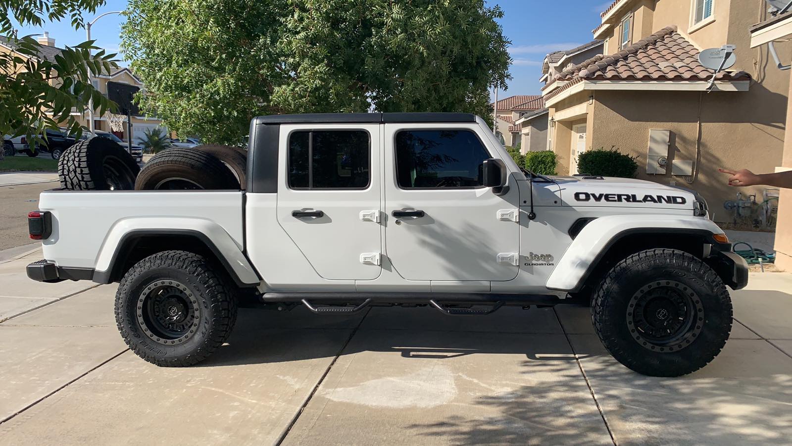

On my Overland setup, I put 35x12.5x18 Toyo Open Country AT2 with no lift. I originally wanted to get MTs but since I am mostly street driving with occasional offroading, I decided to get the AT2. The tire is pretty aggressive looking and has minimal road noise. Still contemplating on a lift but am satisfied with the overall look and function. It does rub a little on tight turns but not much of an issue.
Looks awesome! So this is without a lift? Also, how do you like the hardshell? Would you recommend?
No lift at the moment, but will be getting a 3" lift as soon as I get the steering TSB done. I like my hard top but it starting to get cold in southern California and I might invest in an insulating headliner for the hard top.

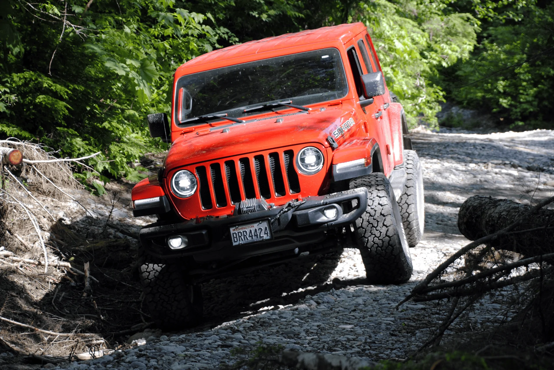

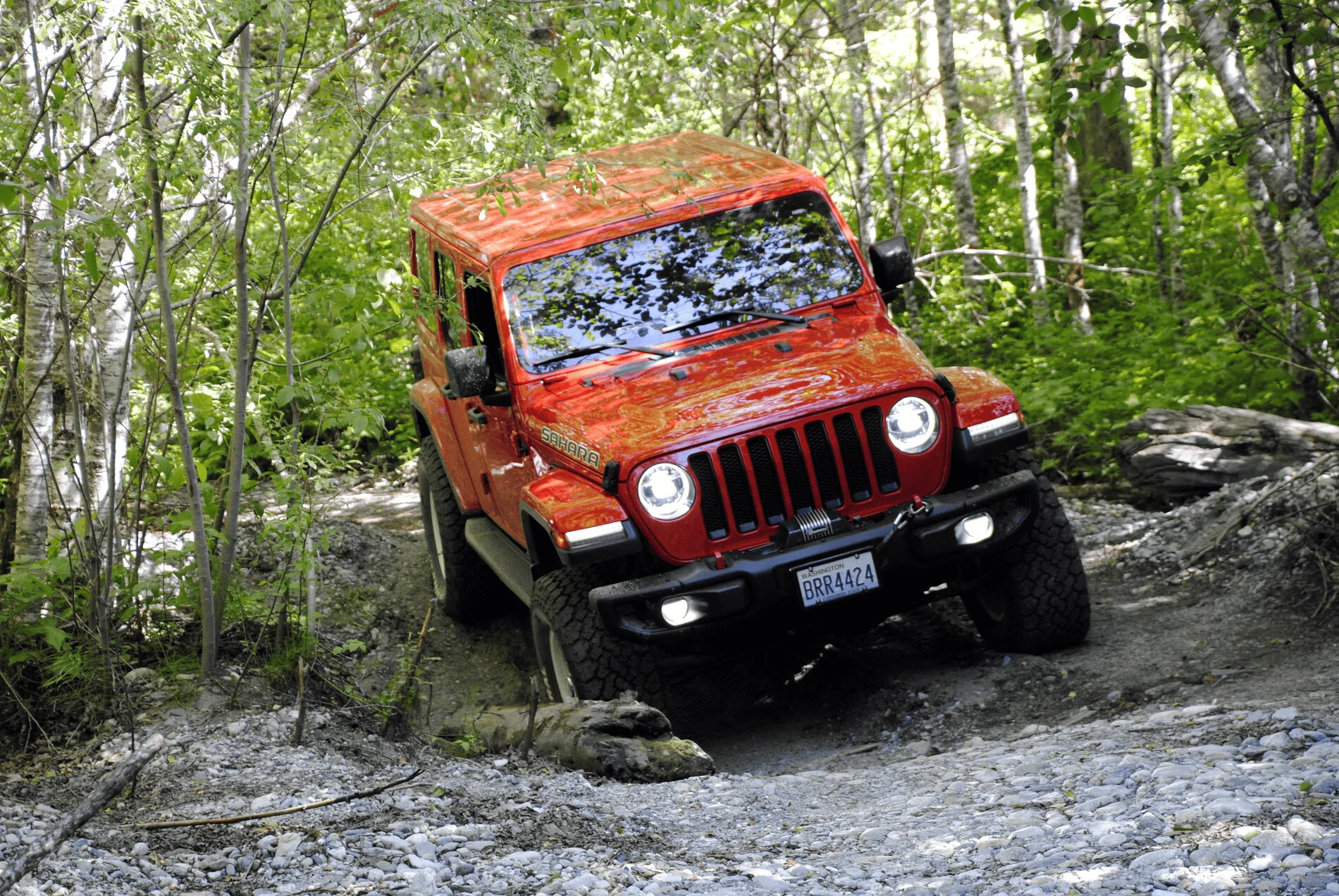

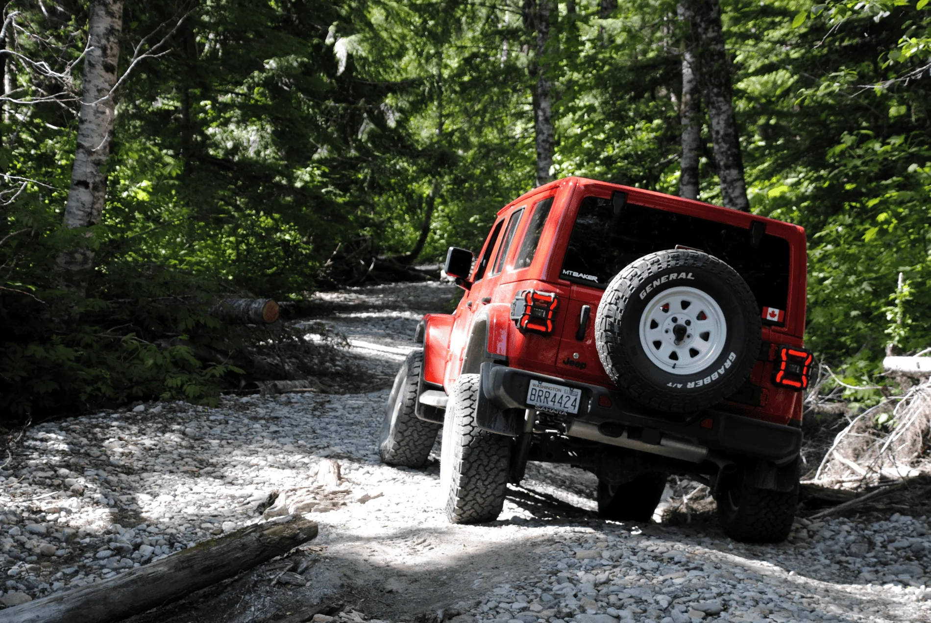

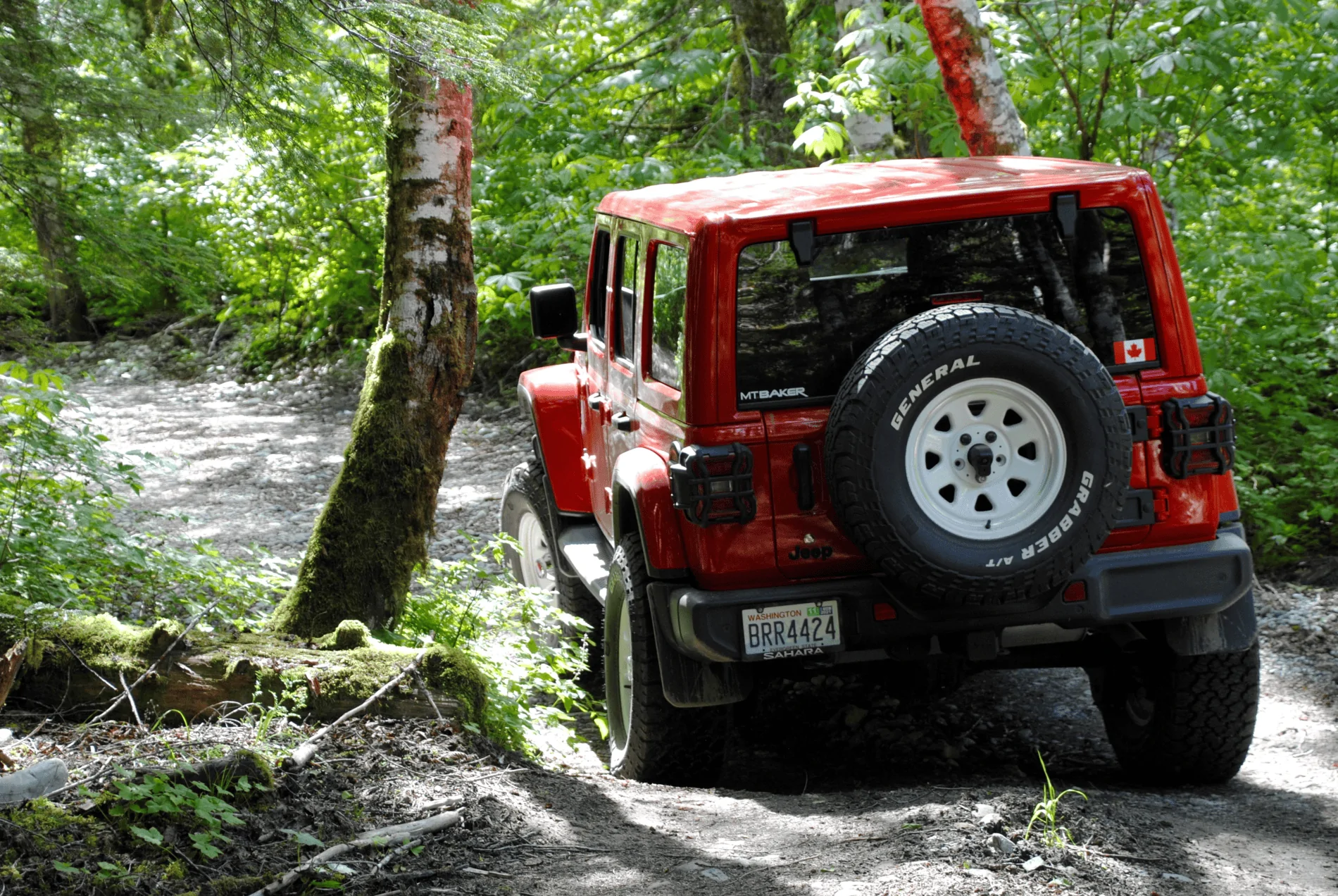

Six months ago I got a Mopar lift and 35-inch Generals on my JL Sahara. I finally got a chance to try it out on a moderate trail last weekend: I am very impressed.
This Mopar lift is a LOT better than that offered on JKs. I was able to sustain 30 MPH on rutted logging roads very comfortably, which I was never able to do with my JKs. And the ability to go over medium sized rocks and logs rivals that of my lifted 2018 JKUR Recon.
The Mopar 2-inch lift netted me 3+ inches in lift. It is well worth the money IMO.
