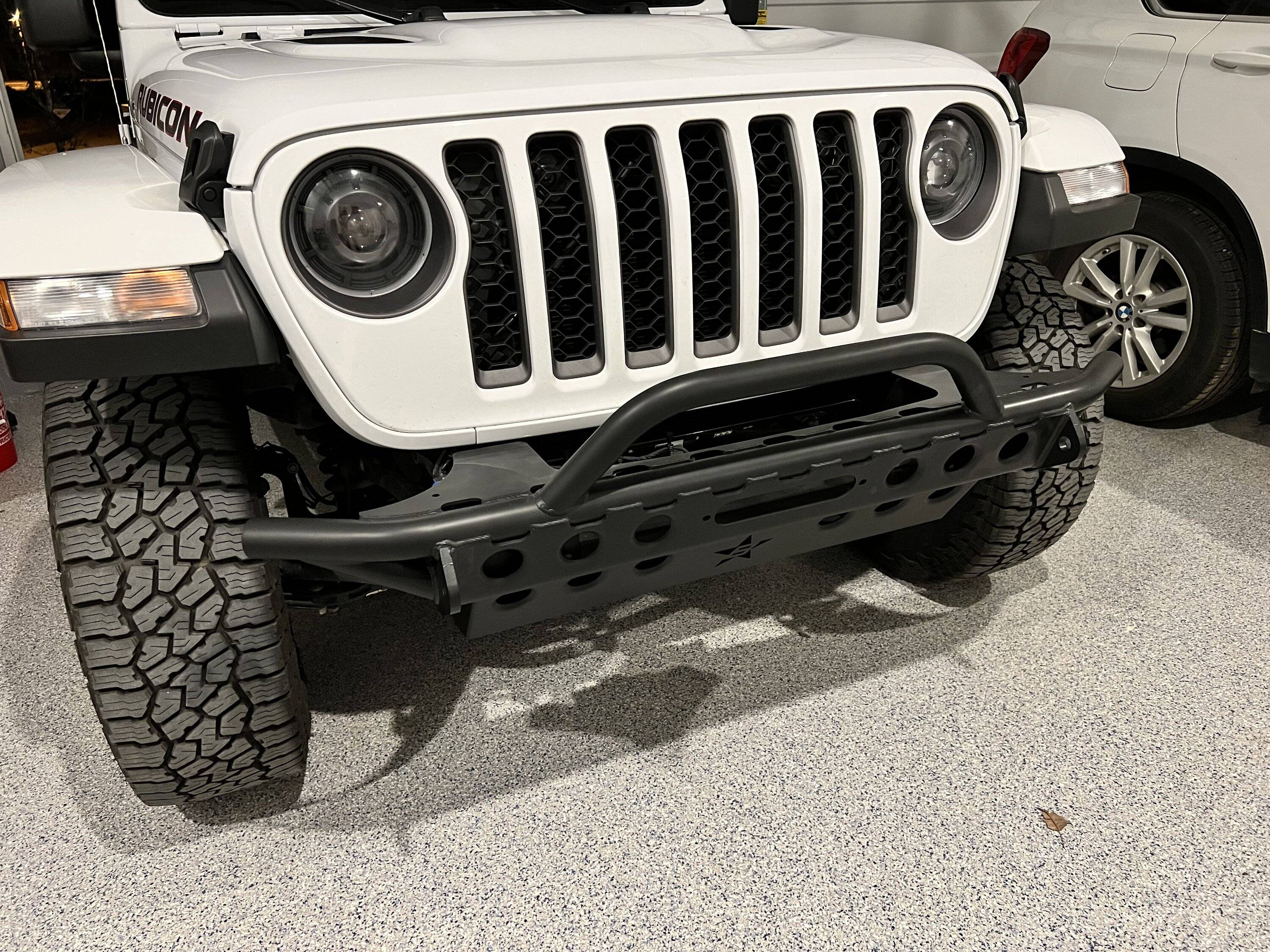

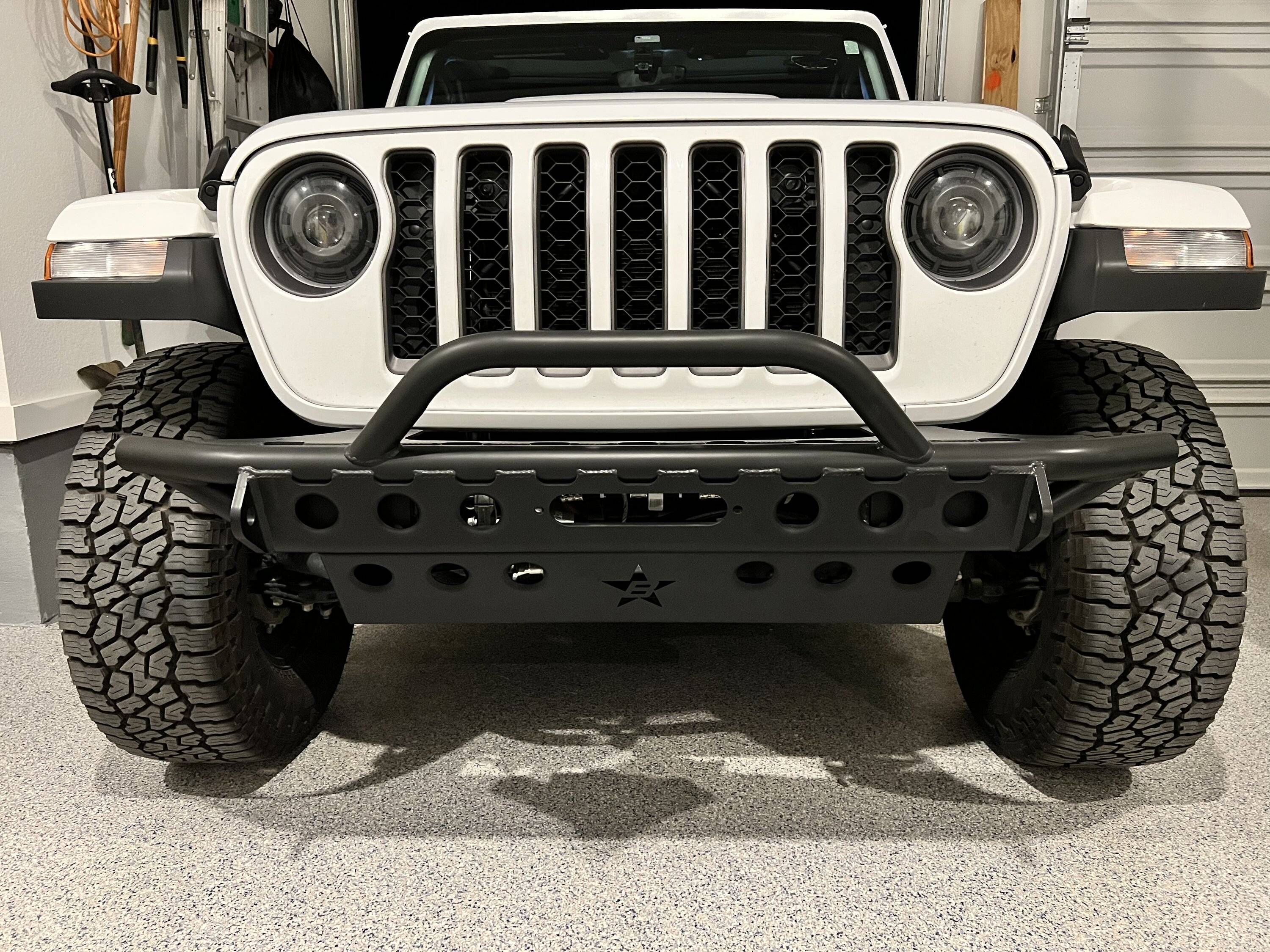

Just dropped it off with a local powder coating company. Price came in at $300 (including soda prep); a little on the higher side for my area - but the company does great work. I’ll post pictures when it’s done.
jbehrn
jbehrn
JP
Oct 12, 2020
70
599
585
Montgomery
2022 Jeep Gladiator Rubicon
Got it back yesterday and installed it this evening. The powder coating is great, the color matches the black trim pretty well, and it came out much better than I would have done with cans of paint. Overall I’m pretty happy with coating.
I think you chose well going with the powder coat, looks good.
