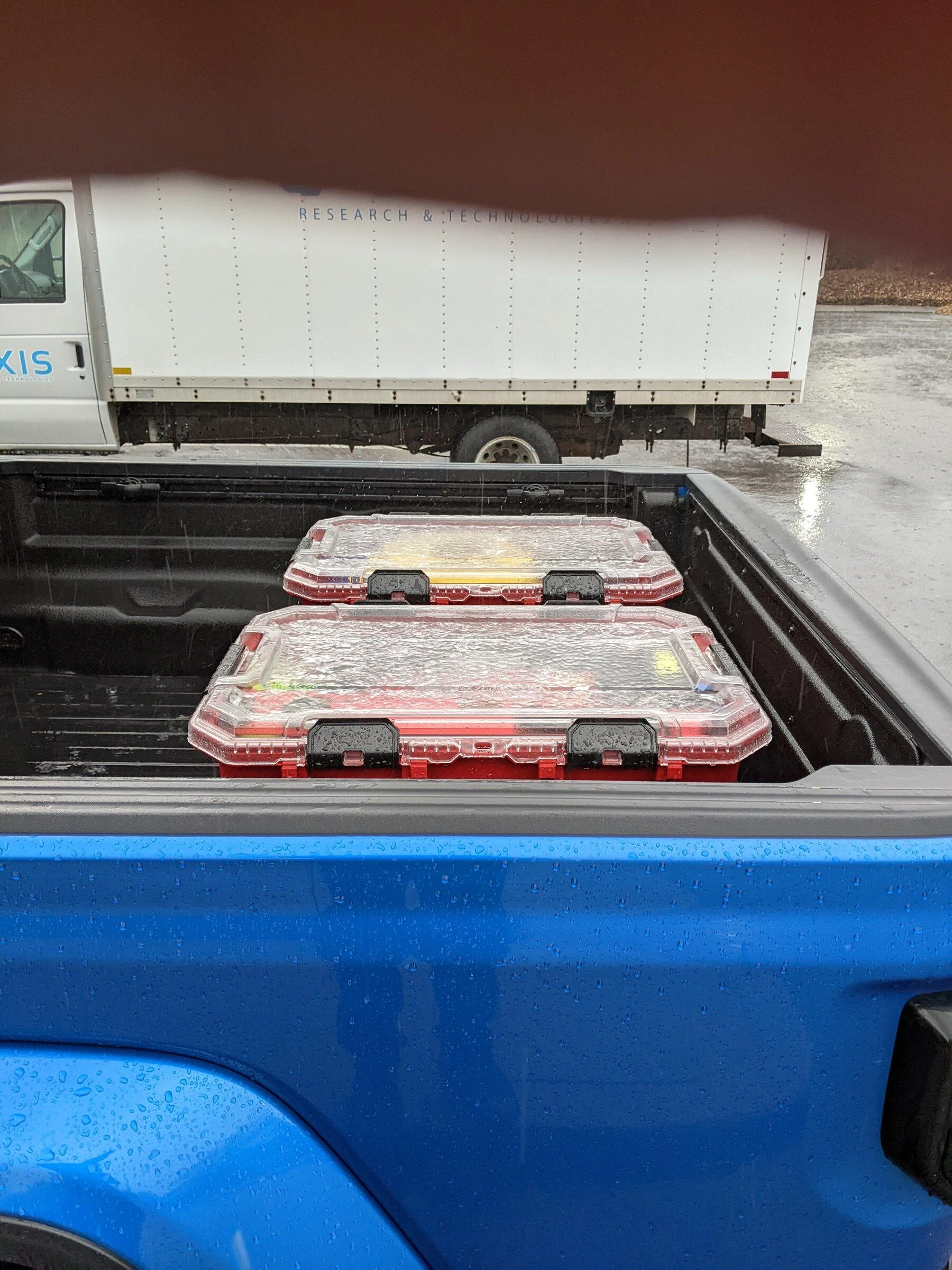

Nothing gets in these things for 30 bucks they can't be beat. It's absolutely dumping rain here in TN so I figured I'd show them off.
I just bought 4 of these for our trip out west.

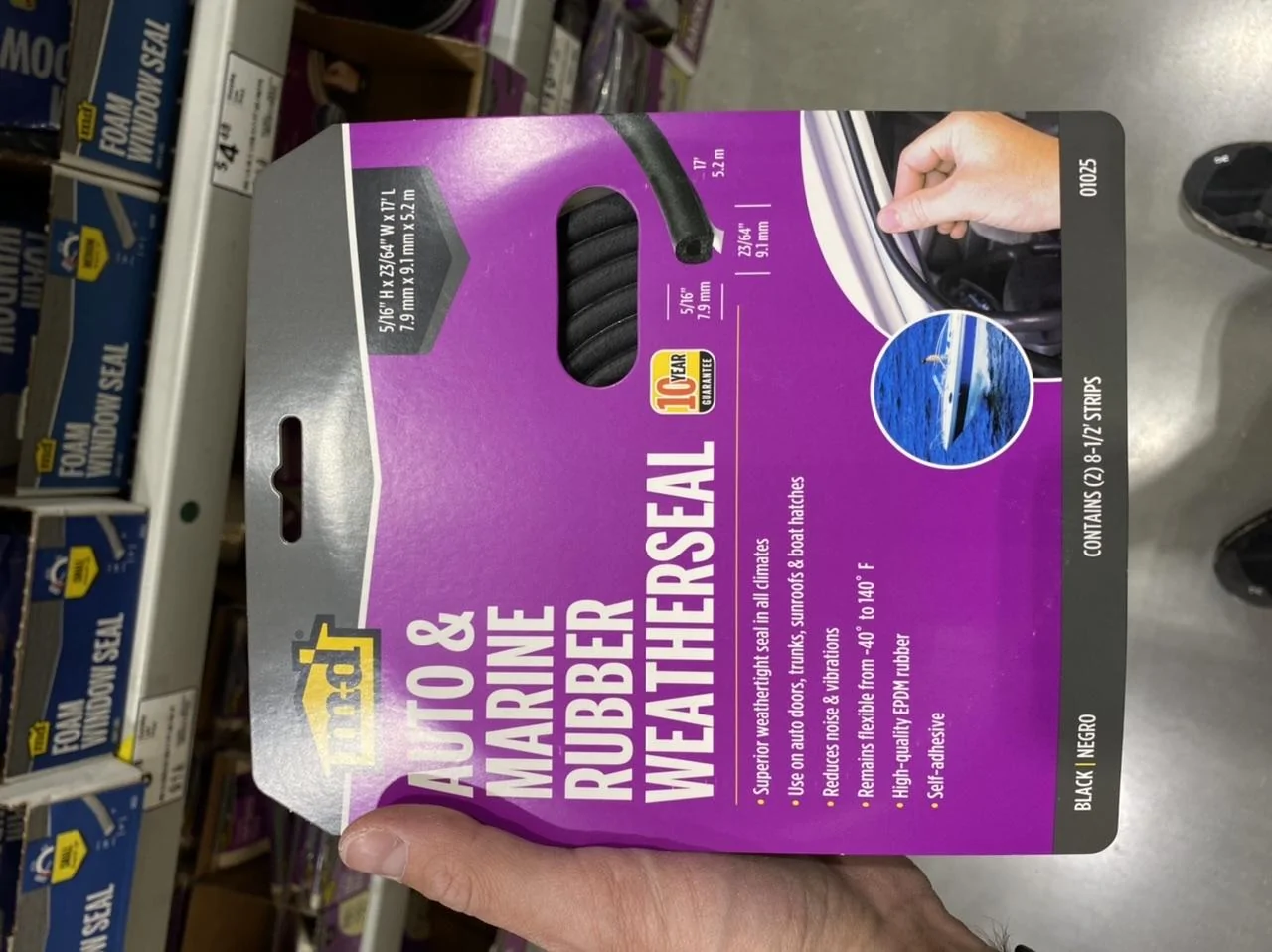

What width bulb seal did you use?
Looks like 1/4” wide bulb seal will fit in the groove but I can’t find anything less than 1/2 inch wide.
Sorry for the slow reply here! This is the stuff I used.

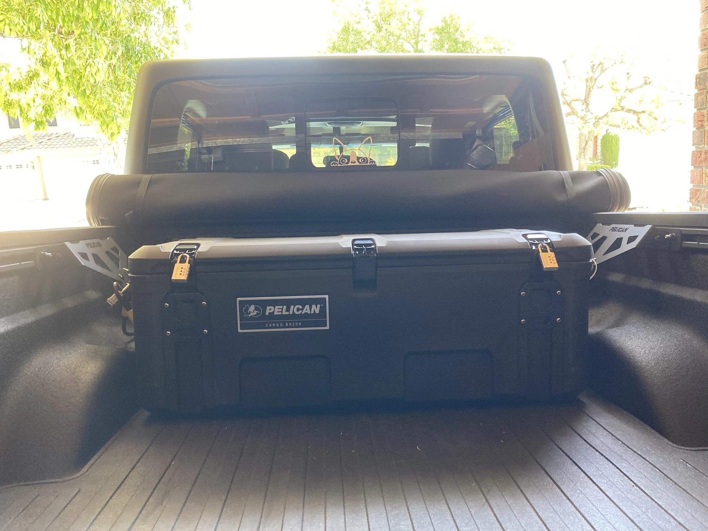

Thought I revive this thread since Pelican has the BX135 back in stock. Has anyone tried mounting the universal cross bed mount to their trail rail system yet, I have on order and was looking for any tips. Well I received and just finished installing just had to figure out the rail mount

I used Pelican BX135 and their universal mount so I could still use my soft tonneau and with slight modification to the mount kit my trail rail system

how did you have to modify?
I used the universal cross bed mount and instead of using the piece that is used to clamp under the bed rail I just bought stainless washers and ground off enough on one side so it would fit the slot and also bought 10 mm by 1 1/2 bolts to fit in the washers. Then used the mount as designed it was a little tough getting a wrench into the rail to hold the bolt and could have used t slot nuts from Amazon but wanted to make it as hard as possible for someone to try and remove in a hurry

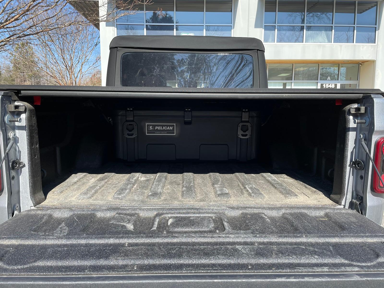

I have the Mopar soft rolling tonneau. One of my criteria was that the storage had to fit under that. Out of sight, out of mind.

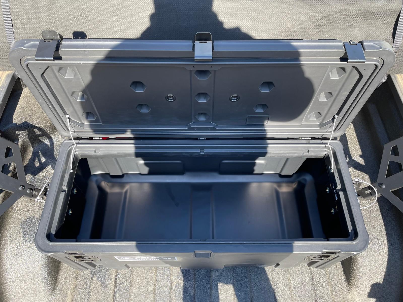

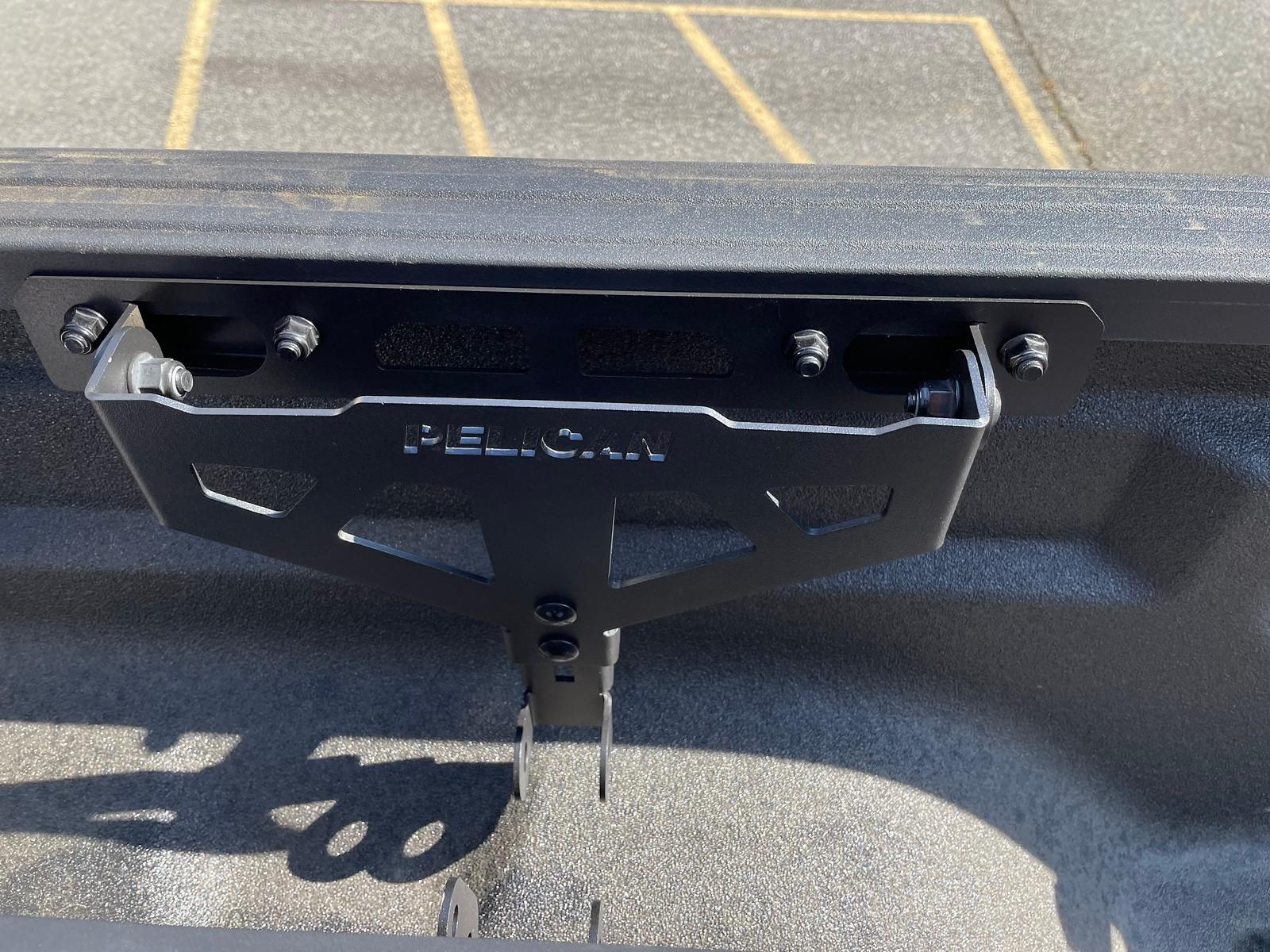

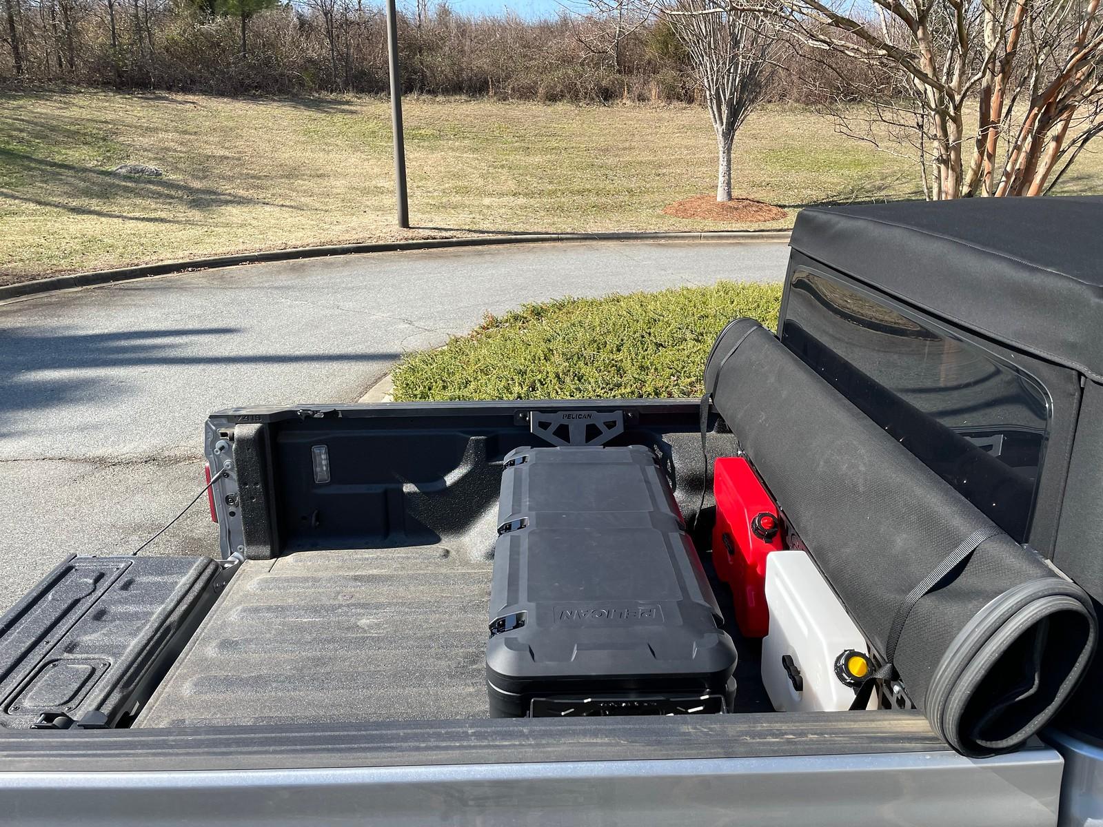

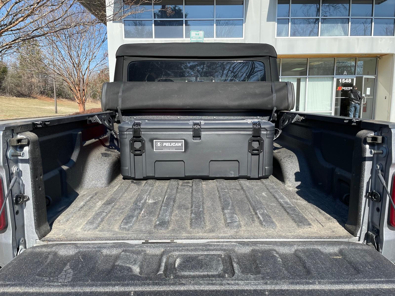

I've seen this mentioned a time or two on here but I don't think anyone has pulled the trigger on one. So I did. :CWL:
I was looking for storage for my recovery gear and other odd items. I wanted:
  • Secure/lockable so I could leave everything in the truck so it would always be available.
  • Easily removable in case I actually have to do truck stuff with my truck.
  • Fit under the tonneau to keep things out of sight.
  • No drilling into the truck.
  • No Rube Goldberg-esque solutions. (That's cool if that's your thing. It isn't mine)
This case ticks all the boxes.

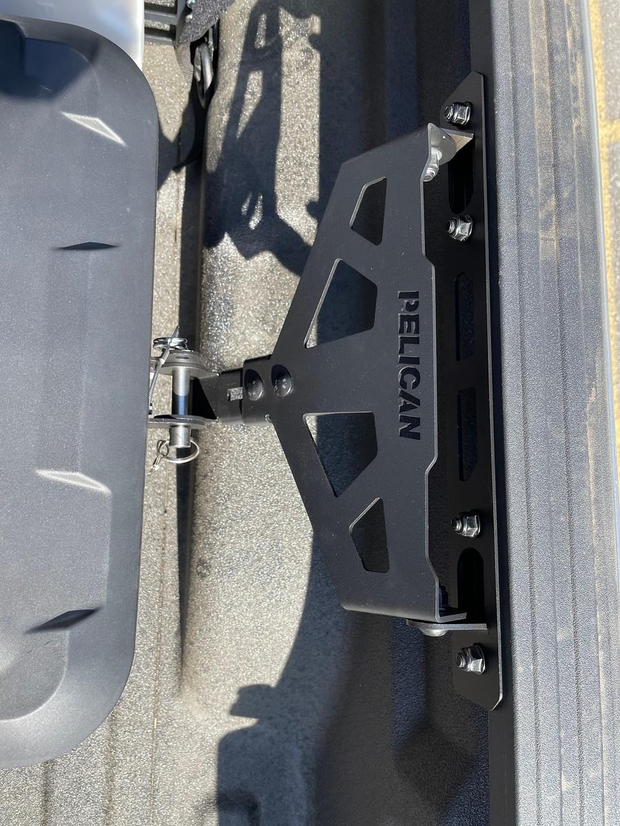

I have it positioned between the wheel wells now so I can put my suitcase and work toolbox in the back. When I wheel, I can loosen 8 bolts and slide the whole thing to the back for easier access to the stuff.
To remove it, just pull the clevis pins and away you go. The mounts stay in the bed and are stiff enough they won't rattle or bang around.
These can be mounted sideways or on top of something if you want with different mounting kits.
Lid latches lock and the clevis pins lock as well.
The only downside I see, other than a price higher than giraffe pussy, is there aren't any divider options. I'll load things up tonight or tomorrow and see if I need to suss something out there.
I managed to get 30% off on Black Friday so that made it a little easier to swallow.
looks pretty rugged, so you had to drill the side rails to attach those swing away hold downs i assume...

Nope. They clamp on. No drilling.
