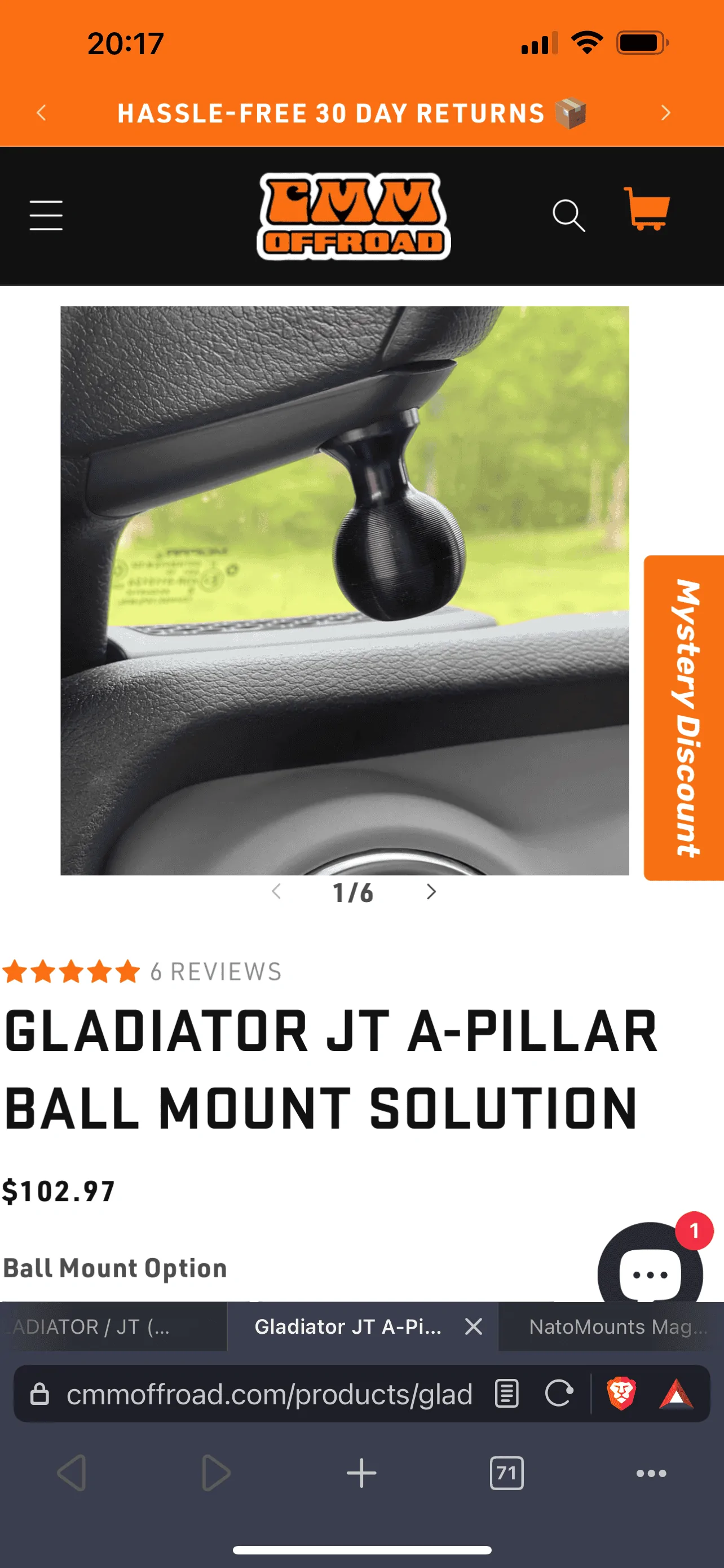

Does anyone have any idea what the difference is between the CMM A pillar ball mount for $21 and the A-pillar ball mount solution for $102? Very confusing looking at the web site.
My first thought was $81 but that was too easy so I went to their site and the price is based on the hardware supplied in each package.
https://cmmoffroad.com/products/jl-jt-20mm-ball-for-a-pillar-base-each
JL 1" Ball for A-Pillar Base Each
https://cmmoffroad.com/products/gladiator-jt-a-pillar-ball-mount-solution?variant=43640913756375
(1) 1” or 20mm ball mount
(1) 3D machined base (Custom Colors Available Click Here to Inquire)
All Hardware

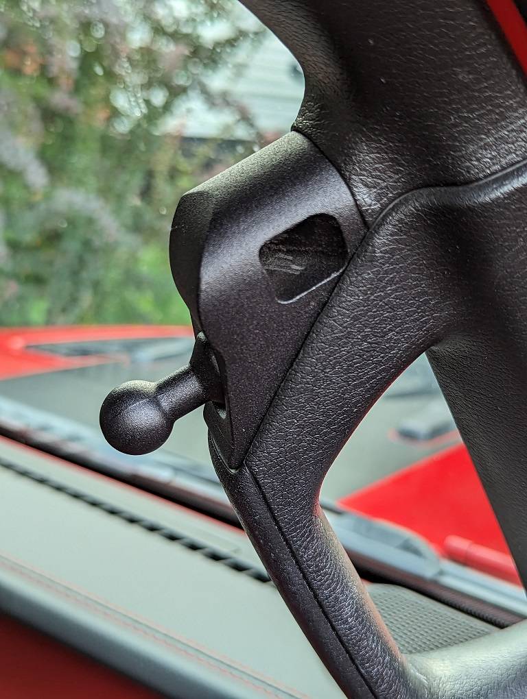

While I can appreciate someone liking a manufacturer, why would I do that? Different manufacturer.. different design.
Keyed mount point for the mirror post (so no pivoting/twisting of the mirror mount shaft) multiple adjustment points, sticks outward (providing more angles for mounting), textured to partially match the interior.
Jeep Gladiator Phone Solutions PXL_20231001_225725920
The only similarities I see are the fact that they both use the existing handles' bolt holes... which is something my grandfather and his WWII buddies were doing to their farm and rural rigs long before I came along.

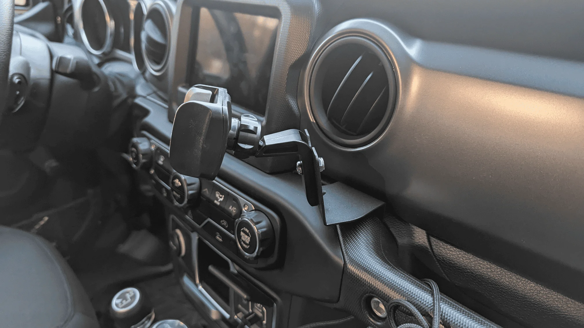

On my last truck I had it to the immediate right of the steering wheel in a homemade mount, but I didn't want to block the JT's air vent. The combo phone mount / cupholder posted above was in an OK location and I liked the way it mounted behind the grab bar, but I didn't need another cupholder and wanted more adjustability. But they make another one that doesn't include a cupholder.
Jeep Gladiator Phone Solutions 1699660380187

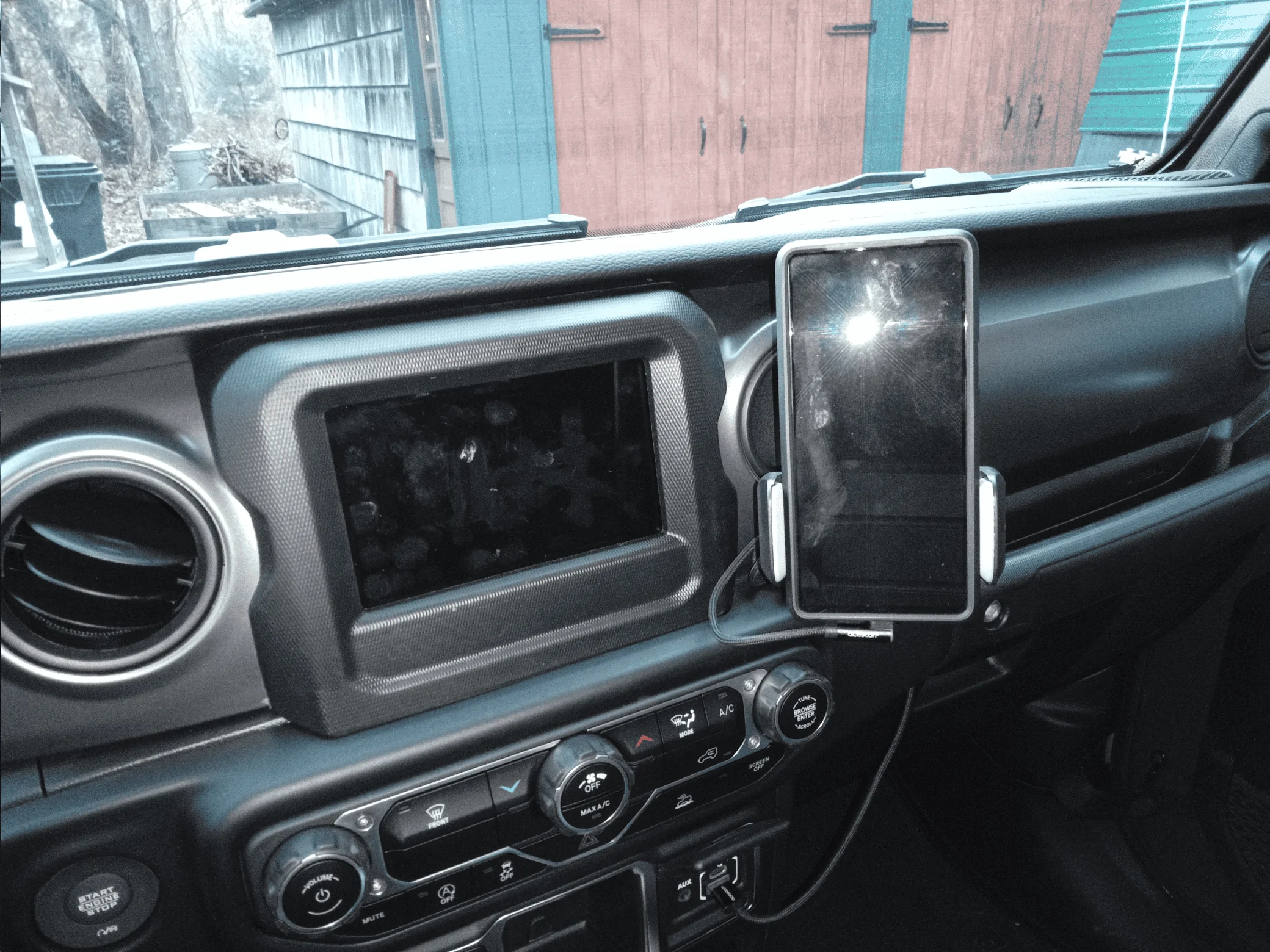

I bought that one, but the spring clamp is really stiff; it takes two hands to put the phone in it... you might do it one handed, but it takes so much force I was afraid it would break the plastic ball off. But the location was OK:
Jeep Gladiator Phone Solutions 1699659649570

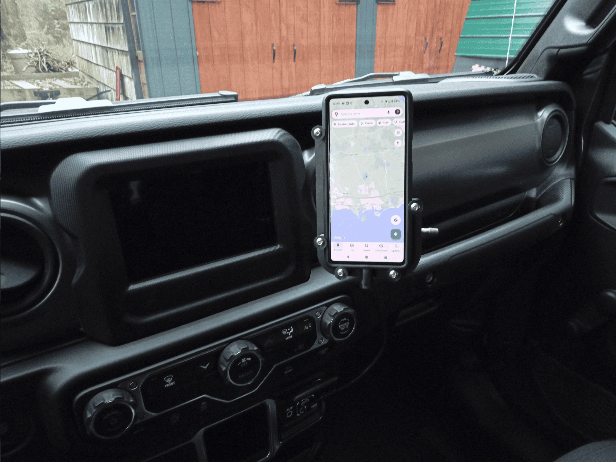

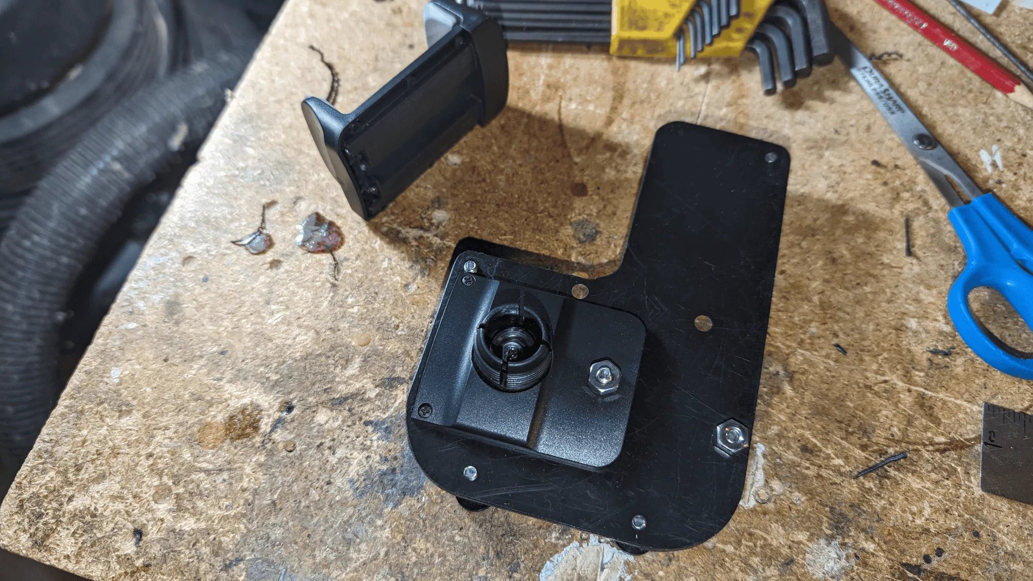

I really preferred my old mount, as I could simply drop the phone into it. Made to fit my phone and only my phone, it was made with a piece of acetal (Delrin) plastic sheet and five spools I turned on the lathe. I saved the mount from my old truck, so I removed the clamp part from the back part containing the ball socket and screwed it to my old mount.
Jeep Gladiator Phone Solutions 1699659851005
This was much better; it moves the phone a bit closer to me and exposes more of the air vent to the passenger.

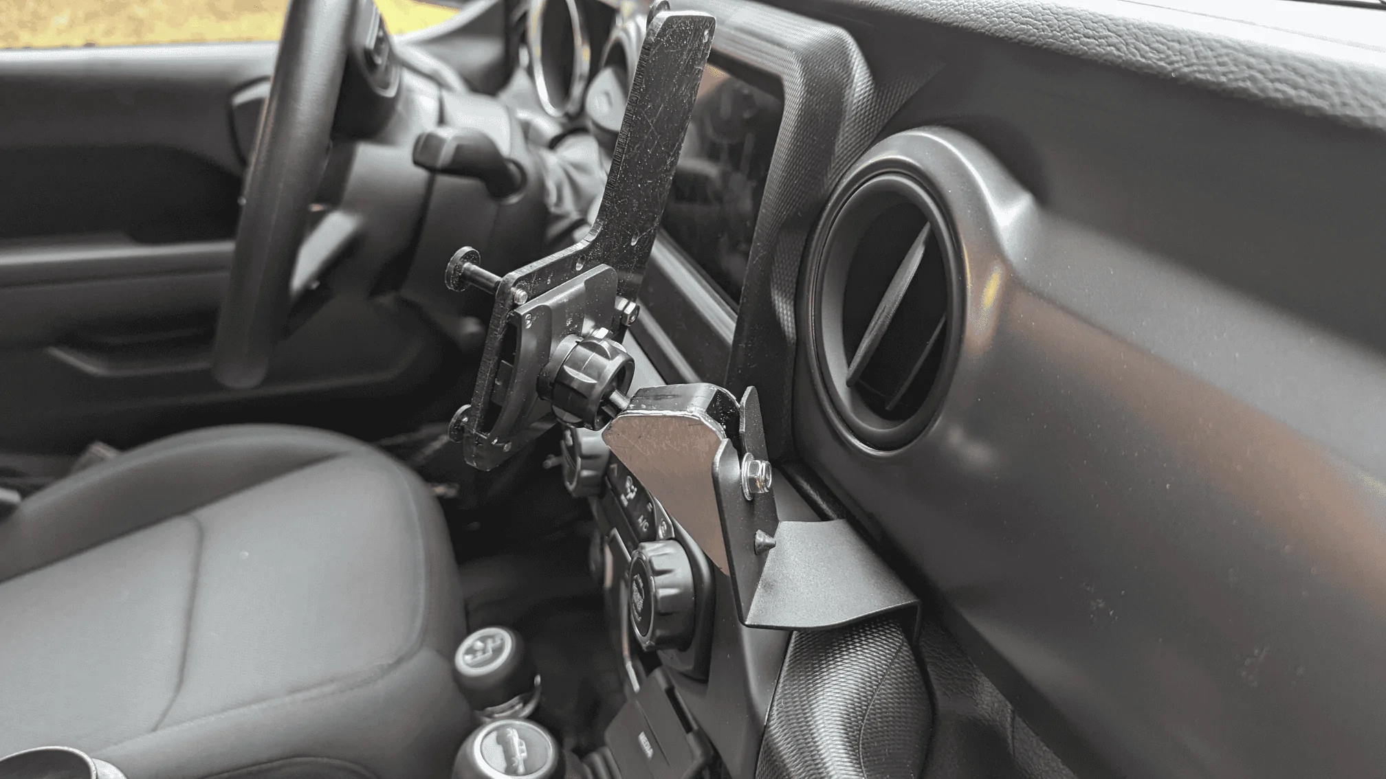

However, it shook a bit more than I liked, so I cut some reinforcing plates out of .040" stainless and epoxied them to the sides of the ball arm to stiffen it up (compare to the picture of the unmodified mount above). Now it shakes a lot less:

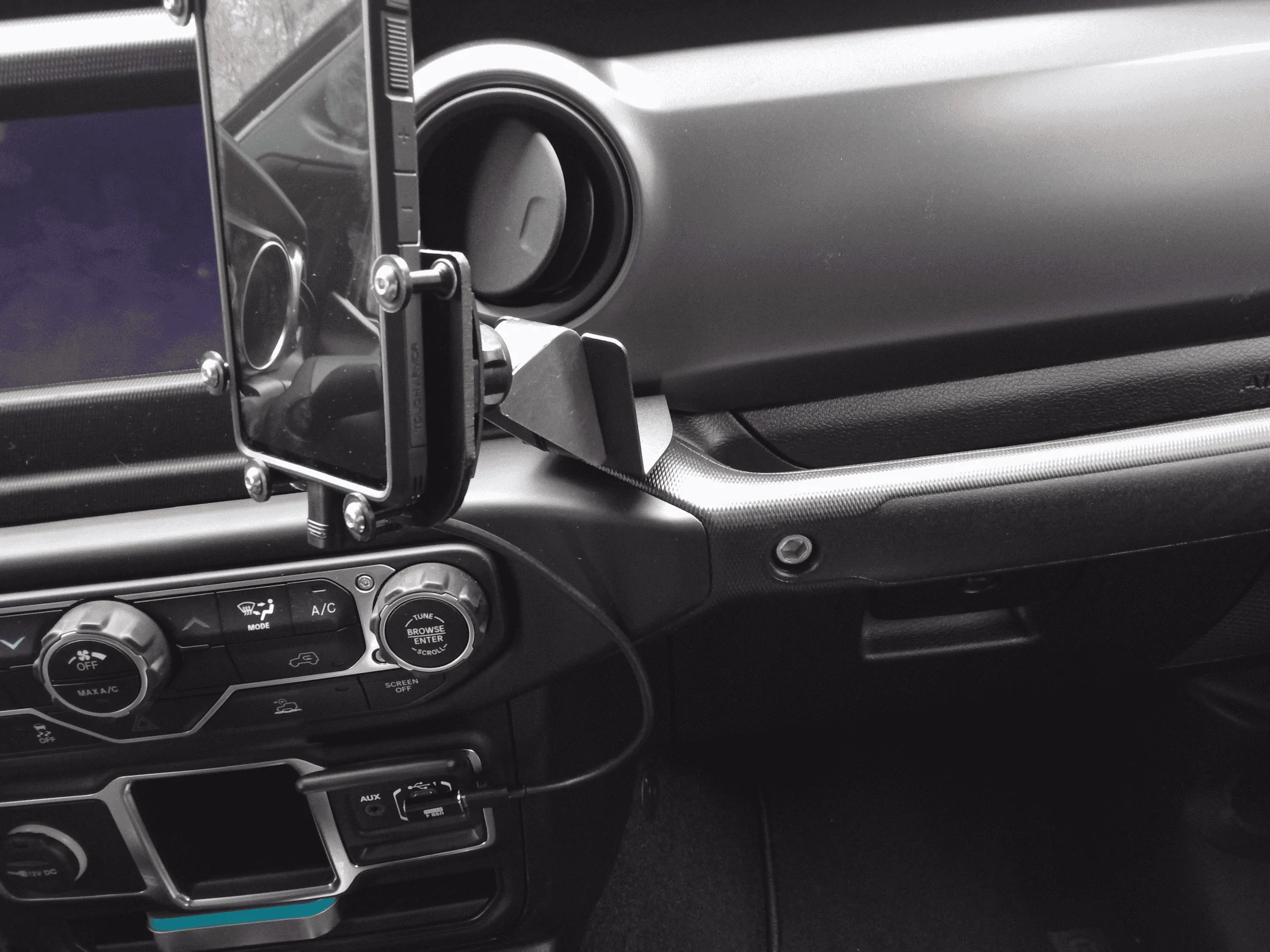

Finally, here you can see the clean cable routing; I found a 12" cable with a right angle plug to point the wire straight back from the phone, and a right angle adapter for the bottom end so the cable isn't sticking straight out from the dash plug; I can close the media door most of the way:

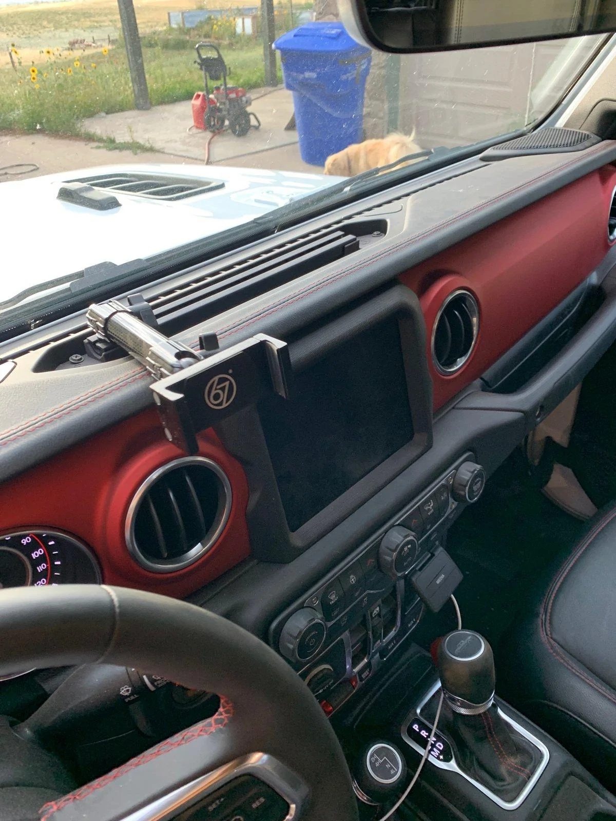

Hey guys what have yall found for the Gladiator as far as mobile mounting solutions? I had the JKE Dock from Vector in the JK so will probably be going with that setup but I do also like the new slimmer design. The little mounts 67 has done for inside that useless cubby on the dash are interesting as well, found here. Also noticed 67 is now doing a full bar through that cubby may go that route or a combination of sorts to get the most freedom outa the dash. Anyone offering ball replacments for the screws in the grab handle like they did on the JK? Was always a great little spot for the CB mount...
