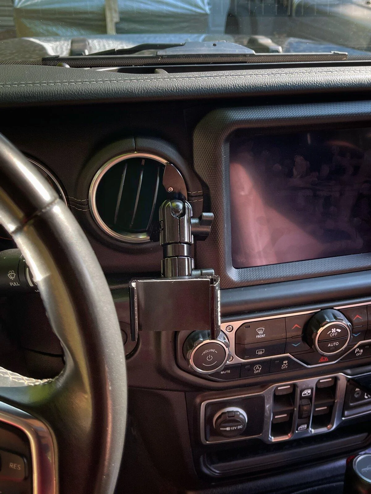

Offroam’s mount is genius and puts the phone exactly where I wanted it.
That is an incredibly clever design. I've tried one of the generic center dash mounts that replaces the tray but it blocks too much of the windshield. I just ordered one of these and am going to pair it with this wireless MagSafe charger I've been testing out in my work car.

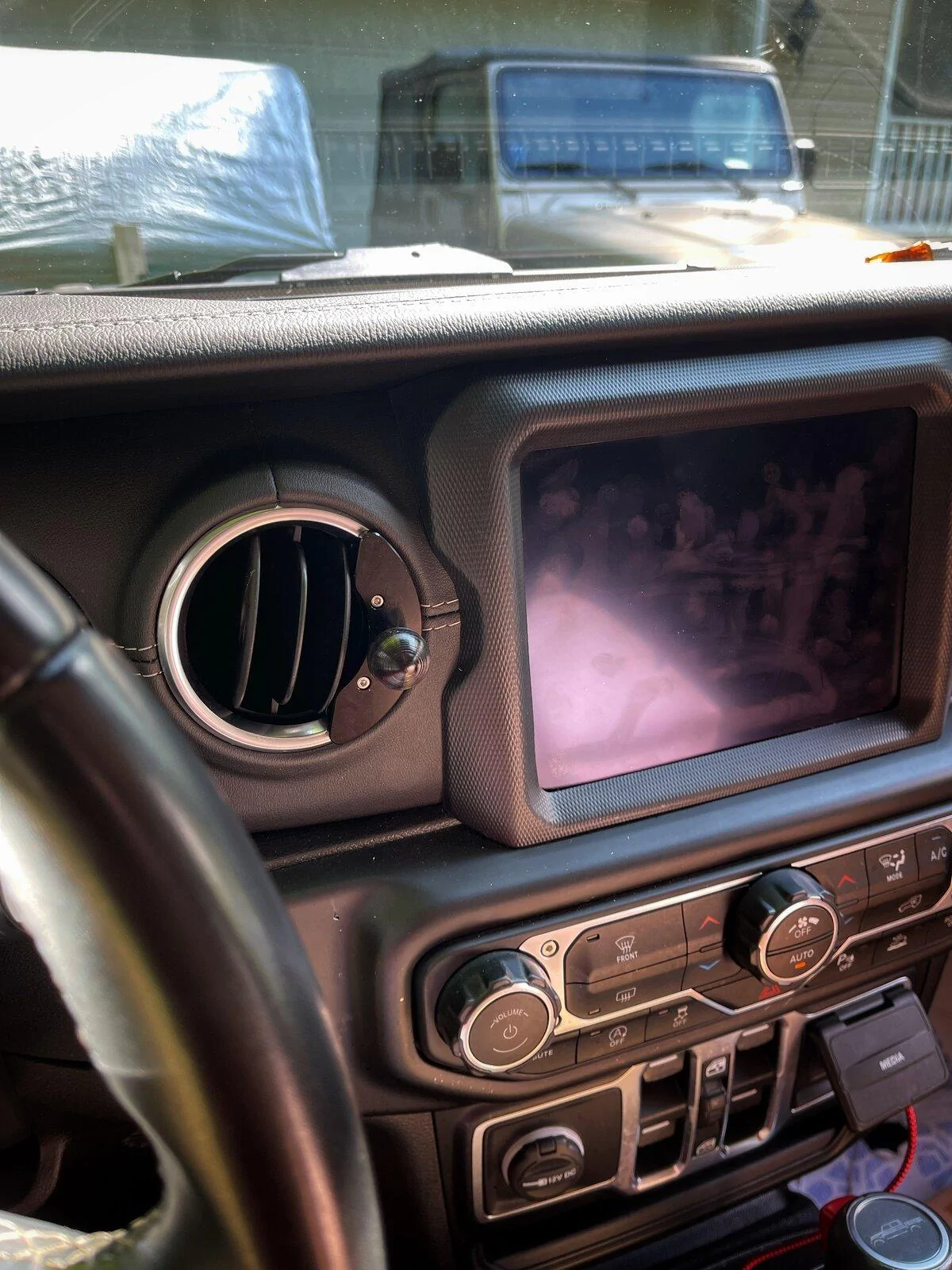

Update: Thanks to quick shipping by Offroam (and very friendly customer service) I was able to install everything today. Ended up going with a Spiegen MagSafe mount. At some point I would like to get a power source behind the dash but I can live with the exposed bit of cable for now.

I might switch it to the passenger side for a trial run. My only complaint at the current position is the phone is a bit close to the wiper controls. Moved to the other side of the vent it blocks a small portion on the left side of the display.
Running the cord is very easy. HVAC/Stero control panel is just held on with clips. Use a panel removal tool wedged between that and the grab bar and it'll come off, lots of space for the excess cord behind it. Two screws holding the bezel around the touch screen and then you can pry that up enough to run the cord to your charger.

Thanks, another quick question, it looks like that's the vent mount, I assume it snaps over the ball on the OffRoam without using the phone mount arm, just the magnetized piece?
Thanks again.
Thanks again.
Yeah, I Frankensteined just the the vent ball mount to the Spigen MagSafe charger.
