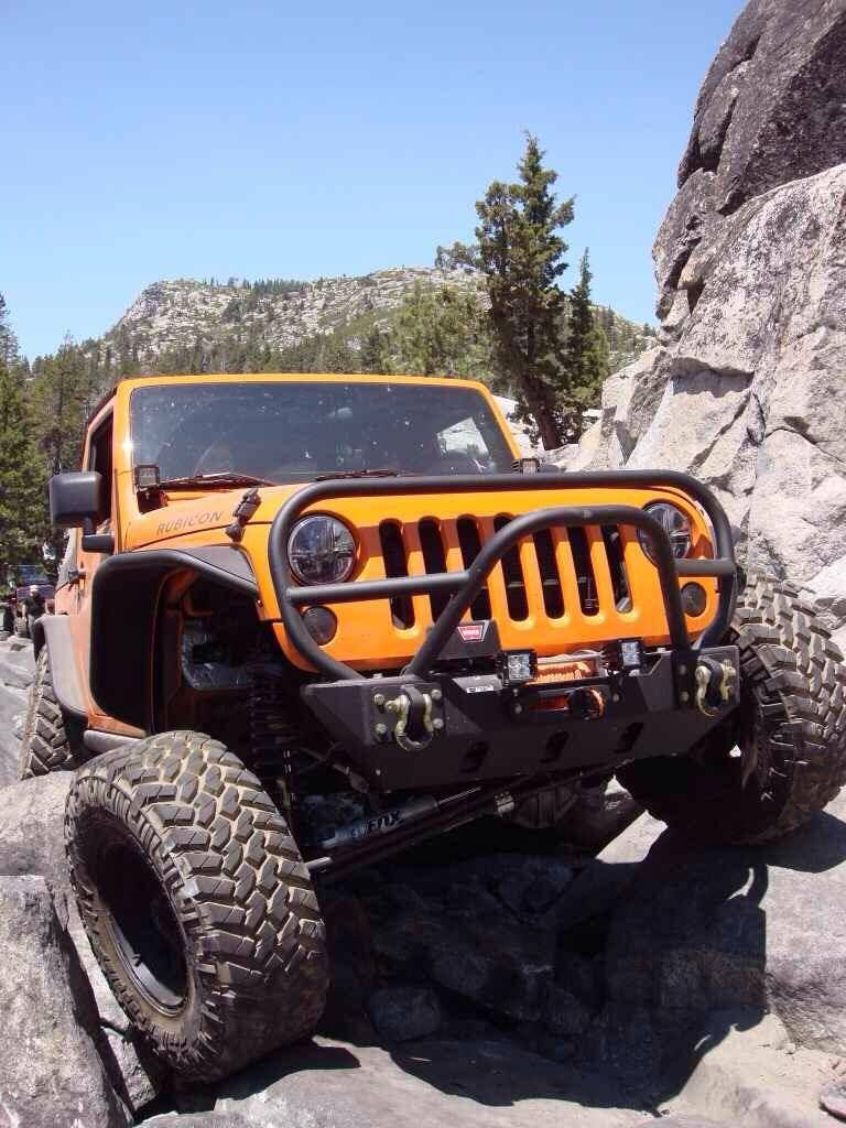

Bonus photo of my JK
Jeep Gladiator Planning my bobbed JT build - Advice Needed! 1746807936704-dm

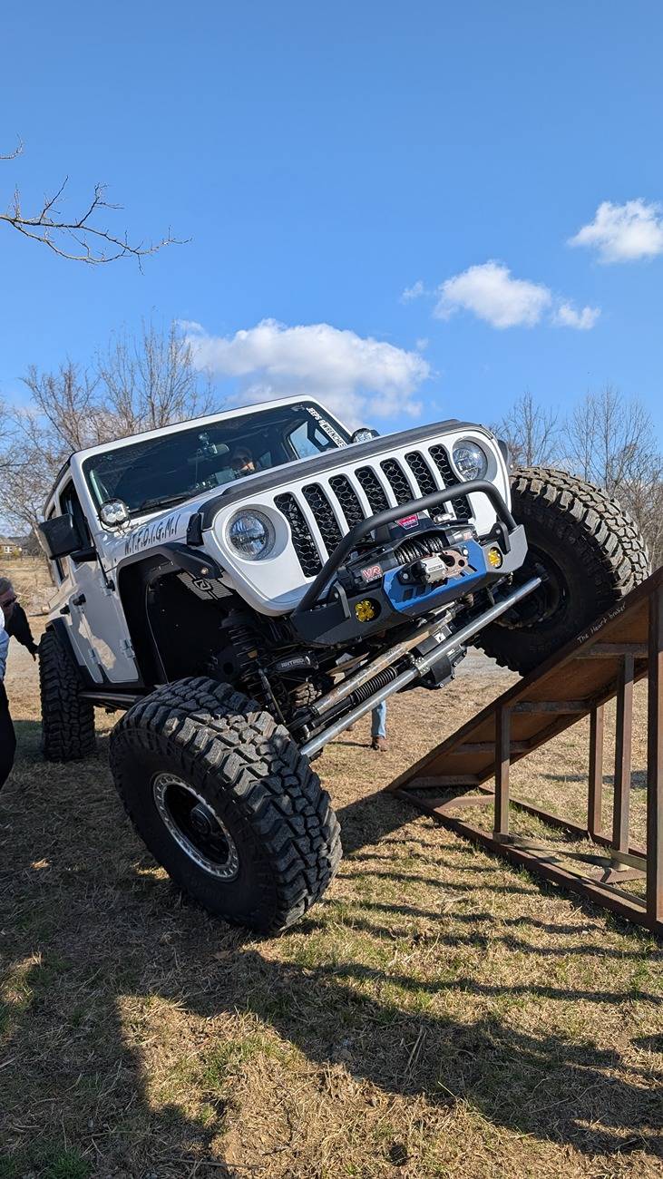

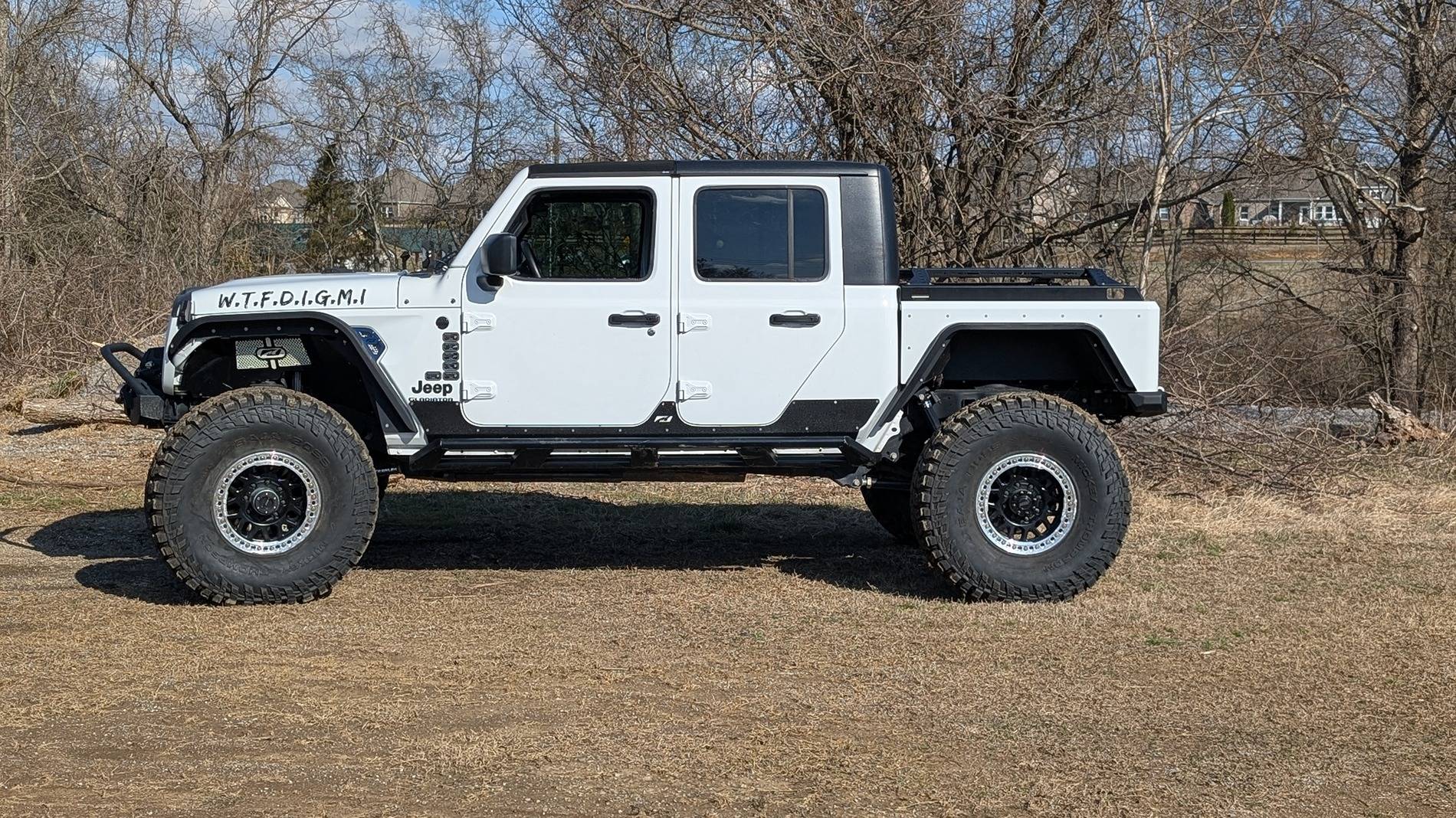

Jeep Gladiator Planning my bobbed JT build - Advice Needed! PXL_20250308_150155706.MP
So my Gladiator is bobbed on tons and 40s, I have D60 front and 14 Bolt rear from ECGS, 5.38 gears. ARB lockers. 40 spline axle shafts.
Beadlocks are KMC, Tires are 40x13.5x17 Mickey's, Steering is RPM and PSC, Lift is the Rock Krawler 4.5" Adventure Pro-X.
Transfer case question - Rubicon if staying a V6, Sport if you are swapping to a Hemi.
No input on the manual, as I bought an automatic intentionally this time. Mine is my daily, although I don't have a commute.
Flexy ramp fun when the build was finished, pre-PSC ram -
