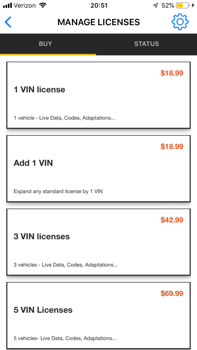

I just bought everything needed an hour ago.
$30 for the VGATE (Prime free shipping)
$40 for the additional cable needed (Prime free shipping)
$19 for one car license (Will buy later)
So about $90 all in for one car.
The two parts arrive on Friday.
Side note .... I need it for four cars so I need to spend near $62 instead of the $19

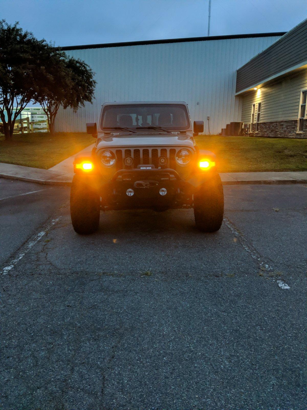

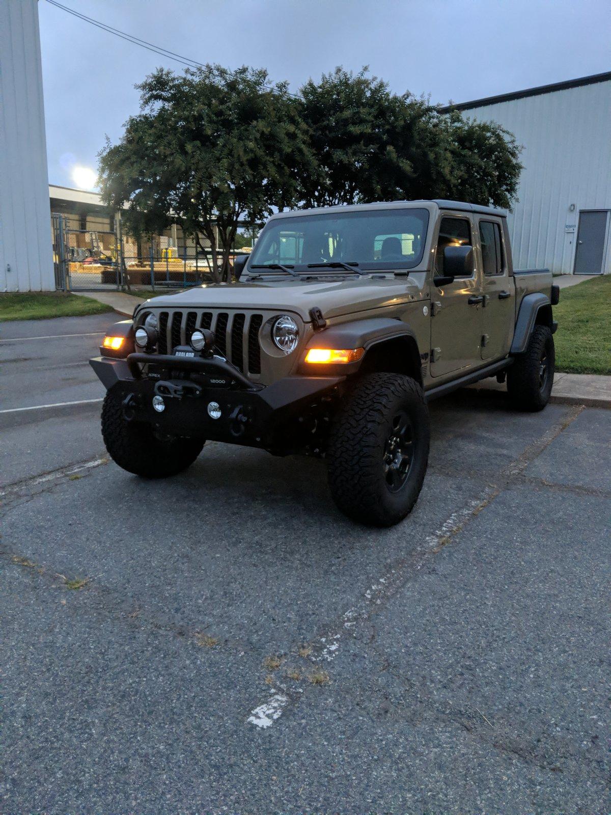

You have your drl set to turn signals? What does that do? Can you disable the drl so there not on at all? I upgraded my headlights to the Oracle bi led and have the led rings on for drl, I don’t want the fender drl on anymore
Side note .... I need it for four cars so I need to spend near $60 instead of the $19
When you buy the additional licenses just buy one and then use the option to buy three more. I bought one and then bought a second one and when I tried to purchase a third single license it wouldn’t let me and had to buy three. So now I have five licenses. Still a bargain though.
The turn signals come on and burn as a DRL instead of the outside fender white lights, kinda like the Tacoma and Tundra does. It comes automatically just like the regular DRL does when you crank up the jeep. I have replaced mine with led bulbs so they burn pretty bright. I prefer the amber DRL over the white, just a preference.
