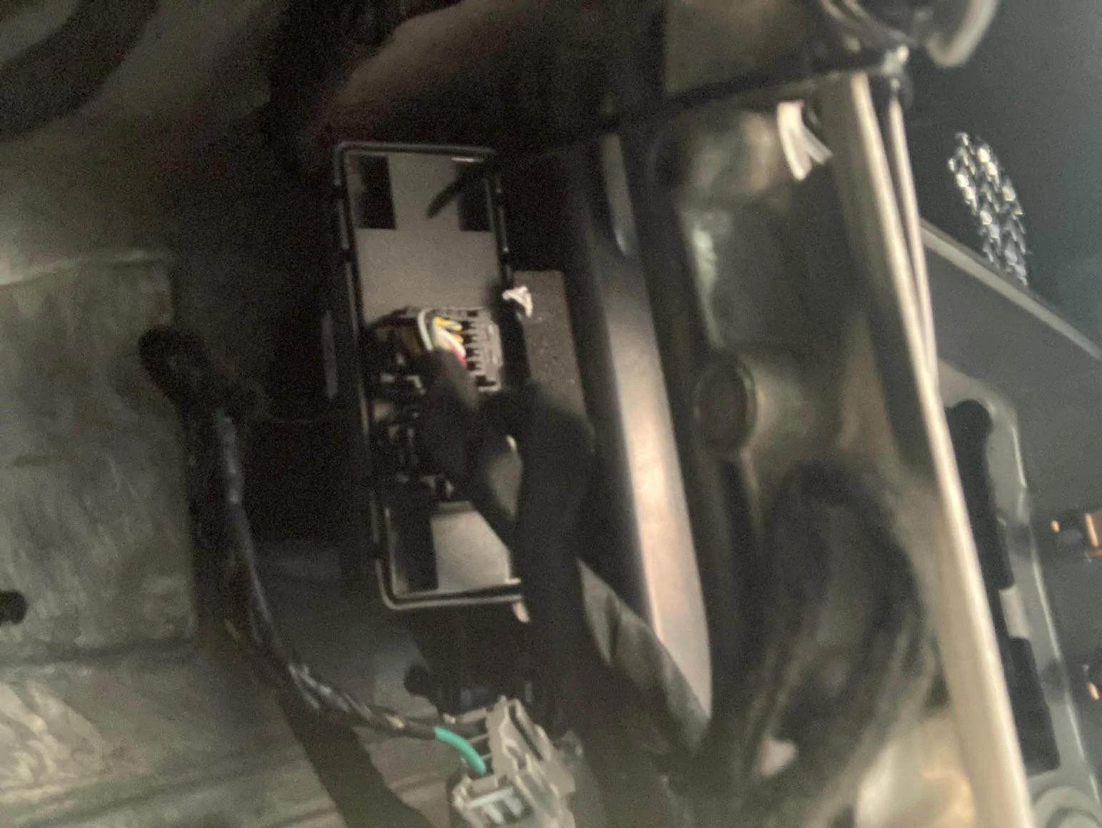

I could touch the cable ends with the tips of my fingers and I could just use one finger to sort of depress the tab but there wasn't room to grab the connector end. I tried to pull on the cable itself but ended up having to make a hook to do that. I was able to use a finger to depress the tab and pull on the cable. There isn't enough room on mine to do more than that. I could hold the connector between two fingers - barely, to guide and aim the connector to plug back in but even that was tight going. Didn't have enough finger length to really apply pressure or reach up high. Once they were aligned I had to use a finger tip to push them up into place. Apparently the Overland has things a bit differently arranged? Dunno.
Its defintily different. I snapped this pic by holding my phone under the dash with the front facing camera pointing up. It's as out in the open as can be in my Sport S.
Jeep Gladiator JScan app PLUG
So now we need to see an Overland (or higher trim) to compare.

I really don't understand people having problems with the cables. I just pop them out, never was an issue. Push the clip with my pointer finger and pull down with pressure on the thumb. Maybe some models have something else in the way but my Sport S auto is easy to get to. I needed the app when I changed tire size, and also when I put on my MOPAR steel bumper. The LED fogs on the bumper hyperflashed bad until I enabled the LED fog option.
Did you have the 8.4" screen? If not, the smaller screen guys have it easy. I can unhook factory and hook bypass in on those rigs in a matter of 5 seconds. The larger Uconnect screens have a separate module underneath that take about a minute or so to get to, even if you use tools as most peoples hands don't fit in the space.
That must be it then. I have the 7 inch screen.
