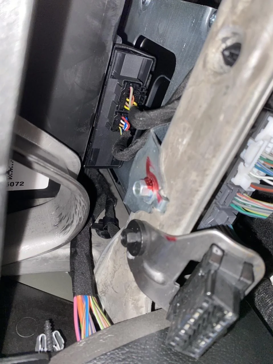

I thought I would share what those with the Overland trim are talking about. As you can see in the picture there is another module on top of the security gateway. It can’t be accessed by reaching up. You have to snake your arm in front of that cross support to unclip the connections.

Well I installed Jscan today. Very easy. But holy sh!t those plugs. Was able to reset my TPMS and foglights on with brights. I thought I disabled the ESS, but it didn't change anything...damn. Putting the plugs back in was a nightmare. I wanted to just leave them unplugged but then the infotainment screen wouldn't come on. Took an hour of trying. Cut up my fingers.
I can't remember who makes it, but I bought an extender cable for the SBW. It has both make and female connectors and brings it down where it is easy to reach. Then you plug two cables together. I think it was $30-40. Worth it for my knuckles after the first time.

Z Automotive (Tazer) now sells an extension cable to plug in to the security gateway. With it, you only need to stick your hand up there once. From then on, it's real easy to connect Jscan or a Tazer.
Yeah, that's the one. I bought it and love it.

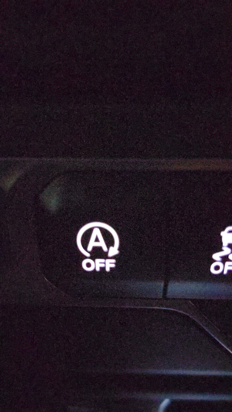

Jeep did it for you, they put a button to in to turn it off. It still gets me that we are so lazy that we can't just push a button to turn the thing off and I'm still trying to figure out why all the hate on it. Most of the people on this forum complaining about MPG's, don't use it and turn it off. It 100% makes a difference on your gas mileage.
