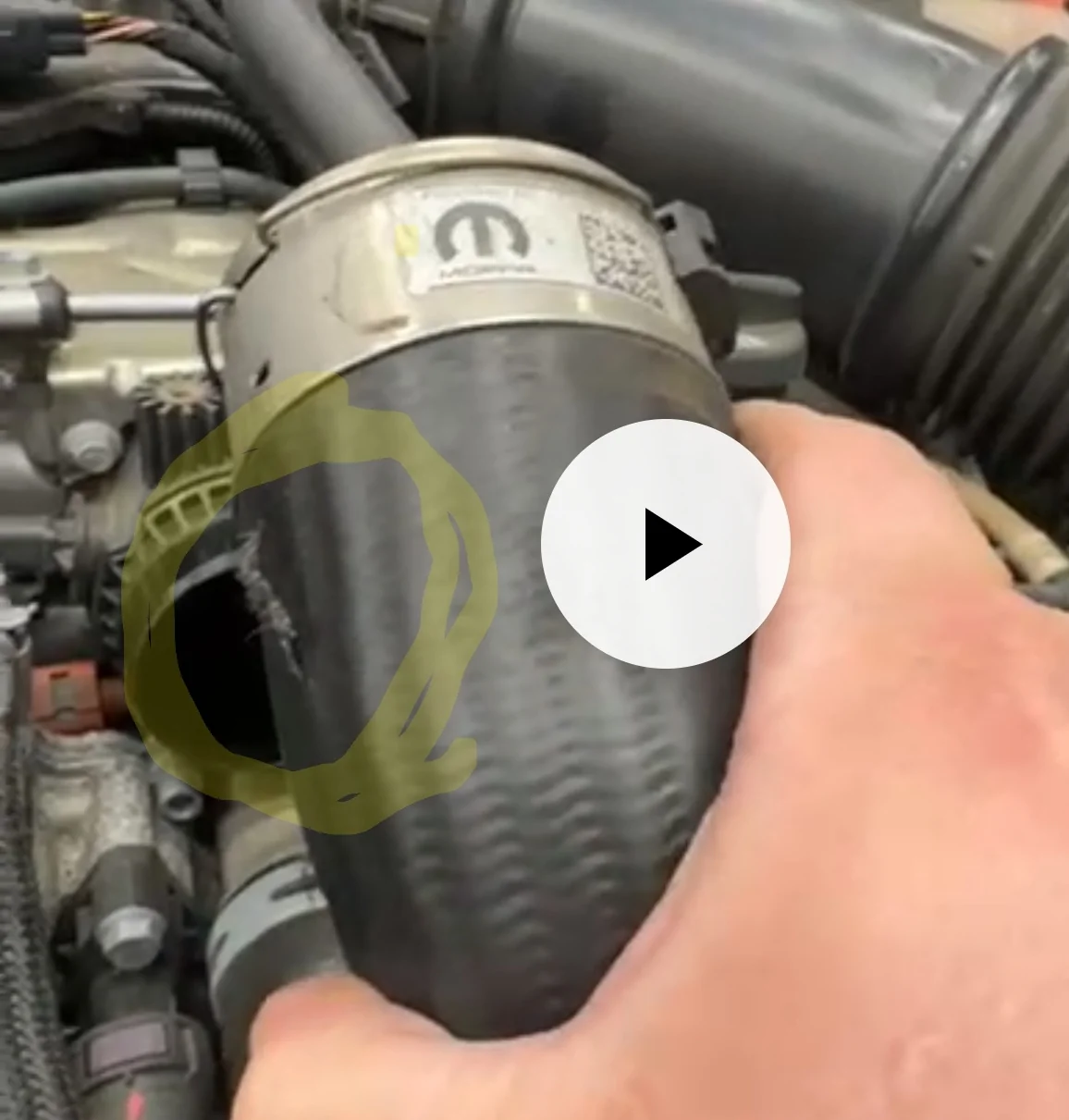

Check your Upper intake Charge Tube, mine threw this code on a long road trip through the West Virginia mountains. Then 2 weeks later the Charge tube had a blowout.

When that tube ruptures, you'll get P0106 and P04DA codes, it will prevent the truck from accelerating and force you to pull over.
Edit... P0299
