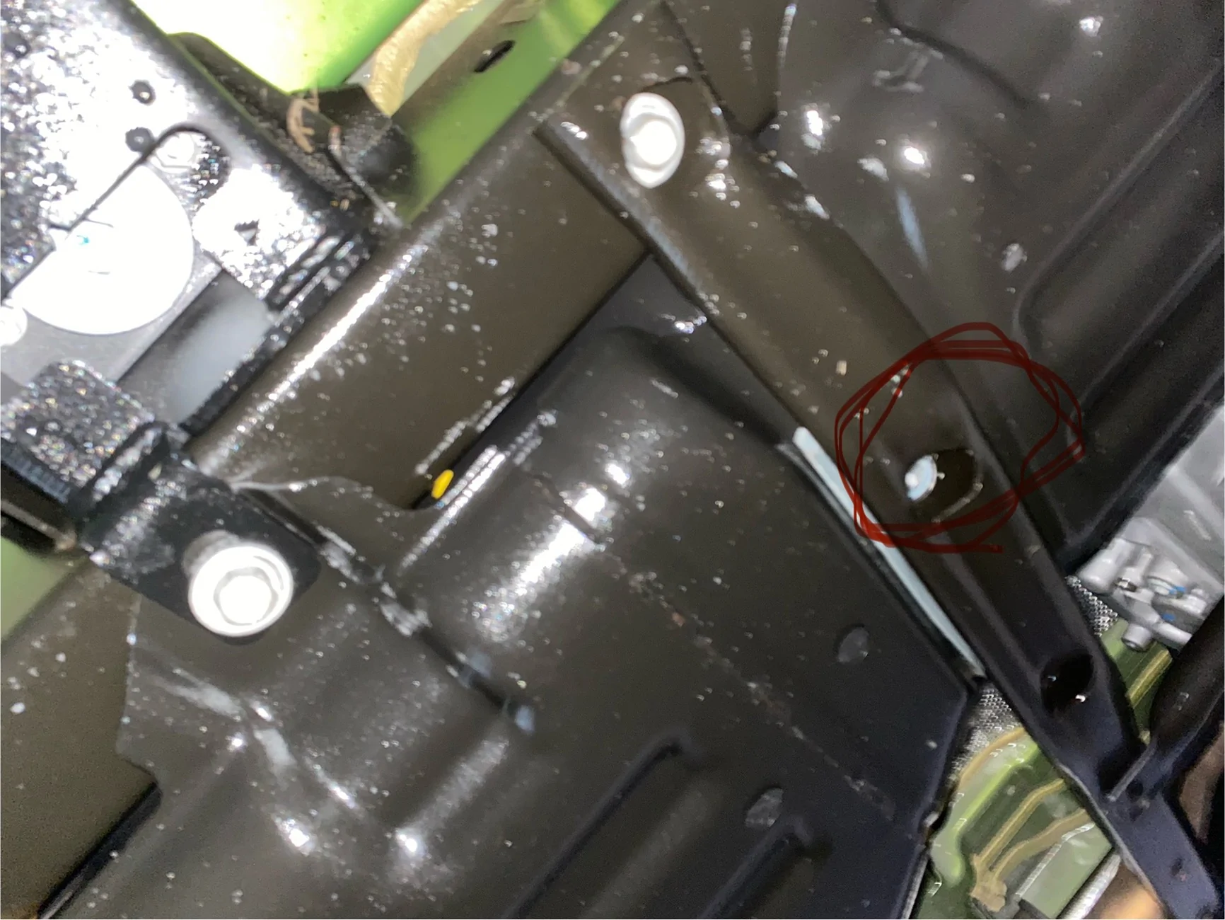

Oddly enough I have went through this three times on 3 different JT’s .
Strange thing is the problem never showed itself until after each gladiator had been fluid film under coated ( NE Ohio they love salt and brine ).
21 Willys with 20k miles teraflex leveling kit. 22 Sport S 50k miles teraflex leveling kit. And 25 Willys with Mopar ish Lift kit with 4700 miles 2500 since the lift.
Did brakes and shocks on the wife’s 22 a couple weeks back and decided to check everything over as hers was annoying any off camber chassis flex at low speed ( driveway apron ) etc.
tightened up every skid plate bolt and the one pesky nut that ties the transfer case skid to the stud from the gas tank skid plate. That nut just never wants to truly cinch up all the way. But it almost completely eliminated the noise.
My 25 was undercoated a couple weeks back and lo and behold 4 days later the same noise started ugh! Since I had already rechecked torque on all suspension after a 1000 miles and paint marked all fasteners, I figured I would get under it today and do another round of checking and also check my skid plate bolts and LOD slider fasteners. Was able to get a few ugga duggas on the skid plate bolts and just like the wife’s, that pesky nut the ties the transfer case skid to the gas tank skid plate just doesn’t want to fully tighten. Go for a spin and only hear it a couple times pulling up on curbs at angle..
so I come back and crawl back under it and I’m going to see if I can tighten that pesky nut some more… Snap!!! It broke off..
so at that point I figured oh well let me go for another ride and did the curbs again drove through some deeply sunken parking lot drain grates and no noise at all.. Don’t know if coincidence or it’s that damn nut, but tomorrow back and forth to work should tell me positively if it’s solved. If so I’m going to remove the nut off of the wife’s gladiator after work tomorrow.
Mine was the driver side outer bolt. The nut inside the frame broke the weld that was holding it and allowed it to wiggle around and clunk.
