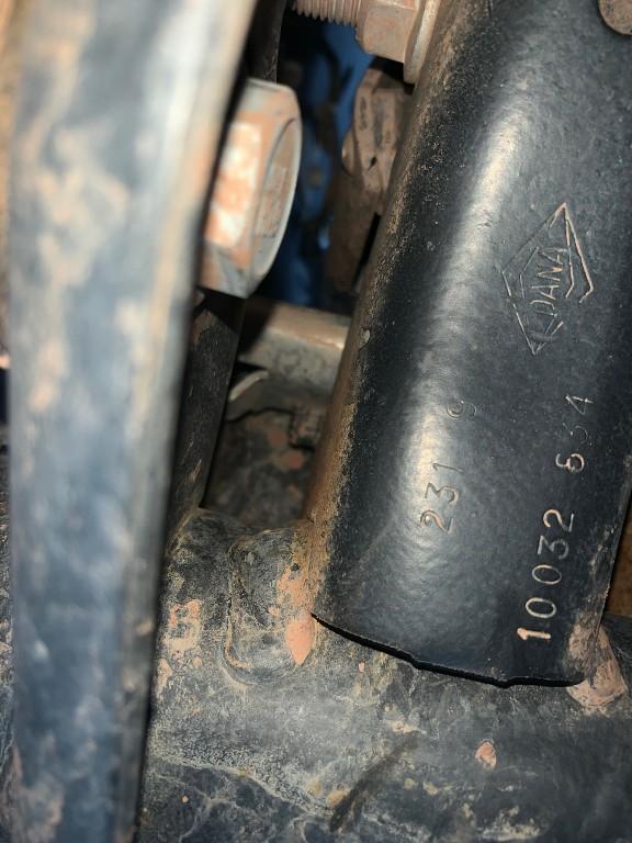

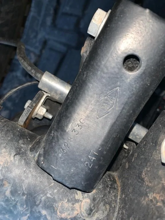

To help with this, here are pics of my front lower shock mounts. Mine is a JT Rubicon with manual transmission. The shock mount numbers on mine do not match. So, I assume that is good.
Here is underneath of the passenger side shock mount on the axle.
Jeep Gladiator Possible shock mount recall ZKozXb
Here is a pic of underneath the drivers side shock mount on the axle.
Jeep Gladiator Possible shock mount recall 306Dgh

I would assume you’re fine- I don’t know the status of the issue, or if a recall is imminent (that speculation was from the FB group) I’m just putting it out fyi
