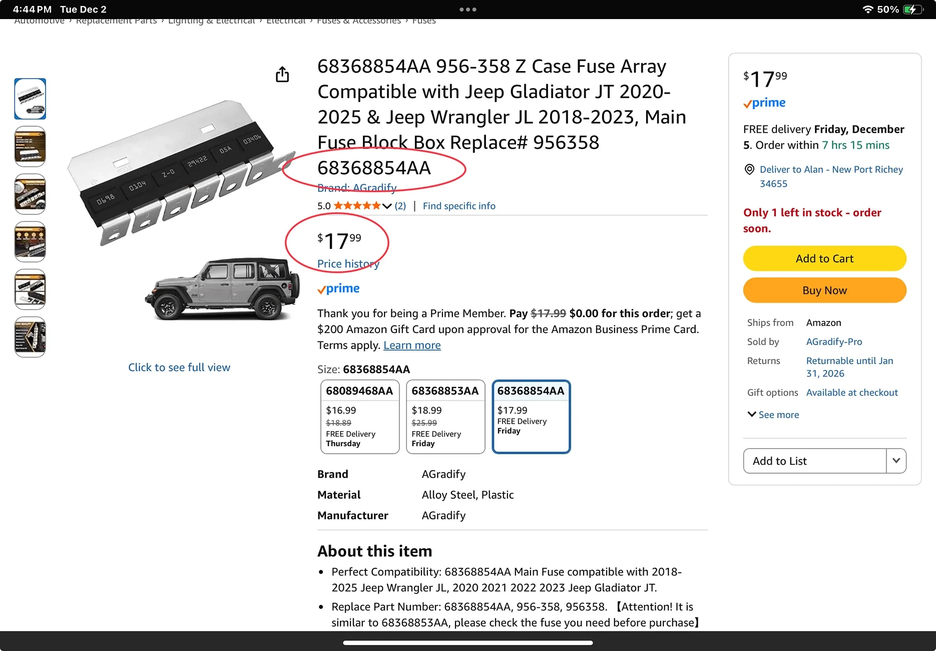

It keeps getting better 🤣 it’s a $18. replacement that Jeep charges $100 for
It's dropped in price, and at dealerships then too. My dealership billed it as $399.00 "warranty" part. The spare I bought was about $30-35 on Amazon I think back in spring.
For anyone getting it replaced by dealership try to get the old one back, it typical burned one that is a double. AKA; so when the original batteries fail and fries one of them, they can bump over to the second one and send out. ;)
