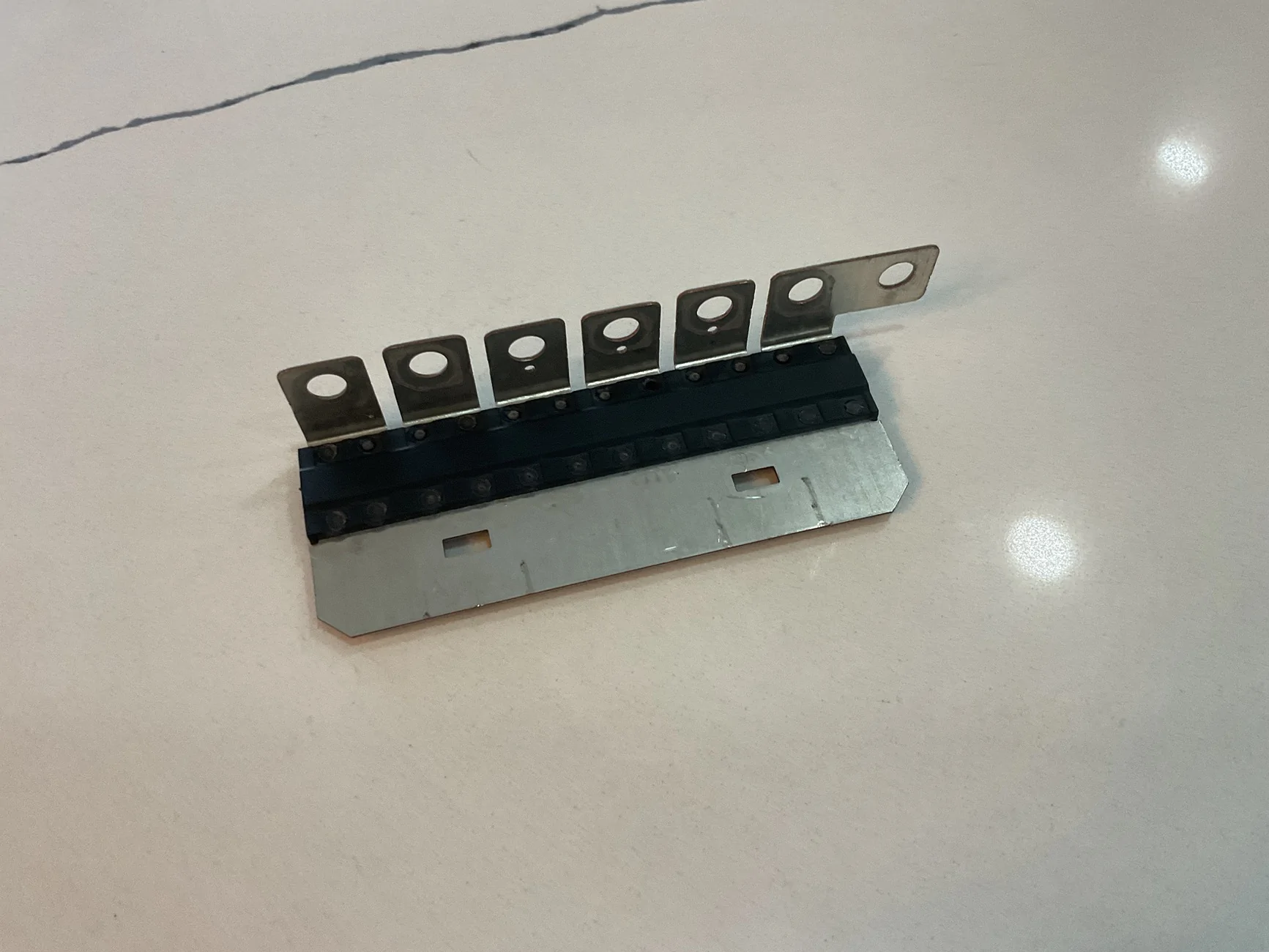

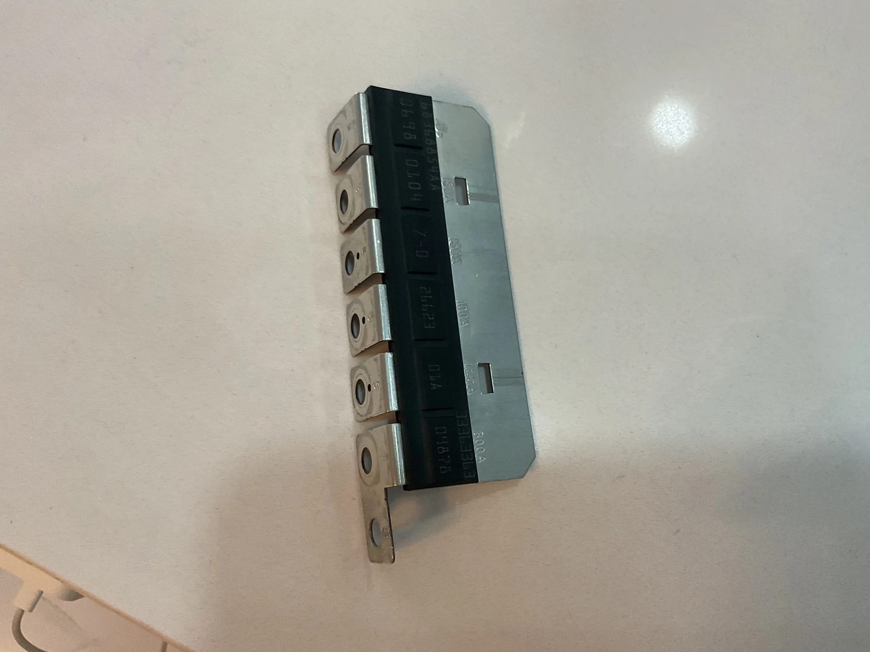

Update! The fuse block fried apparently. The dealer replaced the auxiliary battery because it was dead. The technician said that it must have failed previously because it would take a while for the battery to drain down to dead. The auxiliary battery is what powers the power steering pump, which explains losing the pump power (pump was okay). Big issue is the dealer says Jeep warranty doesn’t cover the part because they “never fail…..unless you do something wrong to them”. Repeatedly the advisors both said that they “never” fail without something external causing it. They asked if we tried to jump start the truck, which we didn’t. They literally kept implying that I must be lying about trying to jump start it, or something. Ferman Chrysler Jeep Dodge Ram in New Port Richey FL. I hope Jeep customer care is monitoring this forum and reads this. The service manager finally spoke with me, and he said that they fail “all the time” but typically when someone does something wrong. I understand that, but since I have done nothing, maybe they should look deeper into this, but no, they just want me to leave the service department and stop raising hell about basically being called a liar. Parts fail, I understand. I just don’t understand why Jeep doesn’t warranty the fuse block in the bumper to bumper warranty. Now I have to chase after the engineering department and enlighten them to reality. As a 45 year electrician, and the last 10 inspecting big solar PV sites, I have seen hundreds of failed DC fuse blocks, strips, connections fail. F*@kinghellman! Take some ownership Jeep! And the service advisors need to learn some basic communication skills.

This makes a lot more sense as to why a 'power steering failure' led to being completely stranded.
Due to the importance of this fuse array, some folks recommend keeping a spare in the truck for the unlikely event it fails or you accidentally kill it.

Great idea. The first gladiator had no problem with that, even though I did add a winch and lighting. But, for such a small part and only $100, if I was wheeling somewhere remote I would have been totally f*@ked.
