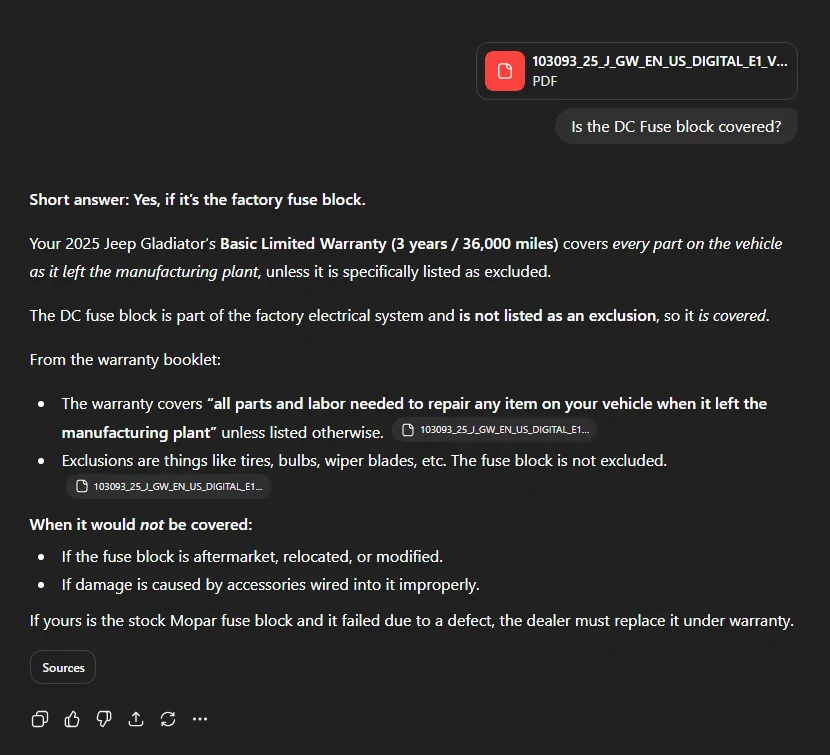

1) The DC fuse block is part of the electrical system and absolutely is covered by the basic limited warranty for 3yr/36000. The only things not covered are normal wear items like tires, wiper blades, etc) Heck the warranty even covers a windshield replacement for 2 years. Any extended warranty should also cover the electrical system.
2) Why would doing something the manual instructs you on doing void a warranty?
Yes, I literally read that to the service manager. He said that they don’t list every single part that is covered, and the fuse block is not. We’re going to see about that bullshit. Less than 8k miles, with no electrical modifications. I can’t say strongly enough to stay away from Ferman CJDR
He's absolutely full of S&*T. It's for sure covered. Don't stop until they do cover it. There is no law saying a dealership can't lie to you, so many of them will deny you at first, hoping you'll just go away. You have to stay on it on these types of things. Every dealership is also different, some might give you hassle some might not. But take it up the ladder with Jeep.
