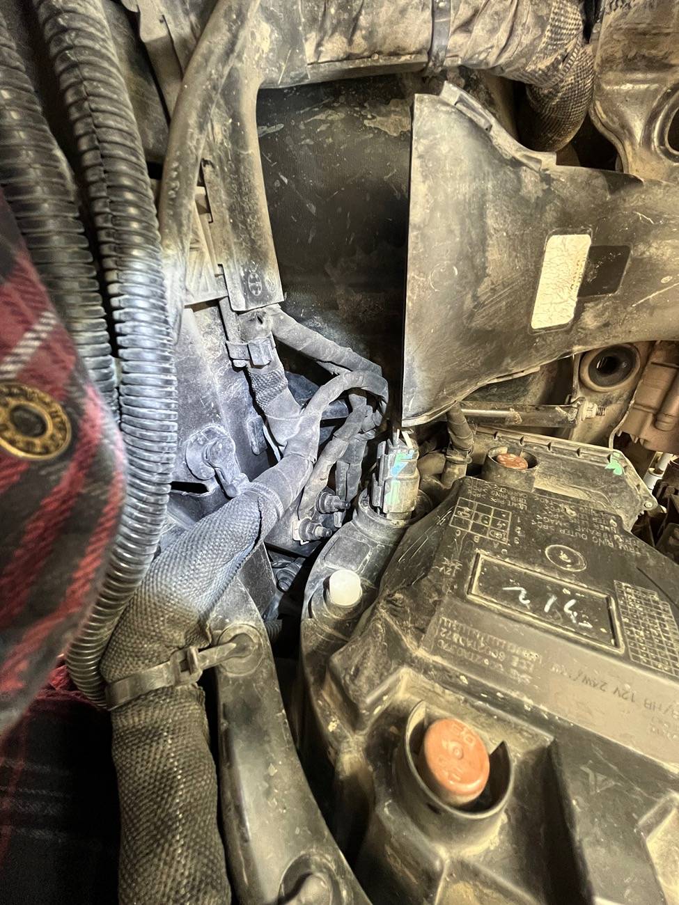

I’ve seen a tech on Facebook point blame on the TCM connector that is just on the other side of the front passenger mud guard. Water gets in and has caused a crap load of issues for us. It’s the same kind of connector we undue to take our front doors off and we all know the crap we have to deal with if a pin gets bent.
This tech has seen corrosion with a pin or two in the TCM connector.
I’ll be undoing mine and spray an electrical cleaner and lube mine to stay on top of it.

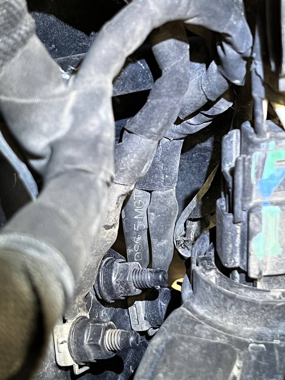

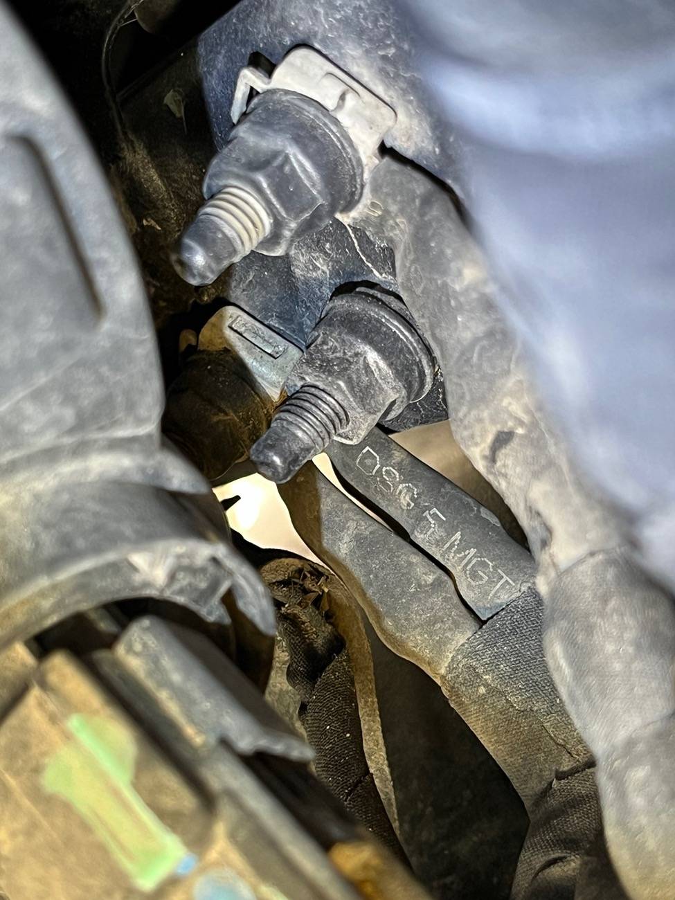

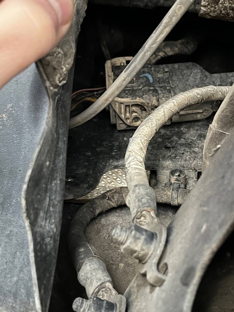

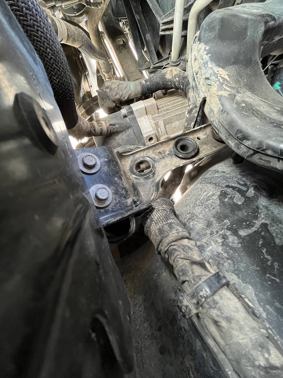

The problem with this issue is that it can be an electrical or ground problem and not just an air lock issue like I’ve found several times. The other issue you have, being so close to your warranty ending is that no codes are stored and you can bet that even if your pump has quit and you tow it in, the tech will start it up and the pump will be working just fine. In all my cases, the pump quit because it got super hot but then when the pump cooled down, it would function properly. I could actually just park outside the dealership service doors and idle the engine for a while until the pump got scorching hot and quit and I’d just go in and grab the tech and he would come out to confirm. The last pump just flat out failed and was seen by the tech and diagnosed as internal electrical failure.
I’m leaning more and more towards blaming connections for water ingress and corrosion and these connections could use a good cleaner/protectant spray (DeoxIt shield) and then reconnected. Also, the ground for the pump is located just behind the passenger headlight. There’s 3 ground posts and I’ve heard of some grounding nuts getting loose causing the pump failure.

Thanks for the information and pictures! Im also doing an oil change along with fuel filter tomorrow morning so I'll check out that ground location. I dont think my pump is overheating as it only happens after the truck is cold and has been sitting for awhile. Once it starts working it keeps working , it's just that first 5 to 10 seconds that it doesn't work.
