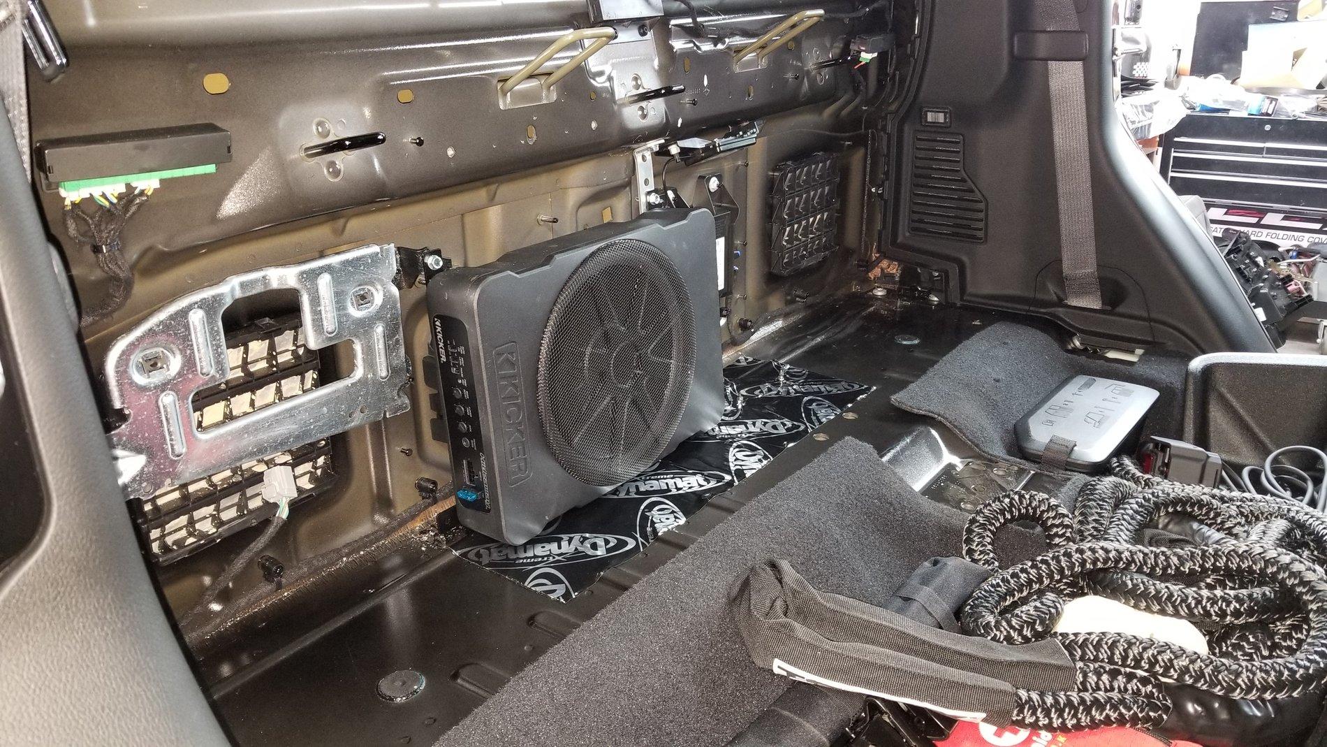

I disconnected the factory subwoofer and turned the radio on. The radio worked fine so we plugged the subwoofer back in and it started working. I don't feel removing the factory sub will affect anything so i removed it. Got the Kicker HS10 mounted with some left over brackets i had laying around in the shop. Now i'm just deciding where i want to run the power wire. I'm probably going to remove the passenger seat and interior panels and run it along the passenger side where i can exit underneath the floor mat with the wires from my electric steps.
JSpeed, did you take a picture with the trim reinstalled after the HS10 install?
if you mean after the install was done? It all looks factory, the big factory plastic back panel covers the HS10

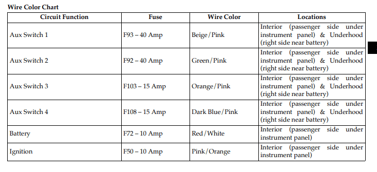

Instead of routing the new sub power wire through the firewall to the battery, is it possible to connect to one of the 4 AUX switches in the cab? I found this wiring chart below on the forum. But I thought the 4 AUX switch connect/terminating power wires where located near the battery under the hood. If the wires are in the cab like it says below in the chart, could I connect power there and not go to the battery in the engine compartment at all for power?
Or it be better to just wire power to the pink/orange ignition wire inside the cab in the chart below?
Just trying to avoid going to engine battery directly if there is an easier way. Any expertise would be greatly appreciated.

the wires for the AUX switches are right along side the battery so you have to run the wires to the battery anyway. i wouldn't waste an aux switch for that.

Ok, so I’m hearing the best advice is to go through the firewall straight to the battery with the sub power wire. If so, would the opening that the Aux wires go through the firewall be the best location or is there a better location?
Any advice is greatly appreciated.
you are better off going through the floor like i did and running the power cable under the truck. in my opinion it's the best way to do it. just go back in through this thread and the pics will show you.

My sub is under my passenger seat & this is what I did. Through the plug thats already there up the frame & then up to the battery. Easy 5 minute job.
I used the alpine kit so this is what was instructed for it.

Very good, thanks guys!
