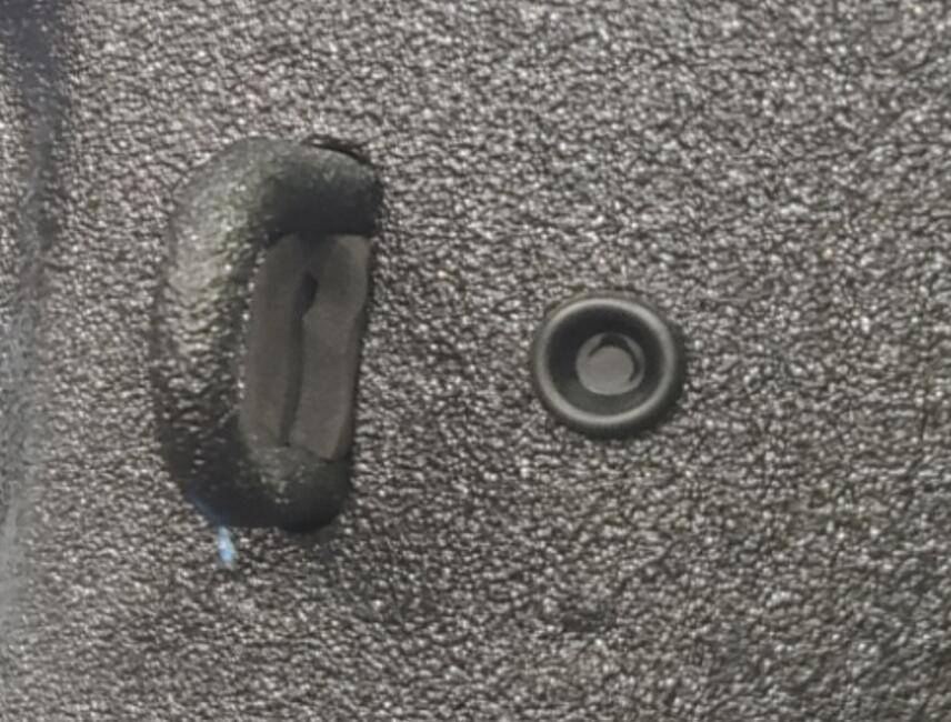

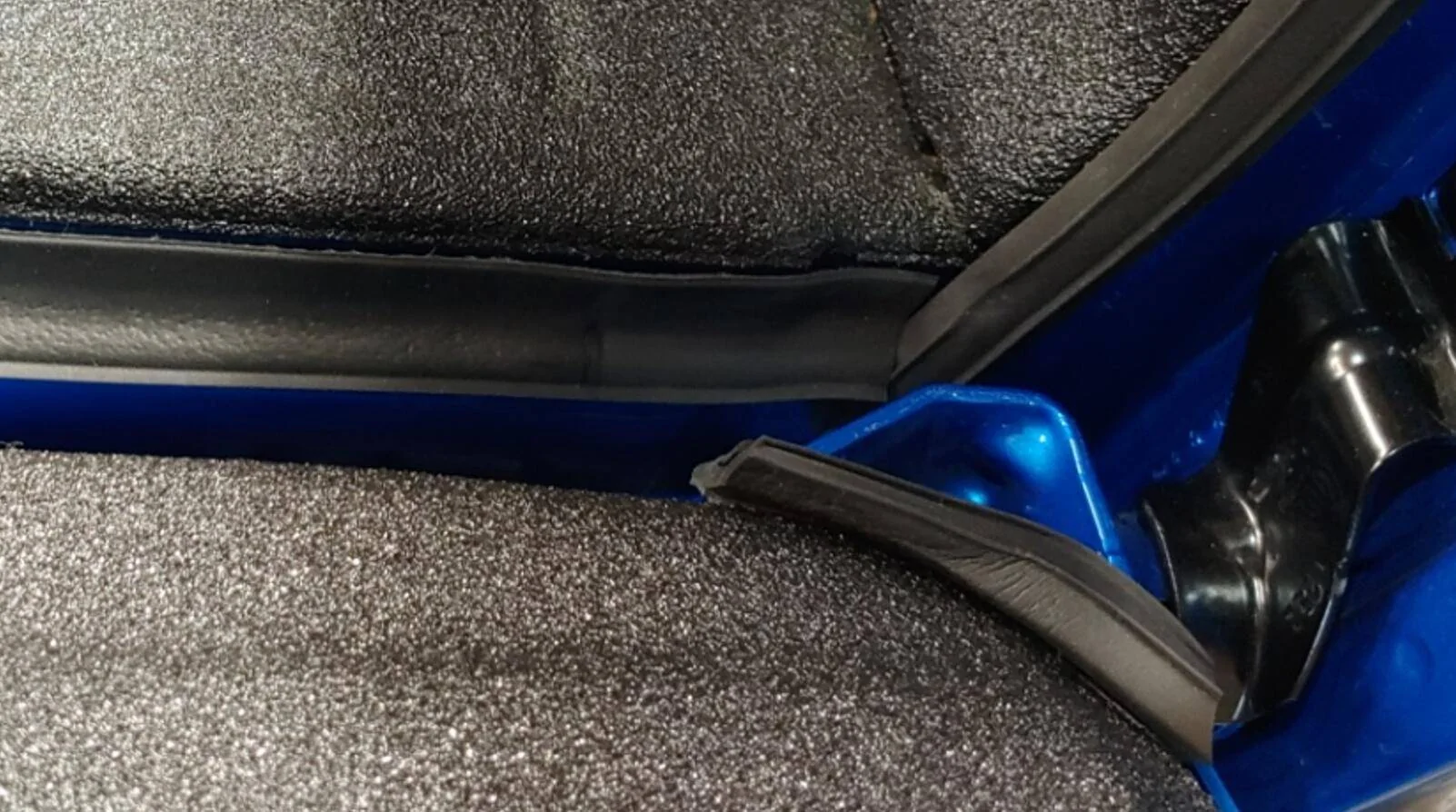

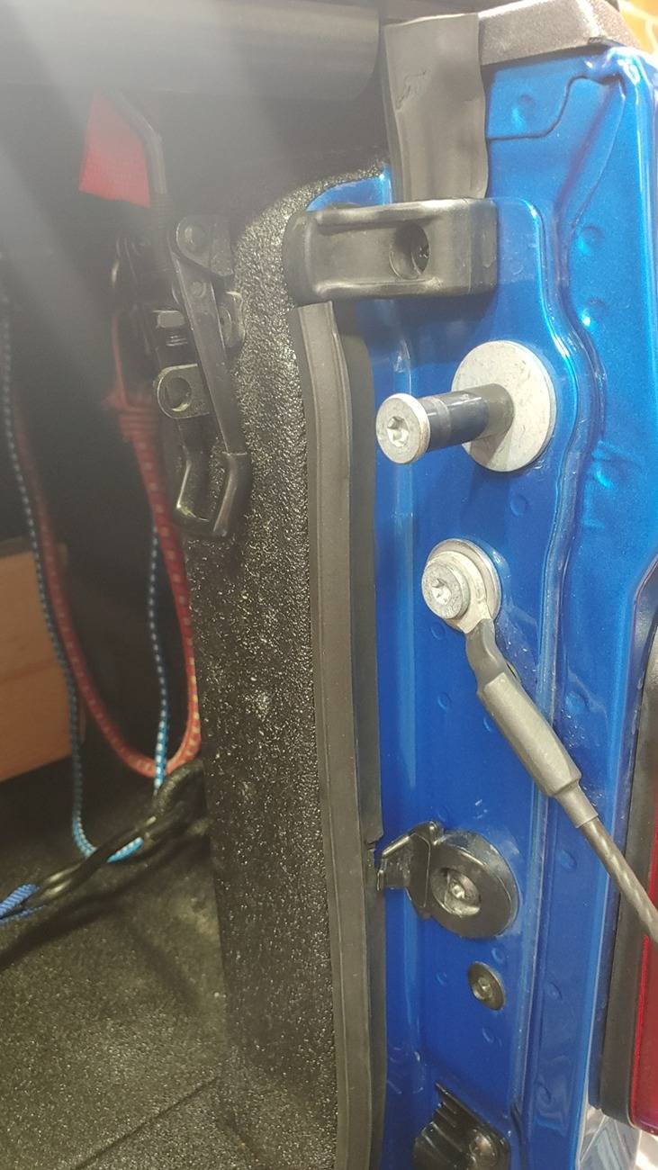

I plugged all holes on the sides (like the holes next to the anchor points), used a tailgate seal, and sealed around the rear anchor points and so on - no dust issues.

I have an assortment of grommets that don't have the middles opened up - works great for closing round holes in the sides of the bed. I was getting a lot of dust in through these holes in part because they are at the rear behind the rear tires.
The anchor point is another way for air and dust to get in - so I closed that with foam.
