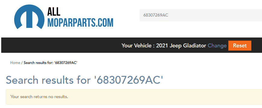

Am I doing something wrong? I search for the part numbers, any of them, and nothing comes up.
Jeep Gladiator Proximity door locks retrofit on Wrangler/Gladiator, someone figured it out (DIY writeup) 1601329184199
Since these are repair/replacement parts they can be found within our repair parts catalog here https://parts.allmoparparts.com/ , Sorry but this is a different section of the site.
