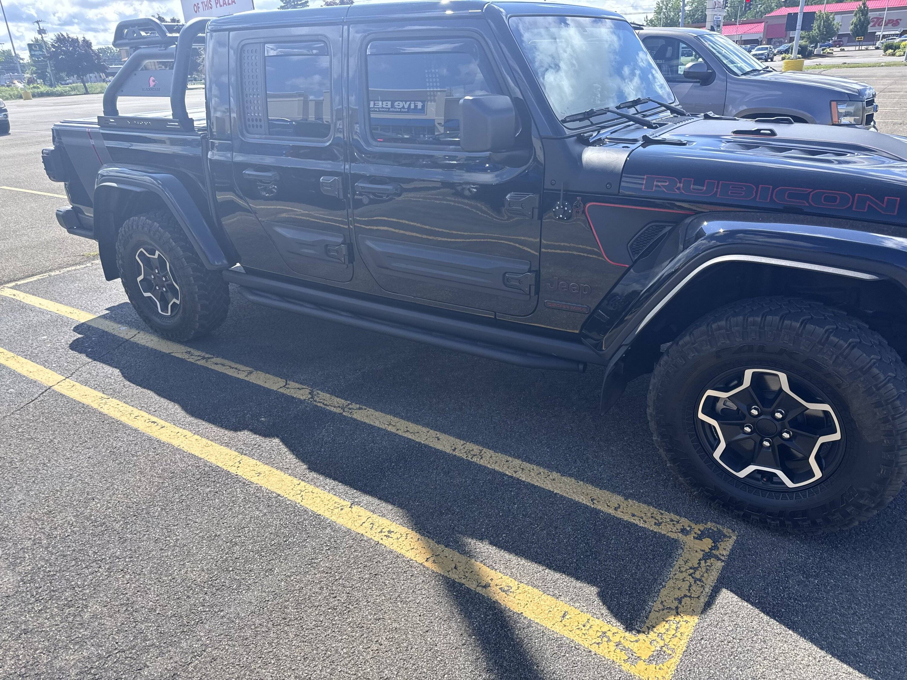

I really dislike the silver ring on my wheels. I see zero need to take it to a shop to repaint them all. I want to black out the chrome part of the rims.
is there a reliably solid paint that I can apply? Paint pen perhaps? (Yes I know I’d need several pens.).
mid assume enamel based would work.
any suggestions? Anyone ever done this? I searched and mostly found complete paint jobs or powder coats.

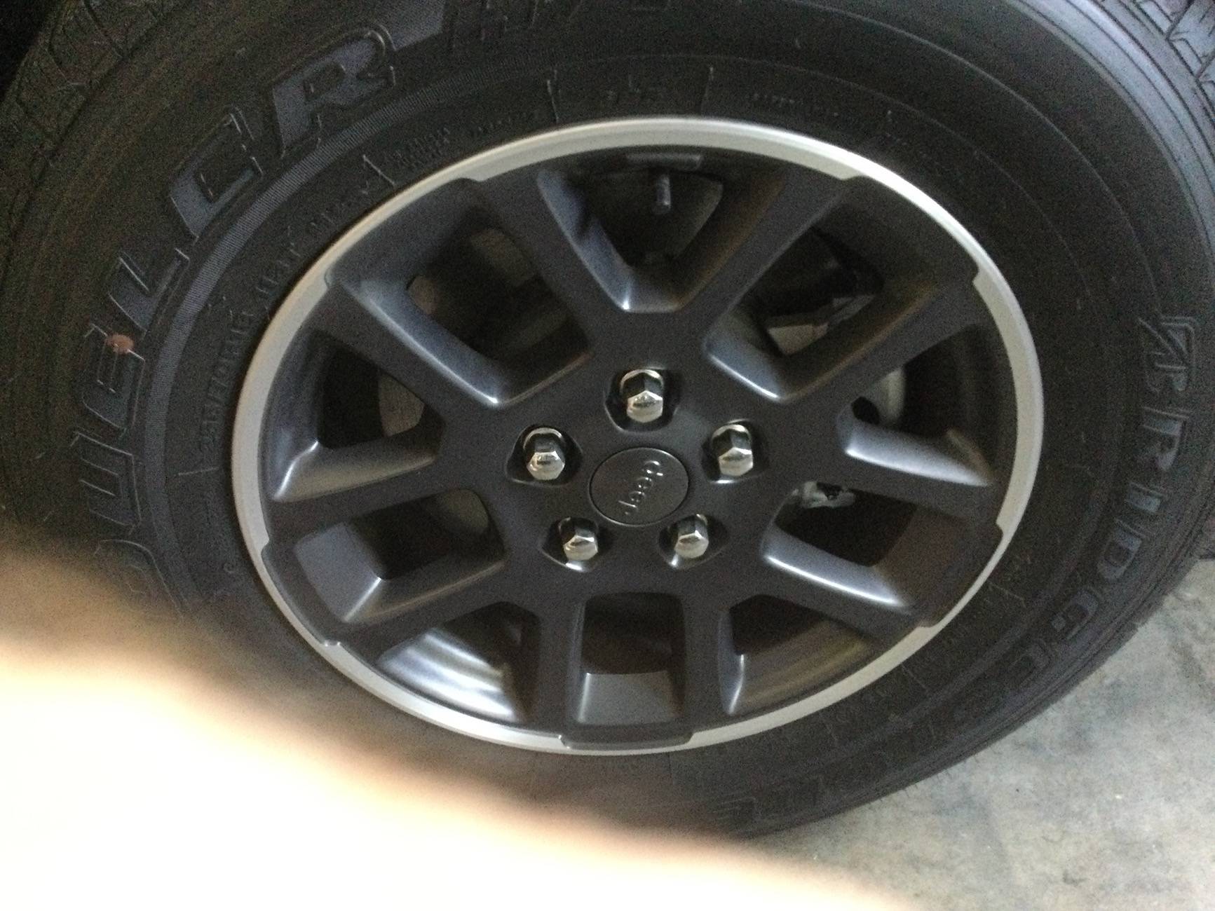

I have used dupli color wheel paint on wheels previously.
https://www.amazon.com/Dupli-Color-HWP104-Black-Performance-Wheel/dp/B002MB8TQ2?th=1
You can get it at advance auto and other places. Remove the wheels, tape off what you need to paint, and put a couple coats on it. They make clear coat you can put on top if needed/desired. It won't be perfect, you will have to re-paint occasionally, but it will help you sleep at night and save some money and time :)

Yep, was going to scuff with 1000 then wipe with alcohol.

Use a scotch brite pad instead. 1000 grit won’t leave enough scratches for the paint to bite into. Mask everything off that you don’t want painted and use a quality clear on it. Just be aware that some wheel cleaner products will be too harsh for the paint and they can strip the clear right off. Ask me how I know 🙄

I see you with new lug nuts next ? I like the wheels on my overland but mine don’t seem to stand out as much as yours on the rubi

Man they came out so pretty… and then my buddy came over and helped me wash the car for a show and that was that 😂
