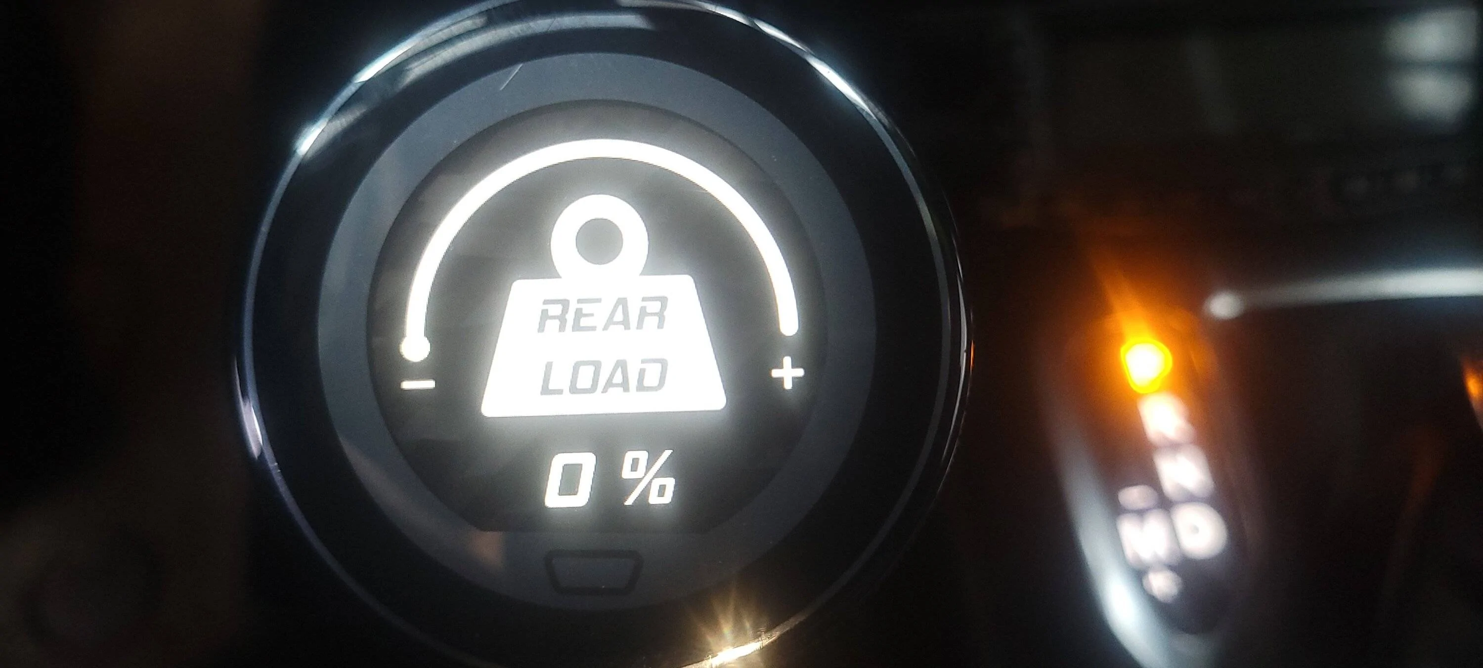

Yes, I increased the rear PSI to 35 for towing. Might not have had to go that high on the BFG 37's.
I first tried one extra click on the high speed, and two clicks on the low speed in the rear when towing. Was still getting a little bounce/wobble, so I added one more high speed and three low speed clicks on the rear (total of 2 high speed and 5 low speed clicks). That settled it down so well that many times I forgot I was towing. Took the 44 between Redding and Reno, the 95 down through Vegas, then the 93 on to Wickenburg, then on to Florence AZ. 1000 mi very easy pull.
The great thing now is I have a dynamic range of adjustability that I didn't have with the stock tune. Before I had to run both high speed and low speed nearly cranked, all the time. Now I haven't even tried it either all the way up, (pretty close to cranked on the low speed though when towing), or all the way down yet, so I'm confident I have some room to play with for exceptional conditions, (e.g. really cold, or fully loaded, etc.)

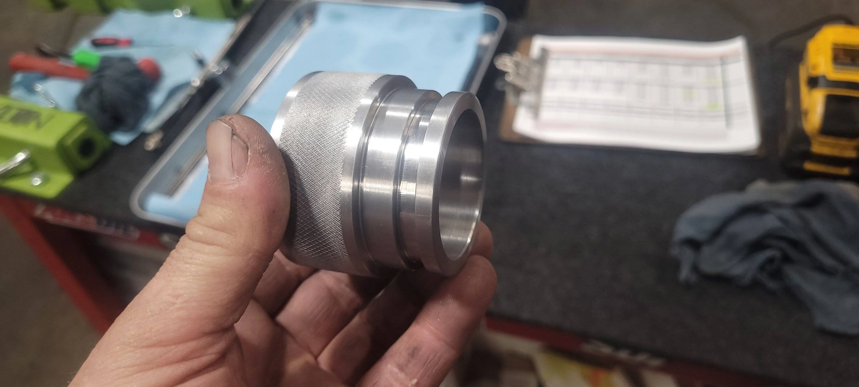

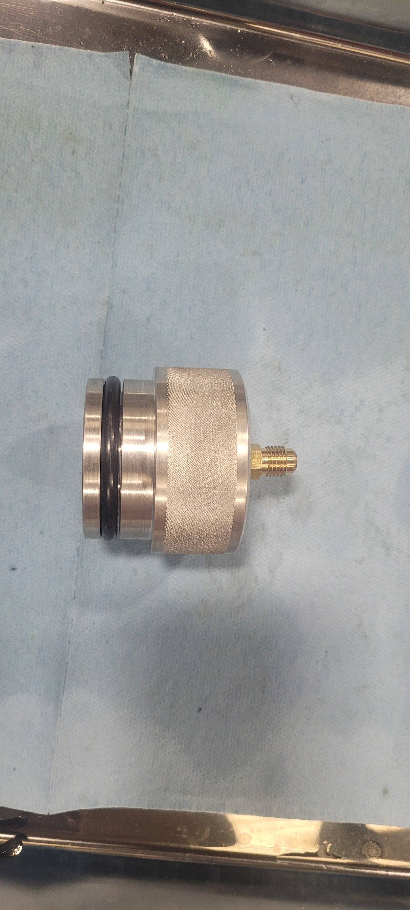

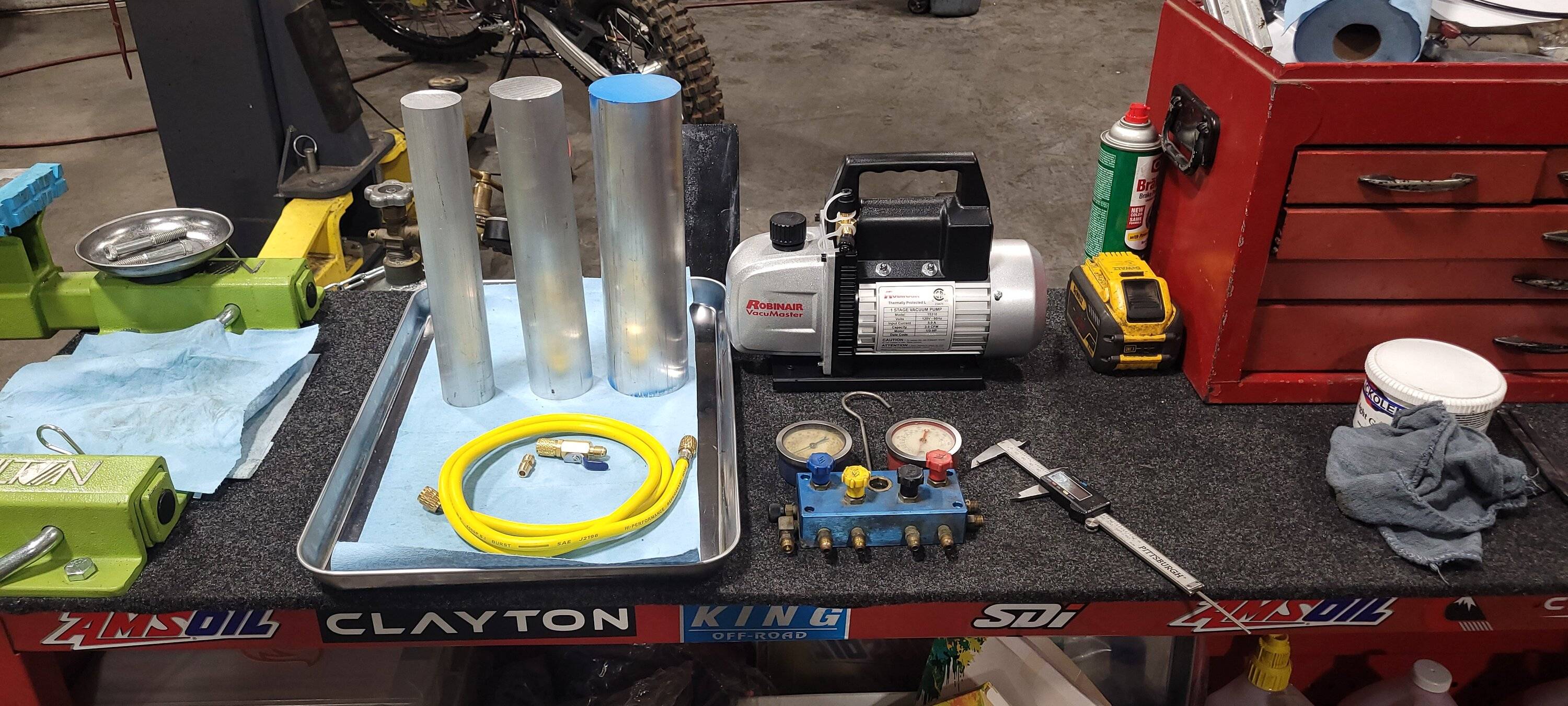

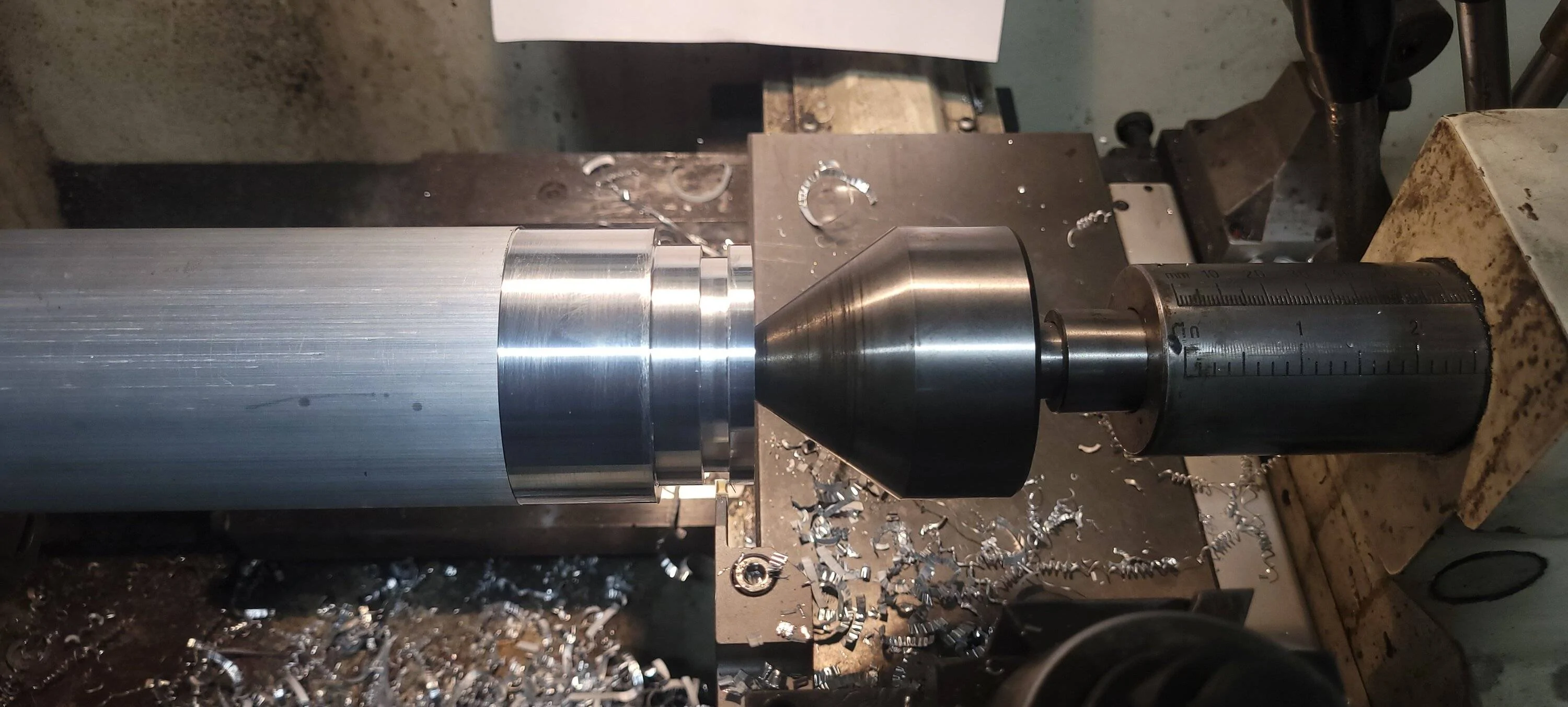

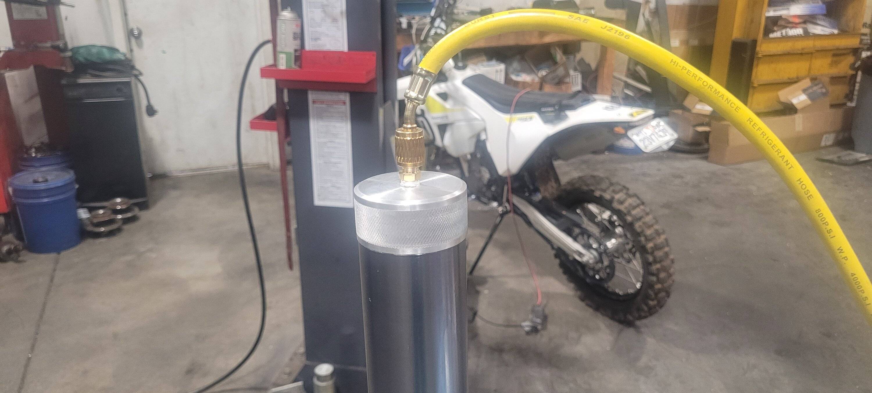

After seeing a few too many new shocks with air in them as delivered, took a look around the shop for stuff I could repurpose and make a list of supplies to aquire for the project.
This setup should make shock bleeding possibly quicker, but also to evacuate those pocket areas where air could hide.
Since I was opening my SDis up for a small change over the weekend, thought would take that opportunity to measure and manufacture a plug for those shocks first!
This is my first start to finish lathe project since highskool over 30 years ago? It wasn't a terribly difficult project, but required a little bit of skill that came back to me. Gotta maybe look into a better knurling tool........

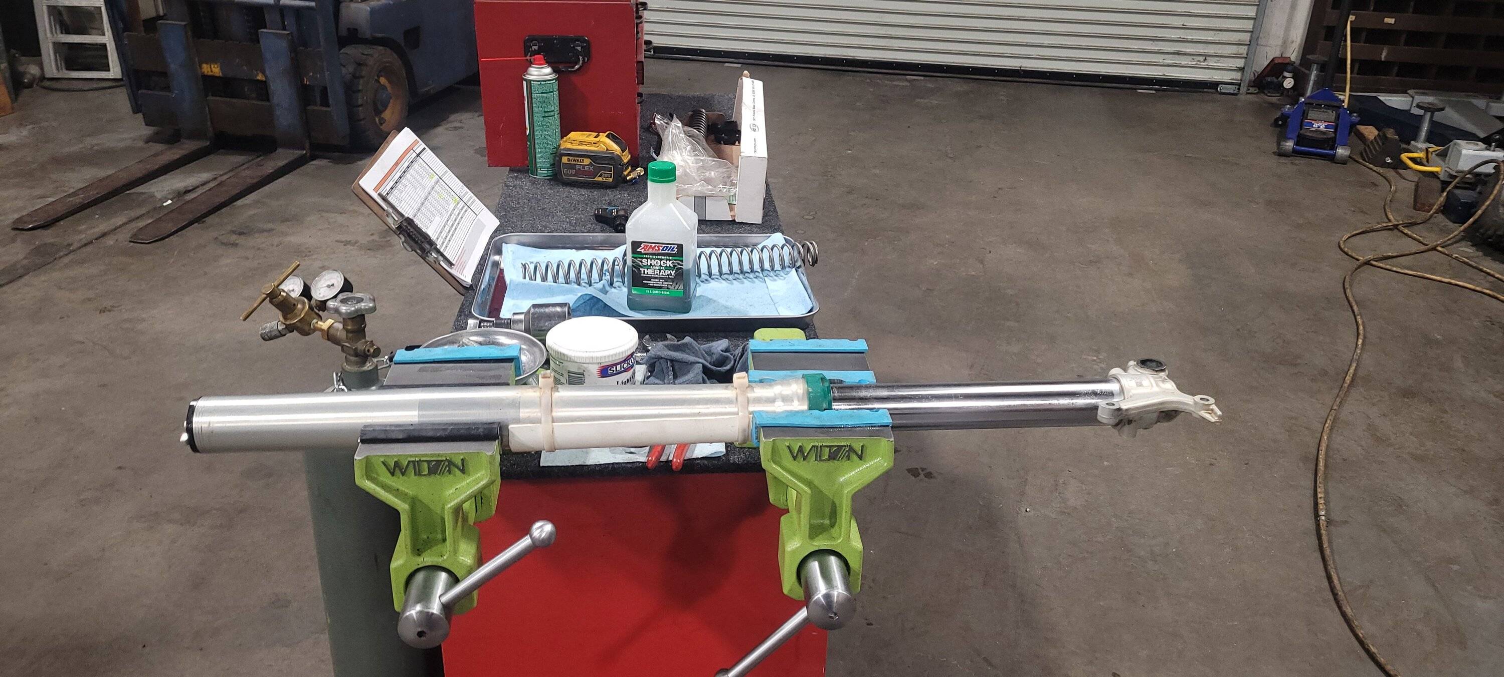

You may have spotted the next victim in the background........2019 Husqvarna FE501. It came to me terribly oversprung for even my 240lb self. WIth the preload adjusters back full out, the sag wasn't even close to low enough. I found it pretty much unridable and unsafe as I started to make some clicker adjustments. The rebound and compression on the forks maxed out yet still bottoming and bouncing up after the bottoming. I took it out for a 35 mile single track ride on Sunday, but it was pretty rough.....
Luckily the bike came with the stock springs, so I swapped out one of the fork springs to give me a combined rate of .480. Dumped out all of the fork oil and started with a fresh 5W Amsoil fluid with the oil levels maxed out so that I would have a good starting point before I tear into these further. At least I have some adjustment left over either way so that I can ride it for a bit.

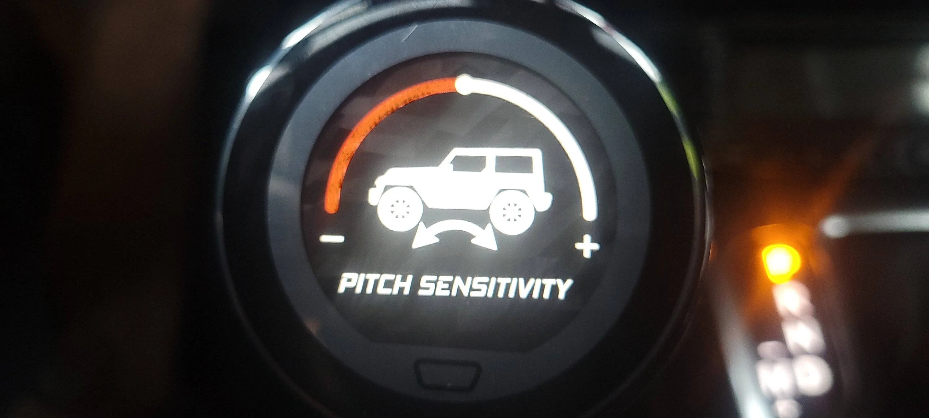

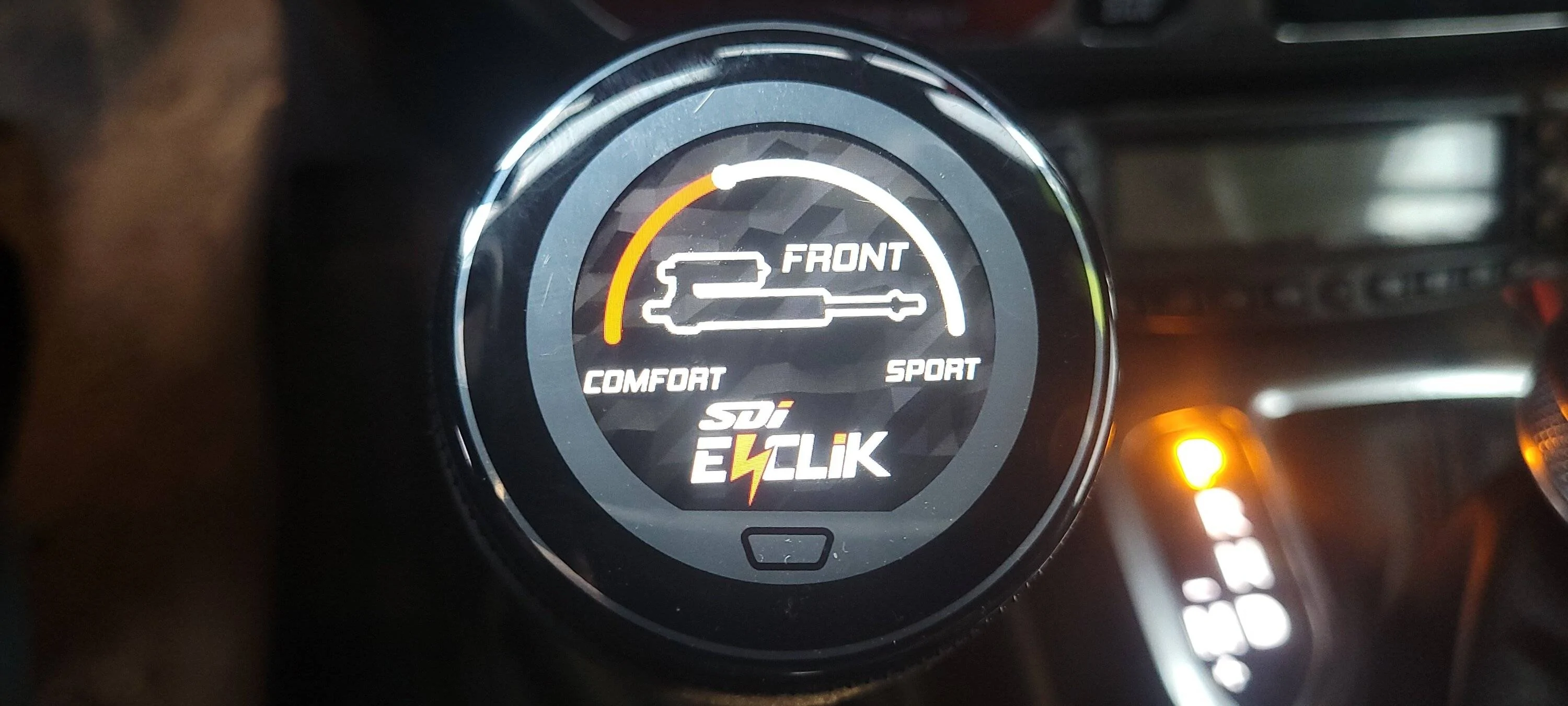

The first client to try this system out with my tuning dropped his JT off yesterday for the install of a Clayton 2.5" Overland Plus system w/ HD rear springs, SDi E-Clik Pro Shocks, 37" M/T AT's, Method 17x8.5" 4.75BS wheels, and a few other supporting goodies......He opted for the 1"+ front clevis and extended rear brake hoses so that I could set the shock's seal head clips to max out both front and rear articulation. We started out having him drive my truck around the general area over sections of road that annoy me, a rough potholed dirt road, an empty lanscape planter with square curbs, a sunken electrical vault hole, and a nice drainage dip in at the edge of our parking lot that makes a stock diesel JT slam the bumps perfectly every time! We then switched to his truck trying to duplicate the same speeds/conditions if possible (The drainage bump for sure and most other off road obstacles were done MUCH slower in his truck for obvious reasons). We played with different settings along the way and I think overall he was impressed.......but who wouldn't be after driving a stock Rubi with an Alu-Cab for almost a year? He plans to do a complete review of the job, so look for that in the near future.

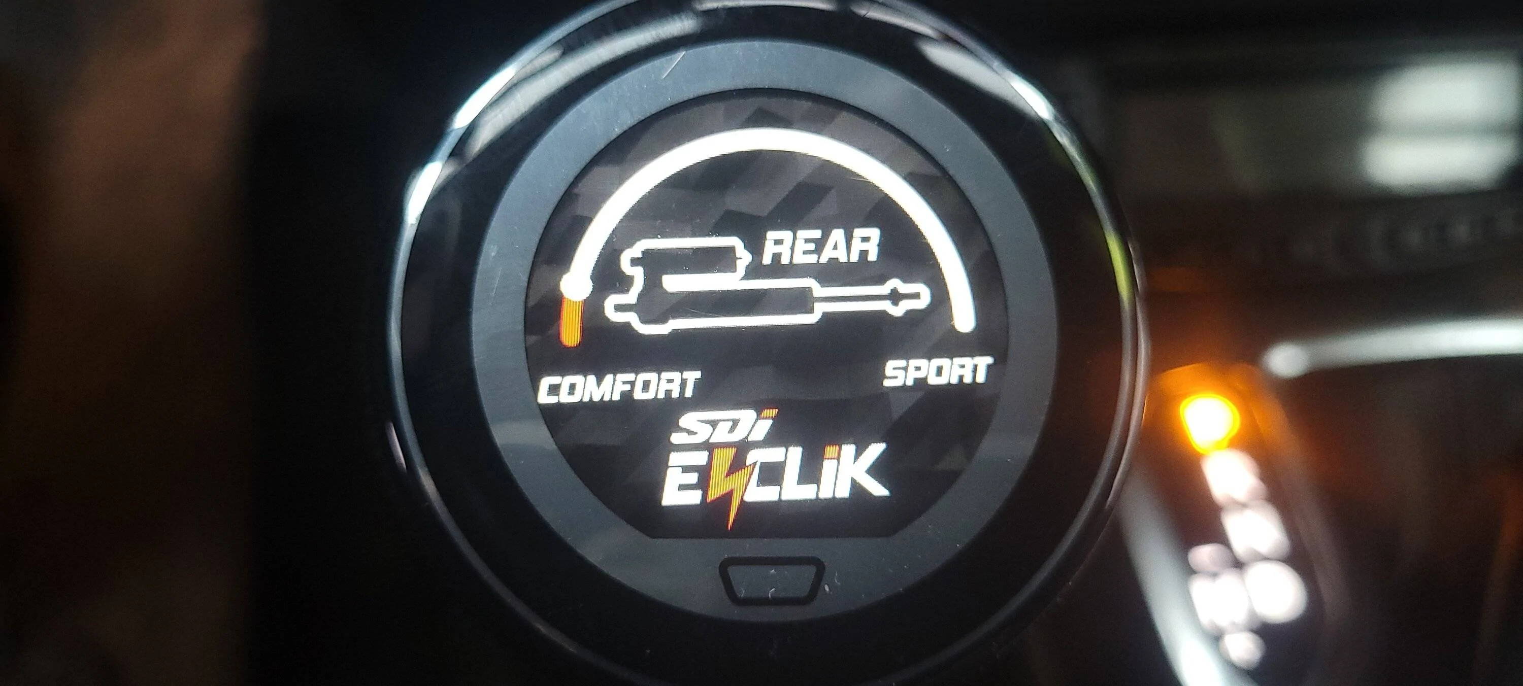

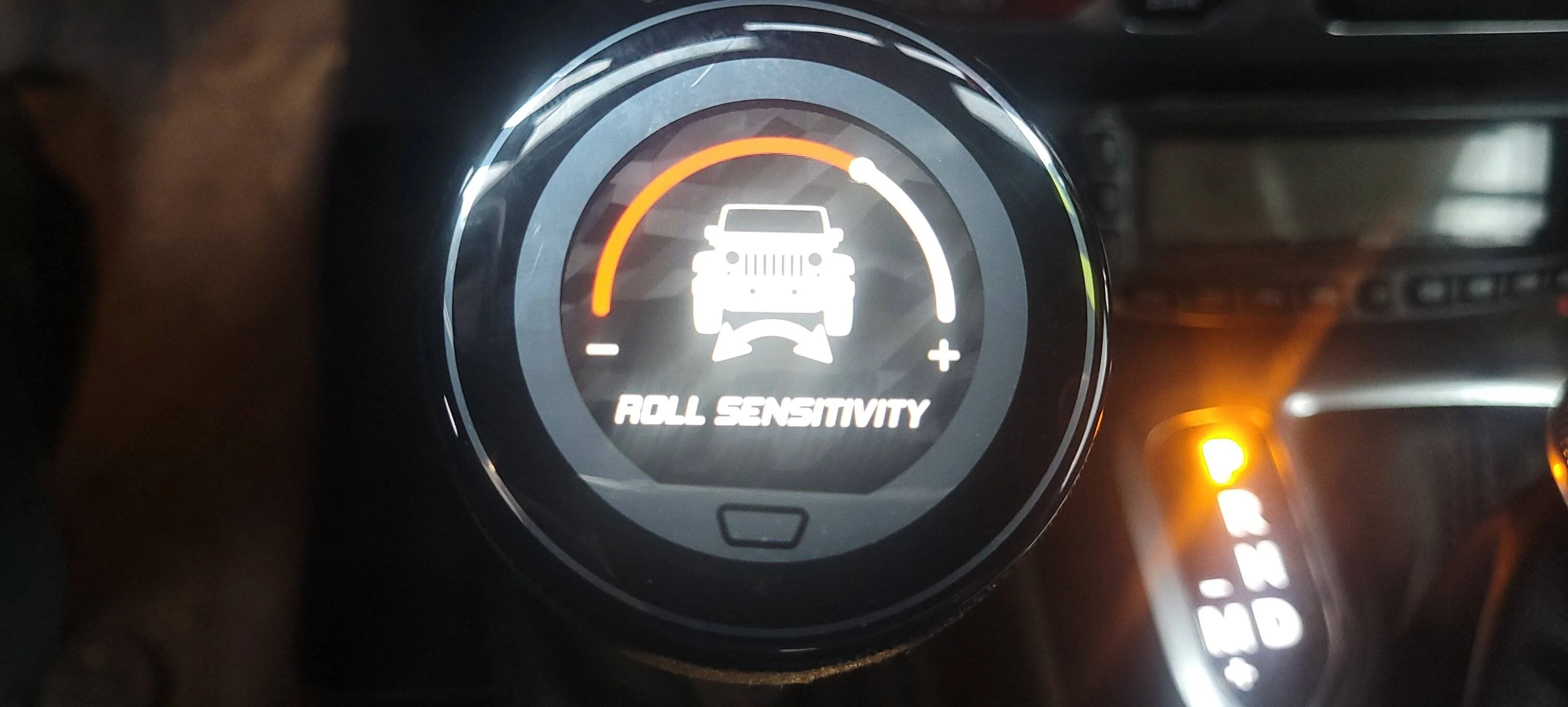

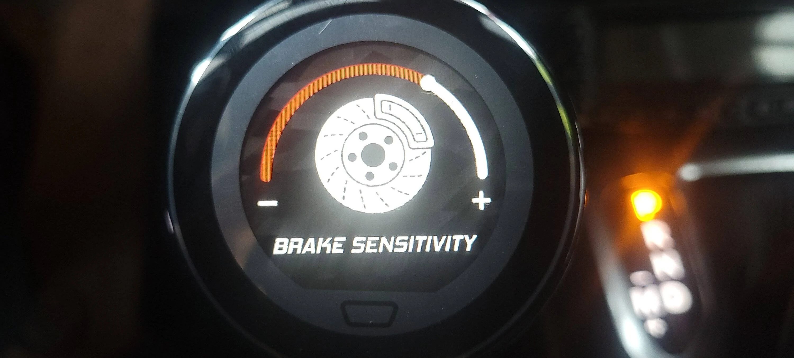

Hi all, I have been working with Tony about installing the SDi E-clik system with his custom tune since October.
In short, I highly recommend this package for all vehicles especially if it exceeds the GVWR or camp setup with a high center of gravity like the Alu-Cab Canopy Camper. The SDi E-clik adaptive dampers is a fantastic product, but not designed for the Gladiator let alone with the diesel engine. Thanks to Tony’s tune, it has transformed the Gladiator into a canyon carver and a compliant overloaded overlander in one package.
I see this as in investment, pay once, cry once, knowing that the suspension will grow with me as an overlander. The cost of this project was not cheap, but this project has added tremendous value and well worth every penny.
My full review can be found on my build page. I'll have a my Mojave trip report ready by the weekend.
