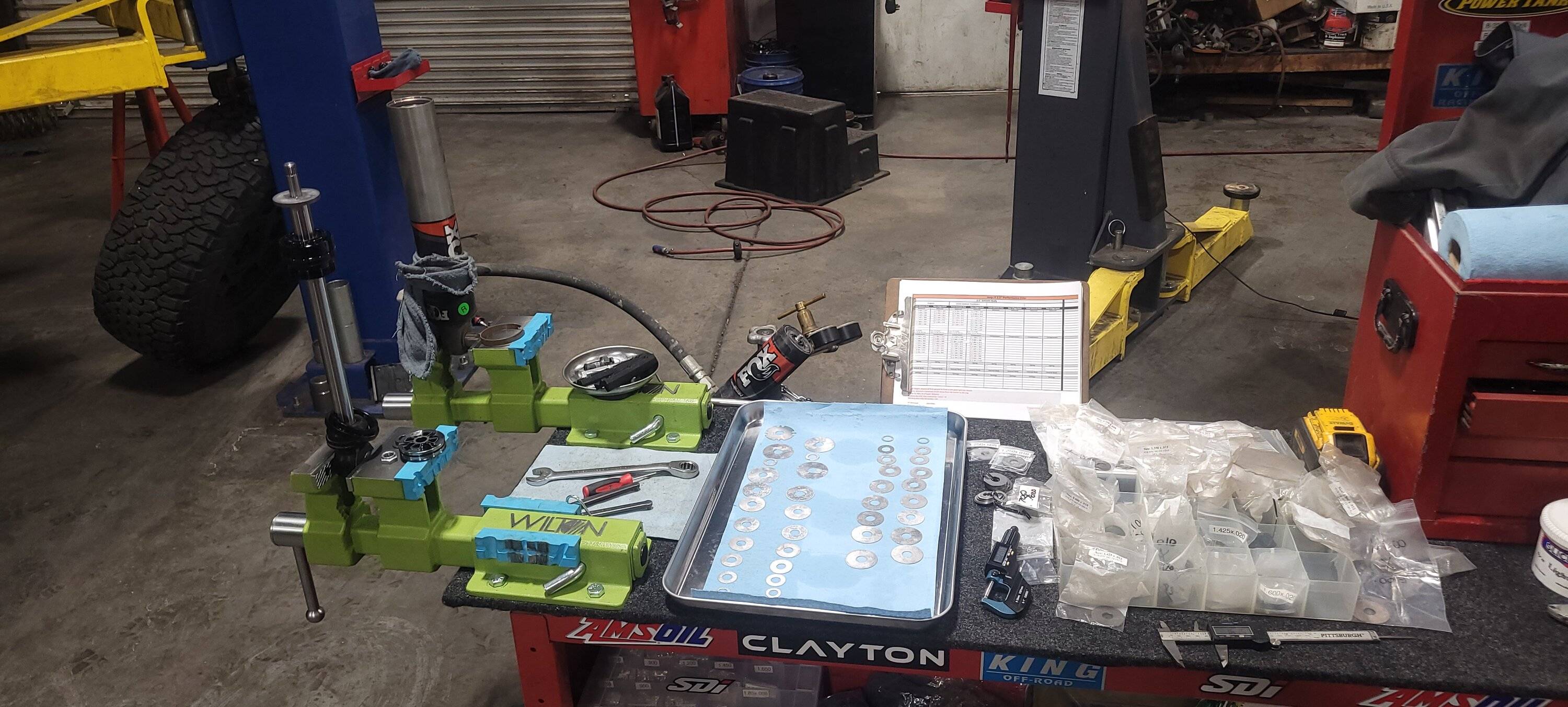

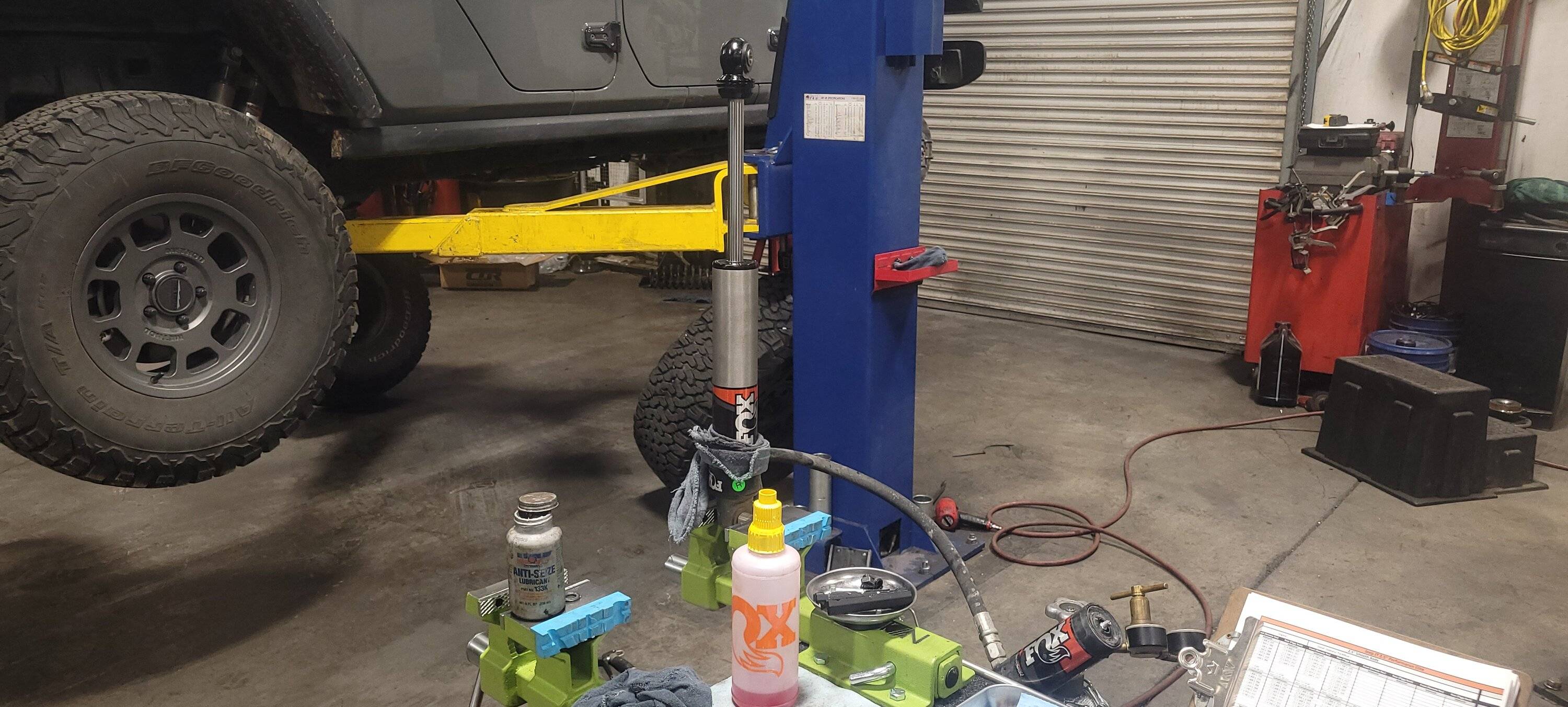

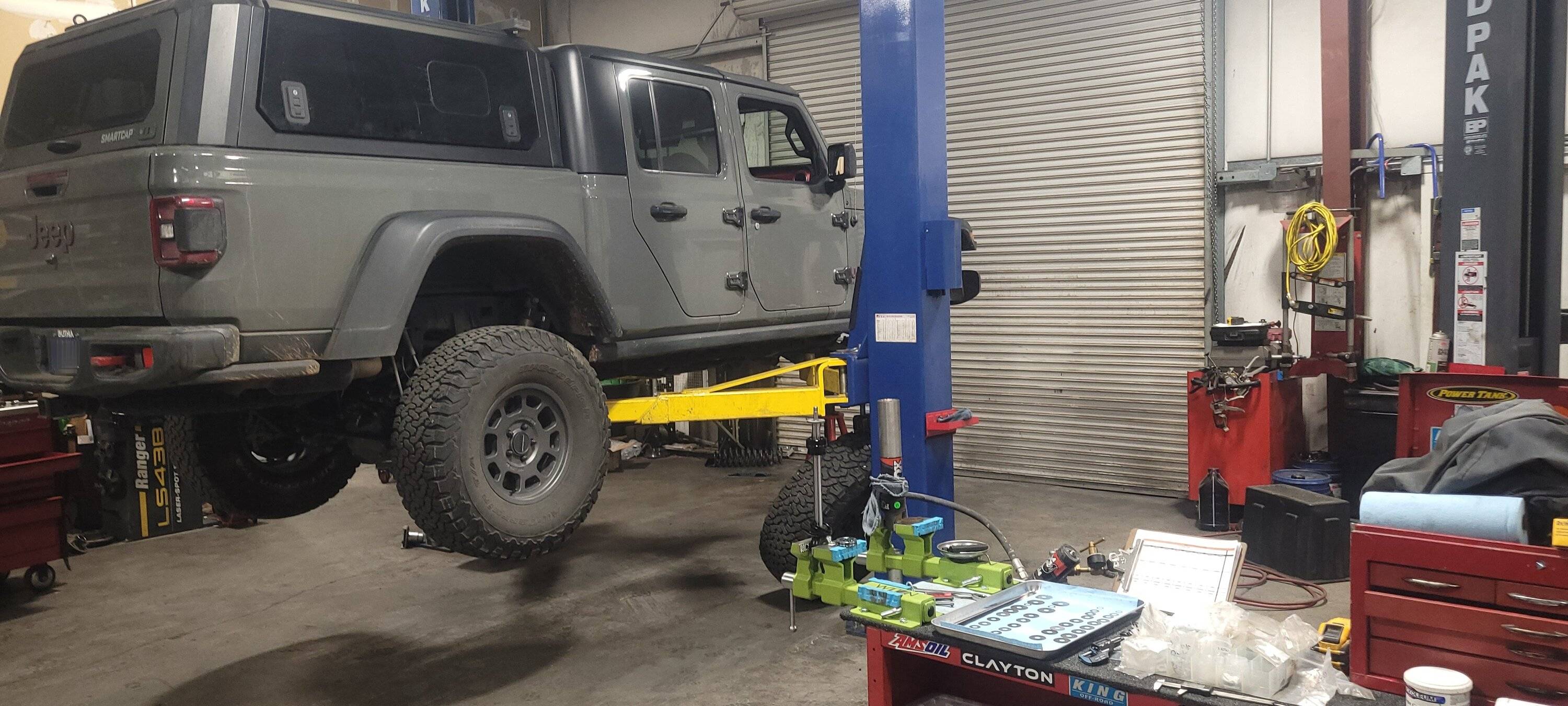

Some more progress this weekend.......A bunch more comfort on the rough paved roads, small off road chop, and heavy tongue weight towing areas without giving up being able to take a harder hit!
Overall the tune is now softer in all areas (Low, mid, and especially high shaft speeds), but I was able to turn up the "roll, brake, and turn" sensitivity settings in the "pro menu" to reduce body roll and brake dive while driving aggressively yet still maintaining the current comfort settings (Front: 40% Rear: 10%) for that nice strait line highway drive. This leaves head room for the driver to turn down a couple of clicks for more comfort if unloaded or turn up as needed for a load added and also turn up the "load" setting in the pro menu. IF SDi will just give us Jeep guys "BAJA MODE"! Not all of us are rock crawlers........
Jeep Gladiator Reaching out to those doing their own shock tuning? 20221211_155631
Jeep Gladiator Reaching out to those doing their own shock tuning? 20221211_155637
Jeep Gladiator Reaching out to those doing their own shock tuning? 20221211_155712
Jeep Gladiator Reaching out to those doing their own shock tuning? 20221211_155729
Jeep Gladiator Reaching out to those doing their own shock tuning? 20221211_155739
Jeep Gladiator Reaching out to those doing their own shock tuning? 20221211_155747
Jeep Gladiator Reaching out to those doing their own shock tuning? 20221211_160126
Videos at the "test spot" don't show a huge improvement over the last time, but I can tell you trail speeds have increased by at least 30% with more comfort and less bump use over Thursday and Saturday's tests.......Today I let a couple in a YXZ go ahead so that I wouldn't be hold them up, but within a mile they were pulling over to let me pass! Obviously the driver wasn't all that skilled or a huge clunky Jeep pickup wouldn't be running them down, but some dirt cred right here!
I'm still playing with that rear rebound........Maybe we're stuck with the rear tires hopping a little bit in order to control that extra 10% spring rate the Clayton HD rear spring added? I have few more ideas to try before accepting what is......That darn dyno couldn't be more useful in saving time about now...... I've logged over 400 miles in the truck in the past 4 days testing.......
I also located a set of front shock spacers I had kicking around upstairs for the front axle. I now have gained 2" more down travel and have brought the shock's front bump zone into play. After this tune is done, I intend to order the +1" or +2" clevis and install the outboard shock mounts which I envision will give me two diferent "bump stop heights". I will use the shock's bump for when I'm full twisted up keeping the 38's out of the fenders, but will use the bumps in the OE position set a bit higher so that I get more travel when the wheels are strait ahead. I figure the tires can travel into the fender farther when strait than turned? Following me here? 9.5" travel twisted, but 10.5" for those hits in the desert?
The first client to try this system out with my tuning dropped his JT off yesterday for the install of a Clayton 2.5" Overland Plus system w/ HD rear springs, SDi E-Clik Pro Shocks, 37" M/T AT's, Method 17x8.5" 4.75BS wheels, and a few other supporting goodies......He opted for the 1"+ front clevis and extended rear brake hoses so that I could set the shock's seal head clips to max out both front and rear articulation. We started out having him drive my truck around the general area over sections of road that annoy me, a rough potholed dirt road, an empty lanscape planter with square curbs, a sunken electrical vault hole, and a nice drainage dip in at the edge of our parking lot that makes a stock diesel JT slam the bumps perfectly every time! We then switched to his truck trying to duplicate the same speeds/conditions if possible (The drainage bump for sure and most other off road obstacles were done MUCH slower in his truck for obvious reasons). We played with different settings along the way and I think overall he was impressed.......but who wouldn't be after driving a stock Rubi with an Alu-Cab for almost a year? He plans to do a complete review of the job, so look for that in the near future.

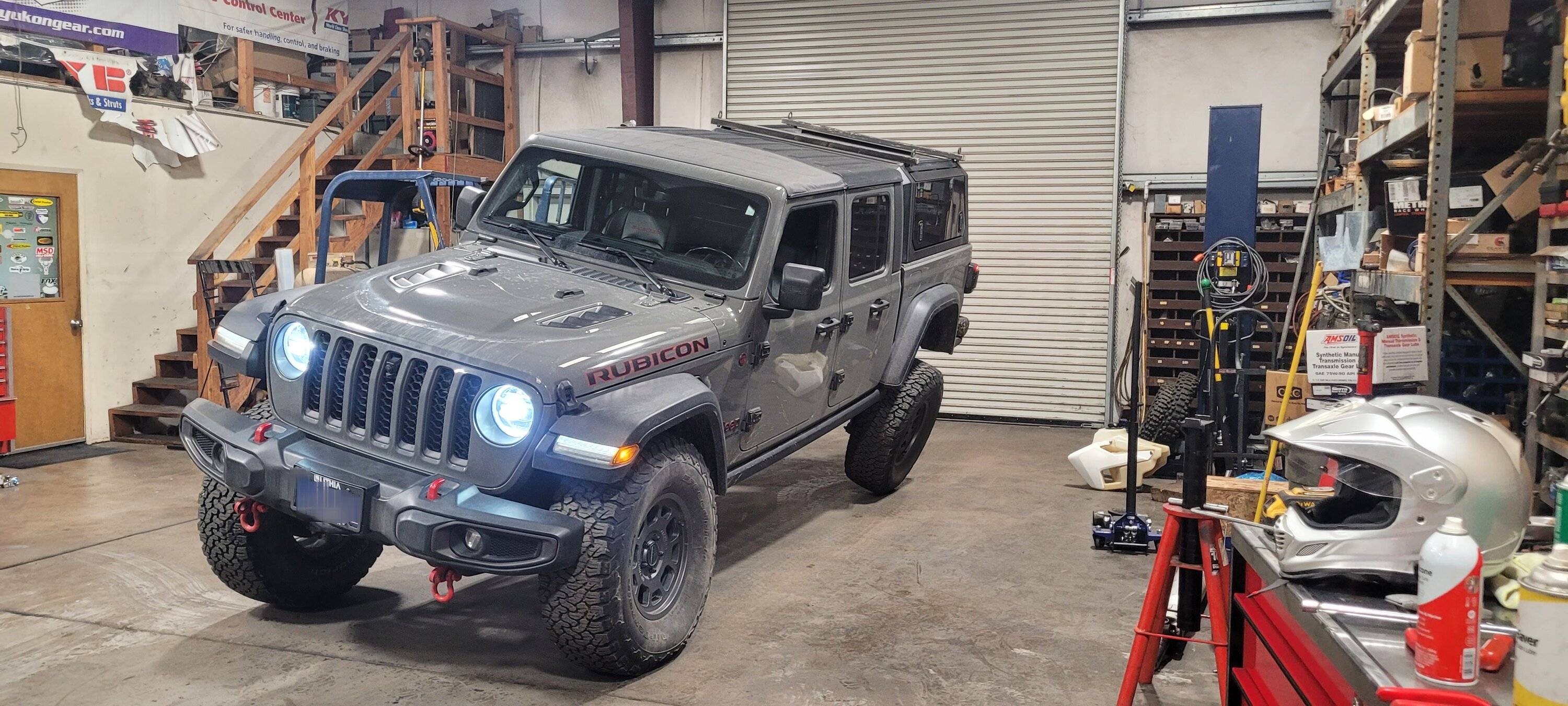

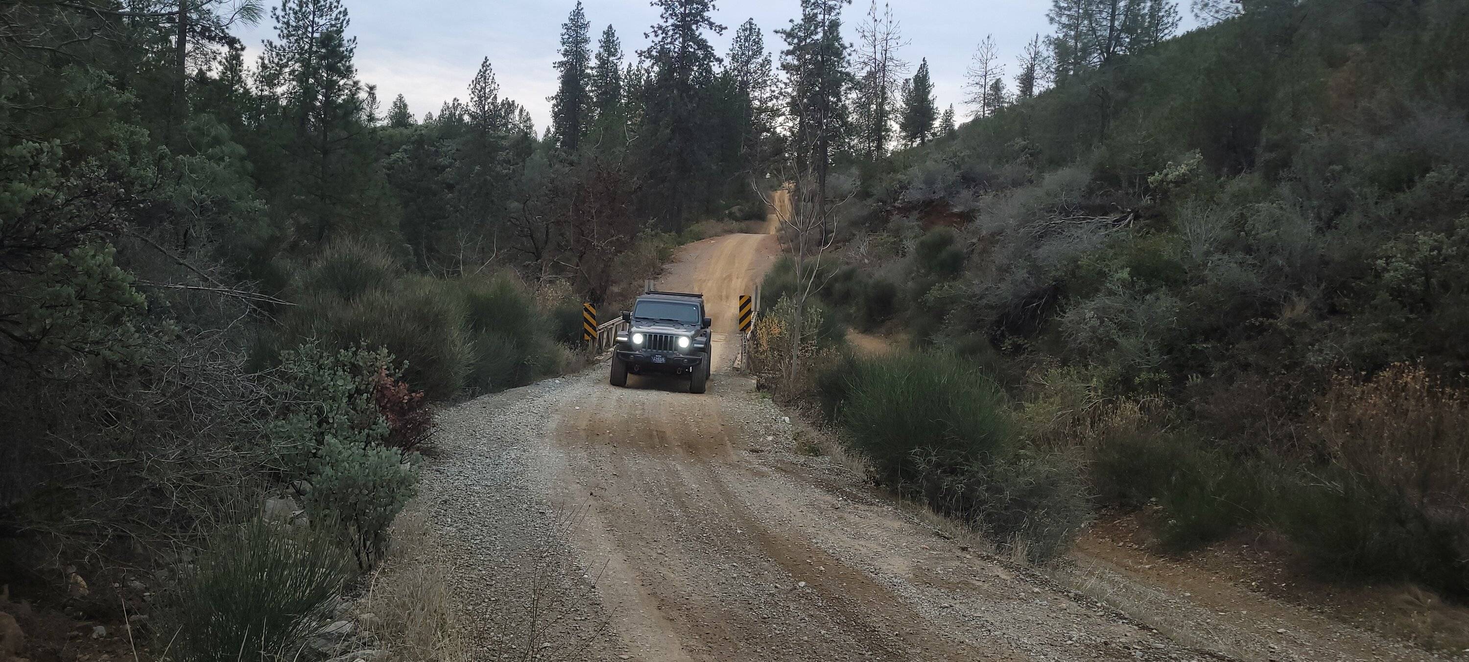

Well I finally found one of you suckers to pay me for a Fox 2.5" tune......Sorry it had to be you @PackMule!
A little tweaking of the front bump spacers for a 1.75" gain in up travel, dynamic balance the front tires to smooth out the rest of his long trip, swap out the diesel springs to the gas 3.5 Clayton's, and re-valve the shocks with a little twist on the front rebound for the lighter springs.
Dean "smashed" the test "drainage dip" like an absolute animal much to my surprise, but we couldn't hear the King air bumps contact? He tried it again and the JT just took it like a champ! Wish it was still daylight for a video of that!
Felt just like my truck! He says he doesn't drive fast, but I have a feeling he will be driving faster without knowing after these mods!

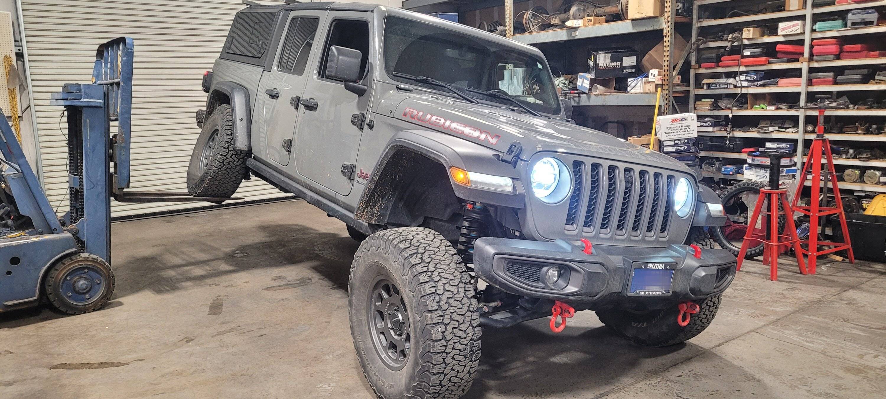

Little testing before departure this morning. Dean was sandbagging me last night........He drives at a pretty good pace!
No jump videos.....I recommend we skip that since he was in "Tow mode" with the Sumos installed.

Yup, and I didn't have time before the run to re-check all the mounting bolts for my Smart Cap to make sure I didn't loose it on the run! But good fun. I think I did get a little air on one of the double whoops.
Great run today Tony! And then pretty solid trailer haul afterward. I ran from Redding to about an hour south of Reno today pulling my camper trailer, and the tune worked really well.
Its great now to be able to have a tune on the Fox's where I'm only at a couple clicks for normal driving, a couple more clicks for trail running, and a couple more after that for pulling the trailer! Now I feel I have the dynamic range on adjustments to really utilize these shocks like they were meant to be, and exploit the full versatility of the Gladiator platform!
