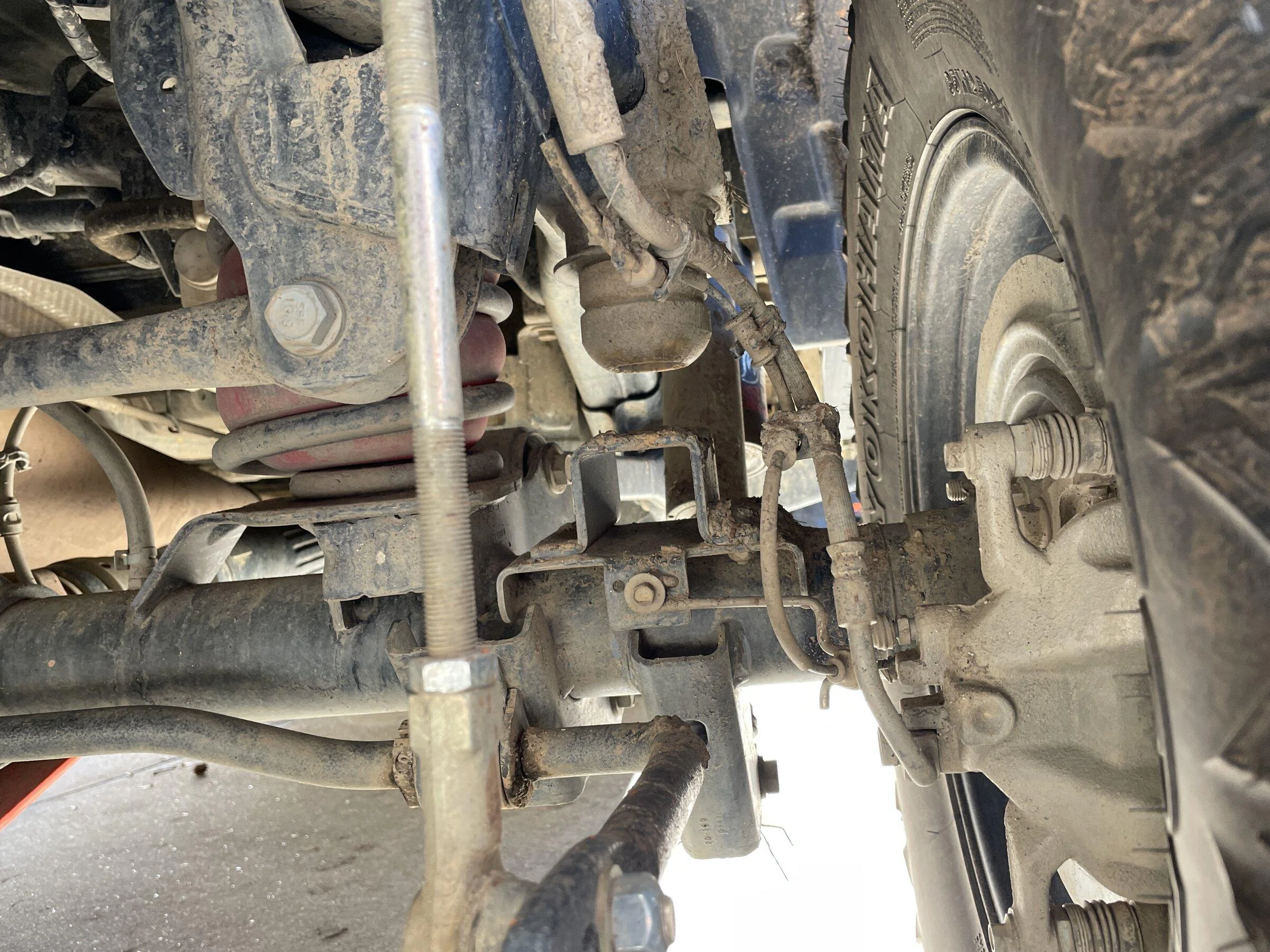

Yes, the Mojave has the same fenders as the rubicon. Here is a picture of my rear end. There is not an additional axle pad between the OEM one and the bump cushion? I guess need to look at a stock jeep, bit should there not be a gap? What are the implications of this?

Yes, not a lot of gap there. Looks like a 2-3" spacer. How much shock shaft do you have showing?
Might be able to ditch the spacer and pop in one of these. Hard tell exactly what the height is, but the fronts are 1" taller. https://metalcloak.com/jt-gladiator-upper-rear-durospring.html

I was literally just looking for Mojave frame differences as I'm swapping messages with Glamisfan about what has caused the few posted JT frames to bend right in front of the shock mounts. Shocks too long? Shocks too rigid? Too much force placed on the hitch towing off road?
The pic and caption showed a reinforced bump stop bracket, but the actual jounce bumper looks just like mine. The front Durobumps are about 1" taller compressed, tapered, and the material is firmer.....overall just a more progressive stop. Mine worked great and in some ways, I liked them better than my air bumps.

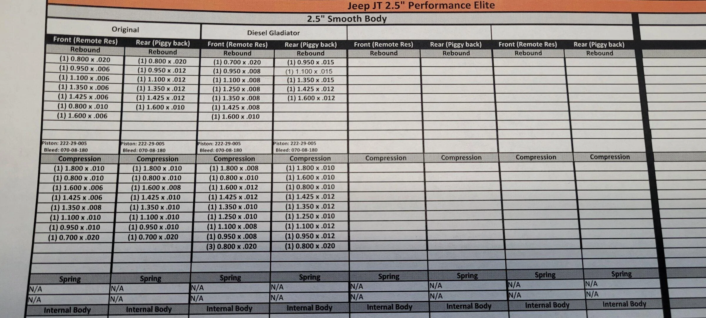

Here's when I ended up....I uploaded both the .pdf and took a pic.
Jeep Gladiator Reaching out to those doing their own shock tuning? Jeep Tune pic
Right now I feel the rear is good at the factory recommended 100psi, but feel the front needs more low/high speed compression, so I bumped the pressure up to 200psi and like it for now till I change the springs. Something else to keep in mind is that I like my vehicle to drive tight and controlled yet not beat me up as the speed increases. I HATE head bobble anytime as it hurts my neck after a day of that. If you want the 70's 7,000lb Caddy LaBomba boaty crop duster ride, this is not for you. The OEM or aftermarket Fox 2.0's you would probably like better.........

You can also fine tune the oil weight as a stop gap for dampening, while trying to stack shims. You probably already know oil weigh basically acts as full curve adjuster. Moving the whole damping curve up or down.
If you want more damping up front but like the current feed back, try a 10weight and see what that does for increasing damping. If it's to stiff try a 2.5 weight ect...
You mileage may vary but it will give you a quick way to build data points without having to pull the stack apart.
Just a thought....
Not sure you are doing any crossover stacks but I have been warned in the past (dirt bikes) about having to thin of a shims for cross over setups can beat up that shim cause premature wear. Cross over is interesting as it gives you plushness in the first stage and firmness beyond that stage.

Yes, I used oil weight to get better results on my YJ 5165 shocks where I couldn't or didn't think I could do the valving myself. I wanted like 10% more comp and 30-40% more rebound, but I ended up with too much comp and not enough rebound by replacing 30% of the 5w with 10w. You can guess where that project is probably heading after this ordeal?
In the case of the JT fronts, I'd likely end up with way too much rebound to get enough compression as close as it is right now. My original plan was to add some 10w to them before I got any reponse from Fox, the shim kit, and Glamis jumped in. This outcome is soooo much better.
it's all a balance game, when your compression and rebound adjustment wants are so un balanced then yes a oil weight won't help. Keep postimg, this has been a interesting thread. My RRD shocks are fully rebuildable which means shim games are possible.....
It's a funny thing once you start digging into these things they aren't that complicated and brand starts to mean little, and it's more about the materials used, easy of access and basic design of the components that matter. You start with a good foundation you can adjust from there. (mono tube shocks anyway, the by pass is another animal.)
I have a dirtbike rear shock with a sachs body and shaft, kyb piston and aftermarket adjuster, all parts and pieces as a means to get to a better result.
