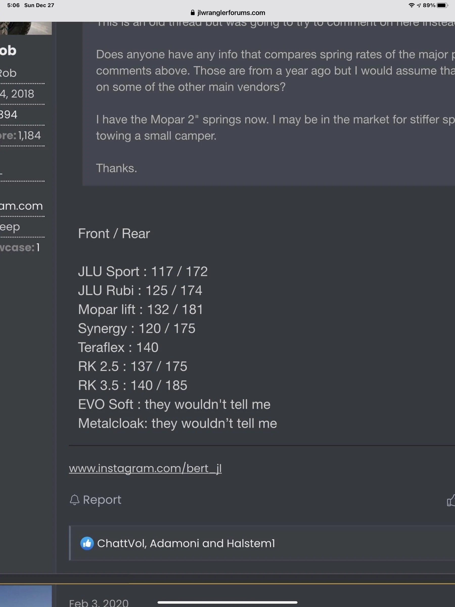

I think I saw spring rates mentioned earlier. This pic is referring to JL’s, but it gives you an idea of who publishes spring rates. I know Eibach gives them too, I even called them to ask about some.

We need a separate thread with spring rates, free length, and length at coil bind.
But I have no knowledge base to add right now for the JL/JT world.
I probably won’t be pulling my stock Mojave springs out for a while (maybe doing hydro bumps later).
I’ll poke around the JL sites and see if they have a start…

I'm still wondering what the OEM diesel JT front springs rate at? With that number and Evo's number I could make a choice right now.........So much for that!
