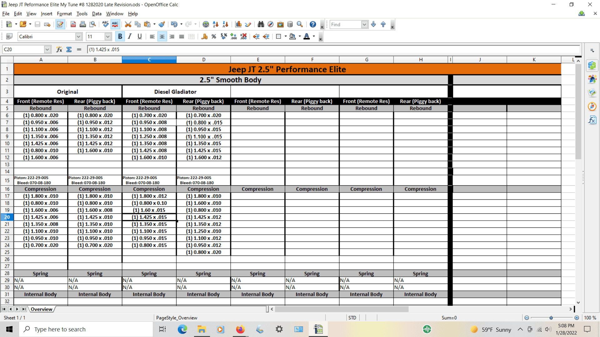

I just can't leave it alone knowing I can make it better......I think this is revision #8 and its the best it's ever been. Can't wait for the desert trip...........I'm hardly using the air bumps now!
I know this is all temporary until I get springs, but should be minor changes after that.......

Good to hear your having success!
If you don’t mind, about how much up travel do you have before you get into the air bump?
Also what’s your main strategy to get ride of the head bobble?
You are definitely stirring my interest in this

Post #71 has all the hard travel #s. 2.5/2.25 right now but want 1-1.5" taller springs to open the gap.
Obviously I'm far from a professional tuner, but think I have a pretty good handle on this about now.
Head bobble in my opinion is caused by two categories......1) Too soft springs and/or/combined with too little shock compression damping. 2) Too heavy spring and/or/combined with too little rebound damping.
Then you could add in anti-roll bar rates, tire air pressures, and air bag pressures.
The next thing I intend to add in is one of those JKS tunable sway bar links then I would disconnect for low speed rocks and run connected for fast desert/trail.
Head bobble in my opinion is caused by two categories......1) Too soft springs and/or/combined with too little shock compression valving. 2) Too heavy spring and/or/combined with too little rebound damping.
