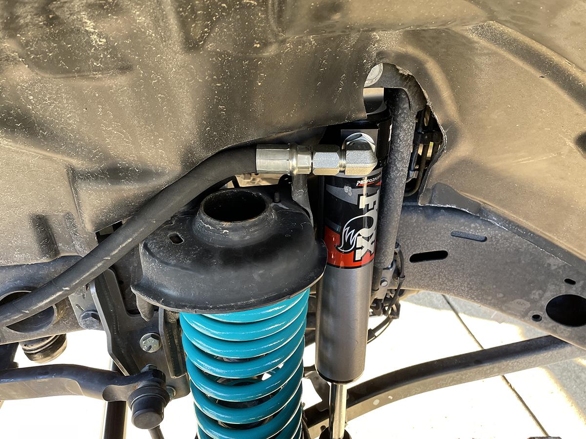

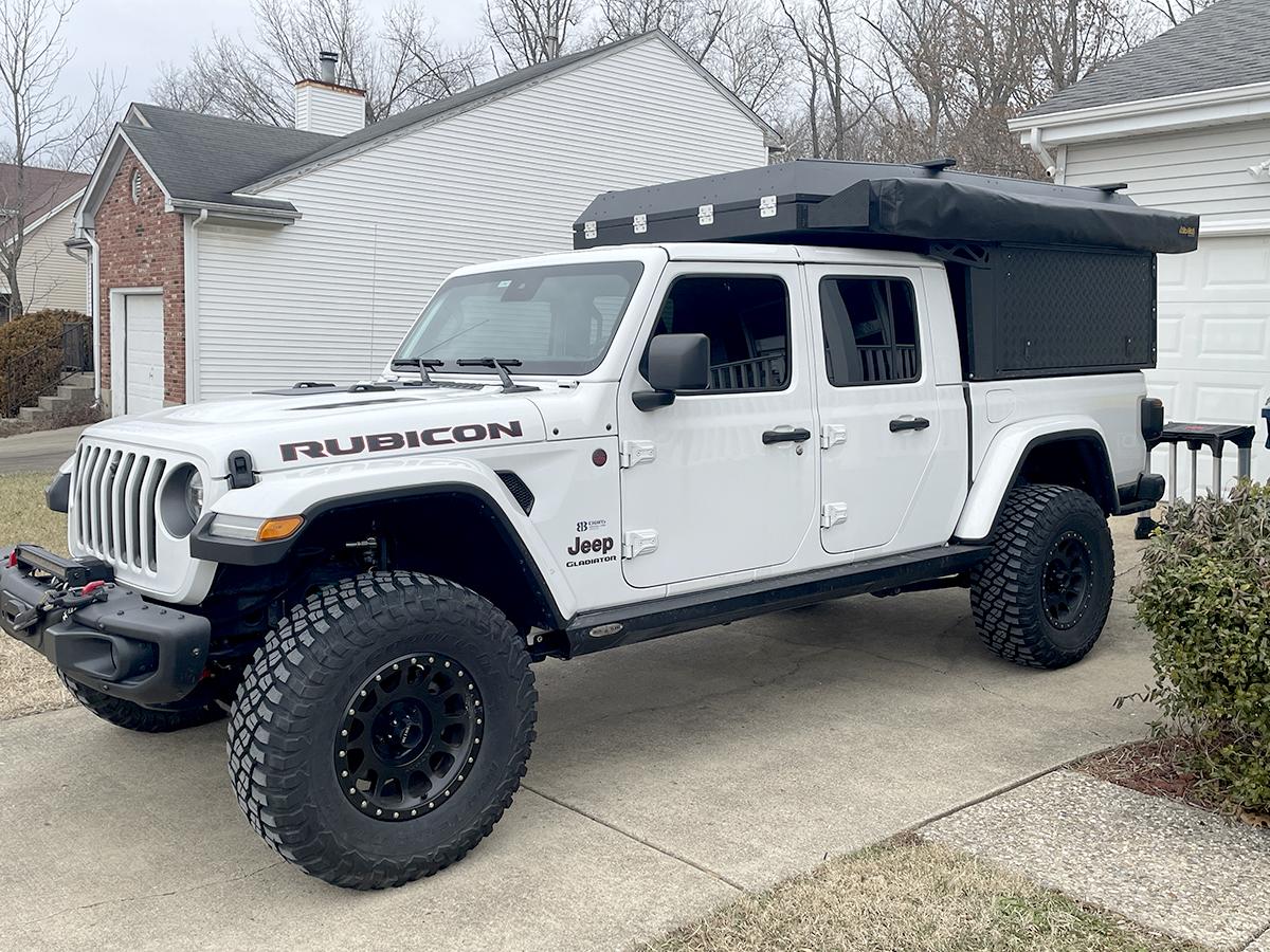

Thier heavy fronts (100-200lb extra) might be close for a stock diesel JT! I'm afraid with my Rockslide steps, Zeon winch and diesel, my trucks front axle could be 300-400 over a gas truck?

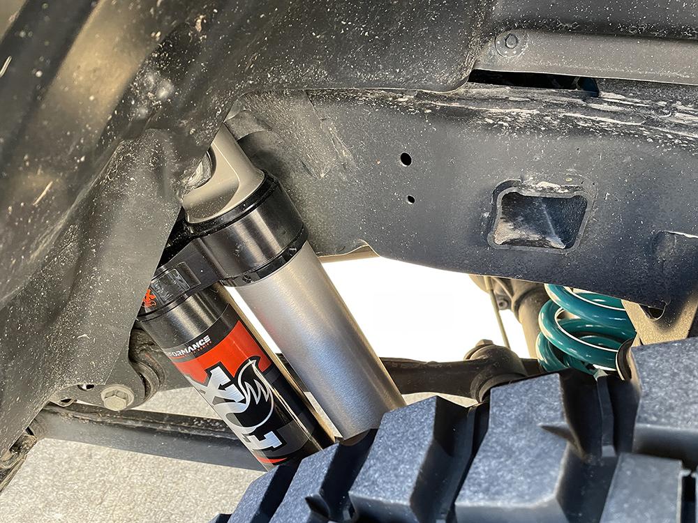

Yea, the 80's looking springs are not something I love but at least my company logo has blue in it and once I get my graphics on the truck they may match more :-D I have the ALu-Cab Canopy Camper, winch, Rockslide but I am a gasser. I had the Fox 2.5 shocks and Dobinson coils installed this week. A big improvement with body flex over the Mopar 2" lift shocks and springs. It has been really cold this week so everything squeaks a bit over speed bumps. I need to test the adjustment of the shocks and dial them in. I will probably get to that some next week. I need to get under and double check all the torque specs of the Steer Smarts items that were installed also.

1400+ mile overlanding trip to Death Valley in the books! Suspension performed well, but I have to get springs before the next trip......
As usual, the guys were irritated with my pace and one actually said he thought im driving wreckless. Pretty easy to average 3-5 mph faster in a sand wash and put big distance between us when your vehicle drives nice!
Made another change to the rear shocks this week....I think I've been into the shocks 10 times? Installed the JKS tunable links this weekend and Clayton springs are on the way.
