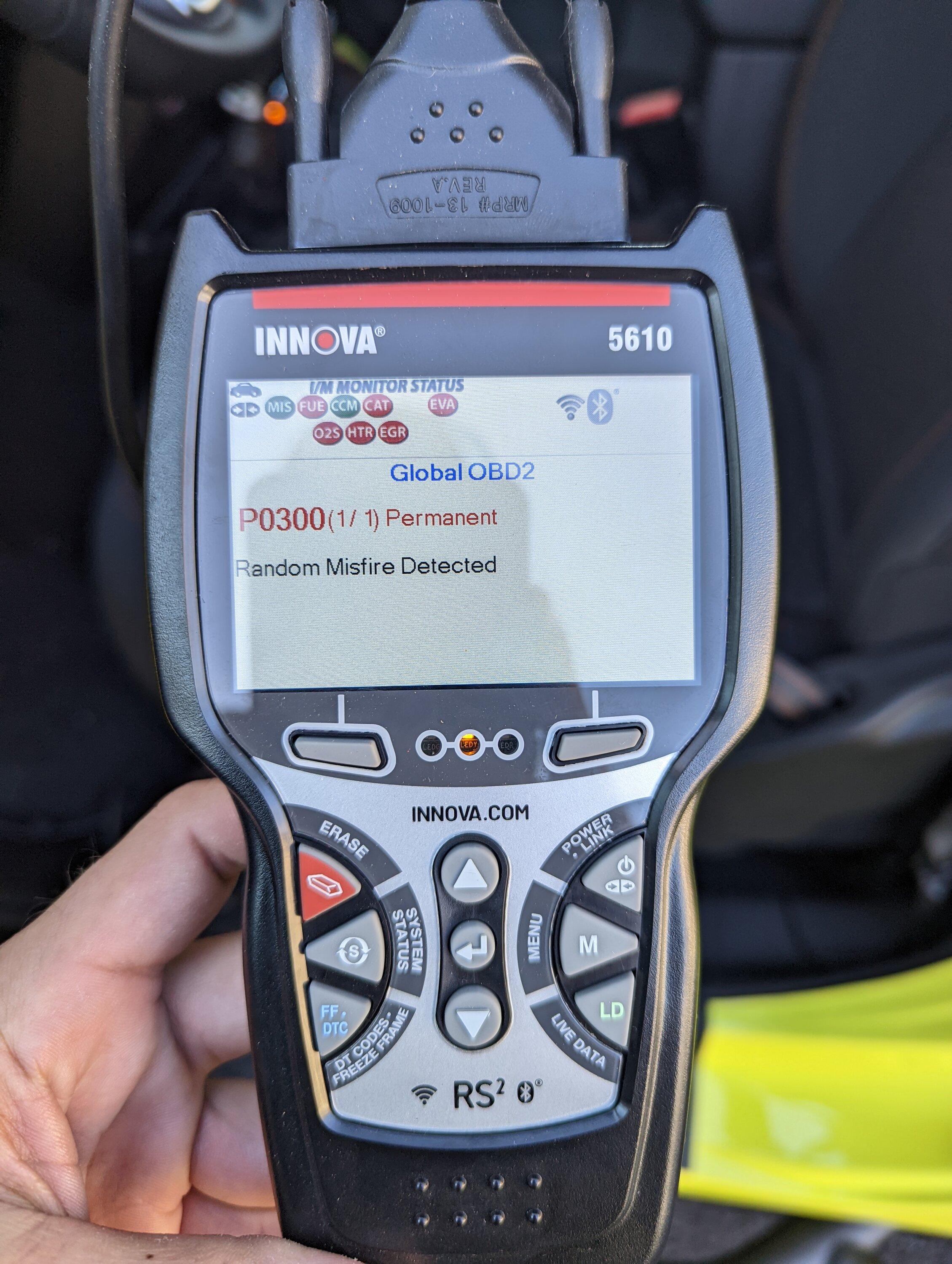

2600 miles on my previous gladiator. Took it in and the MF’er cleared itself waiting in line to drop it off. Same thing the two other times it occurred….the CEL cleared itself 500 feet from the service bay door. It’s like there’s a code clearing geo-fence on this thing….lol. Fourth time and with 6000 miles on the clock it messed up and threw a code while getting the oil changed.
The dealership fixed it by replacing plugs and flashing the PCM. Three weeks later I sold it and picked up an Overland diesel.

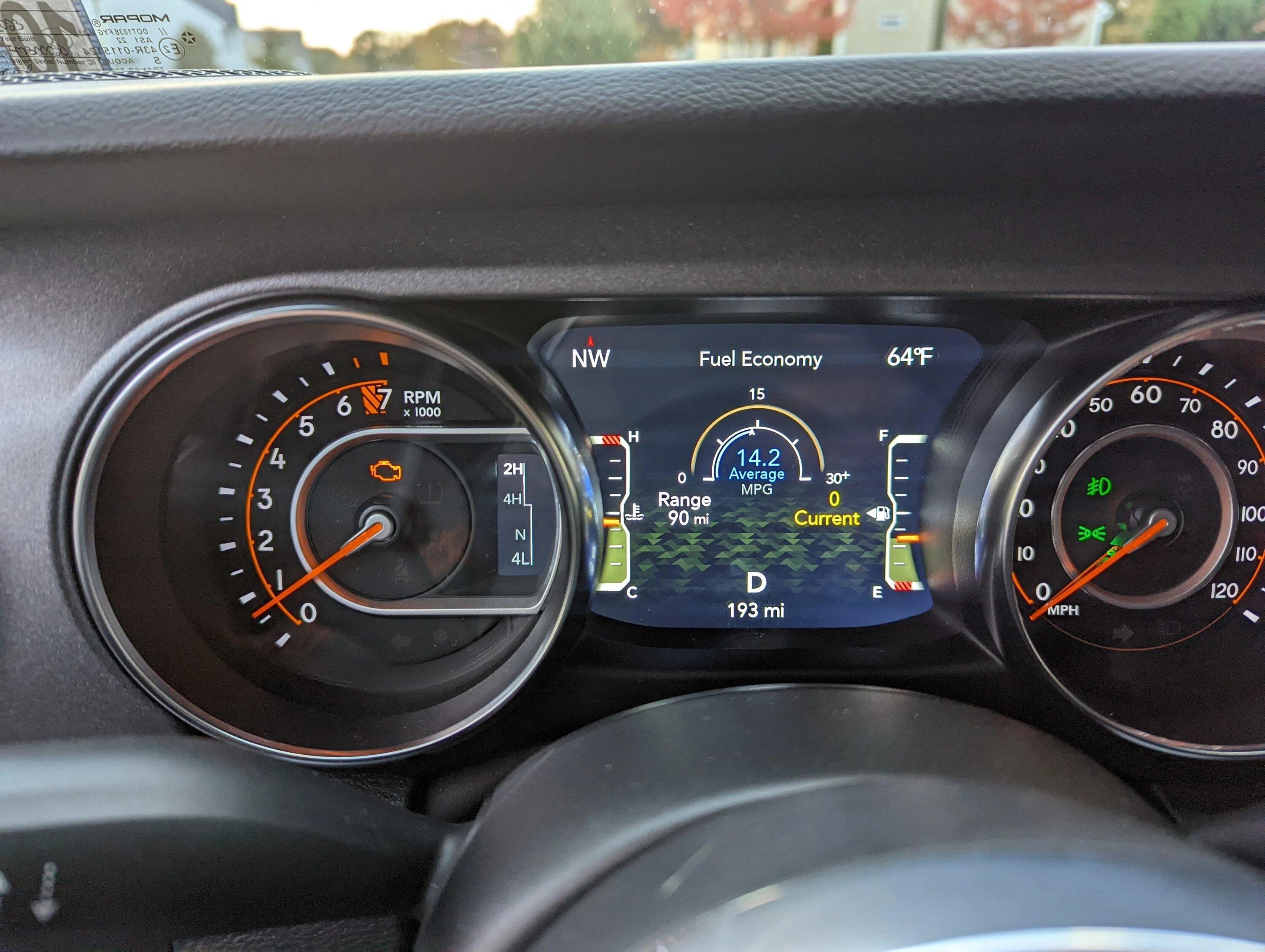

It was about 15 miles for us, driving down the highway after purchasing from the dealer. Truck abruptly limited itself to 40mph and was flashing the ETC. Very scary.
We took it back and was hard to replicate, they didn't do much. Happened one or two more times before I read something here and "pushed in" all the fuses -- never happened again.
Now we recently get the letter from Jeep saying that its a recall/service bulletin and to bring it in for a software flash. We were pioneers

I was picking mine up at the dealer and the guy pulled it in and left it running so I could check it out. I got in and noticed the CEL right away. They were pretty embarrassed and took it into the shop asap. It was a code for the DEF heater I think but it hasn't returned. See what happens this winter.

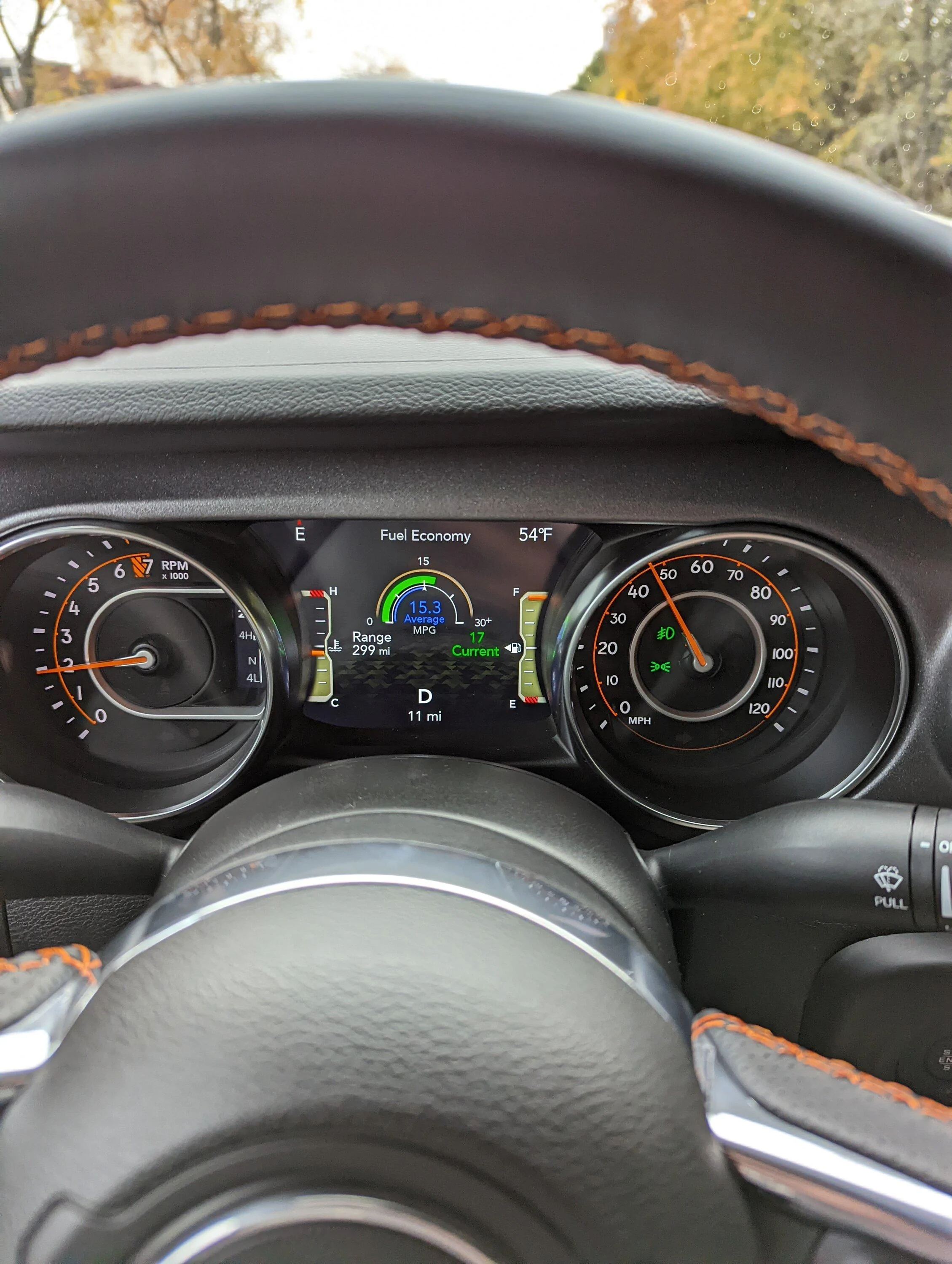

I picked up my brand new 2021 Mojave from the dealer and when I started it up there was a CEL. We were the last ones there since they were closing for the night. I got it home and put on my OBDII reader and it turns out it was the thermostat. Salesman said, no problem, we will get you a new thermostat.
A few weeks it comes in and they put it in. As I was waiting, I saw the tech taking it for a test drive. I strike up a conversation when he gets out and I ask if everything was good and he says “I shouldn’t tell you this, but there was no thermostat in there. Looks like they forgot to install it”
Lovely. Been running fine since then, good thing I bought it in Dec and it was pretty cold while I waited for the thermostat
40,480
53,965
Uh, seriously?
When you change the thermostat, you replace the whole housing. There's a spring and you have to push and compress the spring as you put the bolts in.
You can't leave the thermostat out as it's part of the housing.
And you'd bloody well know it if you were putting in a housing that was broken (missing the thermostat portion) because it is crazy in-your-face obvious. Someone in Mexico had a bit too much to drink that day.
