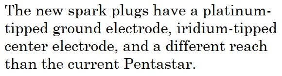

I never realized how touchy spark plugs could be until recently. I changed the plugs in our Forester XT. One had a crack in the porcelain. Couldn't see it when I installed the plugs. I hit the gas to merge on to the freeway, the car shook like it was misfiring bad, and the dash lit up like a Christmas tree. Luckily it was cylinder #2 which is the easiest to replace on the FA20. The parts department exchanged it with no questions. Makes me wonder how common a crack in a spark plug is.
Not so much 30 years ago, but in the last decade, oh, yeah.
In fact to meet their goals, MOPAR had to spec different spark plugs - different type of plugs, for the revamped 3.6 in 2015.
Take a look at this from 2015 - seriously, a platinum-tipped ground electrode?
And all of the guys in the last century needed to worry about was - does it spark?
Jeep Gladiator Record for earliest or first CEL 1666892985060
The stresses they go through, how perfect the spark must be, the pressures and heat they operate under.....
