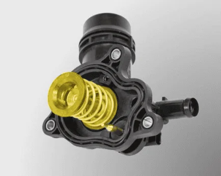

I picked up my brand new 2021 Mojave from the dealer and when I started it up there was a CEL. We were the last ones there since they were closing for the night. I got it home and put on my OBDII reader and it turns out it was the thermostat. Salesman said, no problem, we will get you a new thermostat.
A few weeks it comes in and they put it in. As I was waiting, I saw the tech taking it for a test drive. I strike up a conversation when he gets out and I ask if everything was good and he says “I shouldn’t tell you this, but there was no thermostat in there. Looks like they forgot to install it”
Lovely. Been running fine since then, good thing I bought it in Dec and it was pretty cold while I waited for the thermostat
Uh, seriously?
When you change the thermostat, you replace the whole housing. There's a spring and you have to push and compress the spring as you put the bolts in.
You can't leave the thermostat out as it's part of the housing.
And you'd bloody well know it if you were putting in a housing that was broken (missing the thermostat portion) because it is crazy in-your-face obvious. Someone in Mexico had a bit too much to drink that day.
Jeep Gladiator Record for earliest or first CEL 1667239688536
This is the "by the book" installation procedure -
During installation, press on the housing to
compress the spring until the fasteners
are snug to help ensure that the housing is
installed correctly
Actually, no, winter is a bad time to have no thermostat! The engine will run very cold for a long time - take forever to warm up.
You are better off having that screw-up in the summer when the stat is more likely to be open fast anyway.
BAAAD idea to have no thermostat in the winter! Harder on engine.

Uh, seriously?
installed correctly
