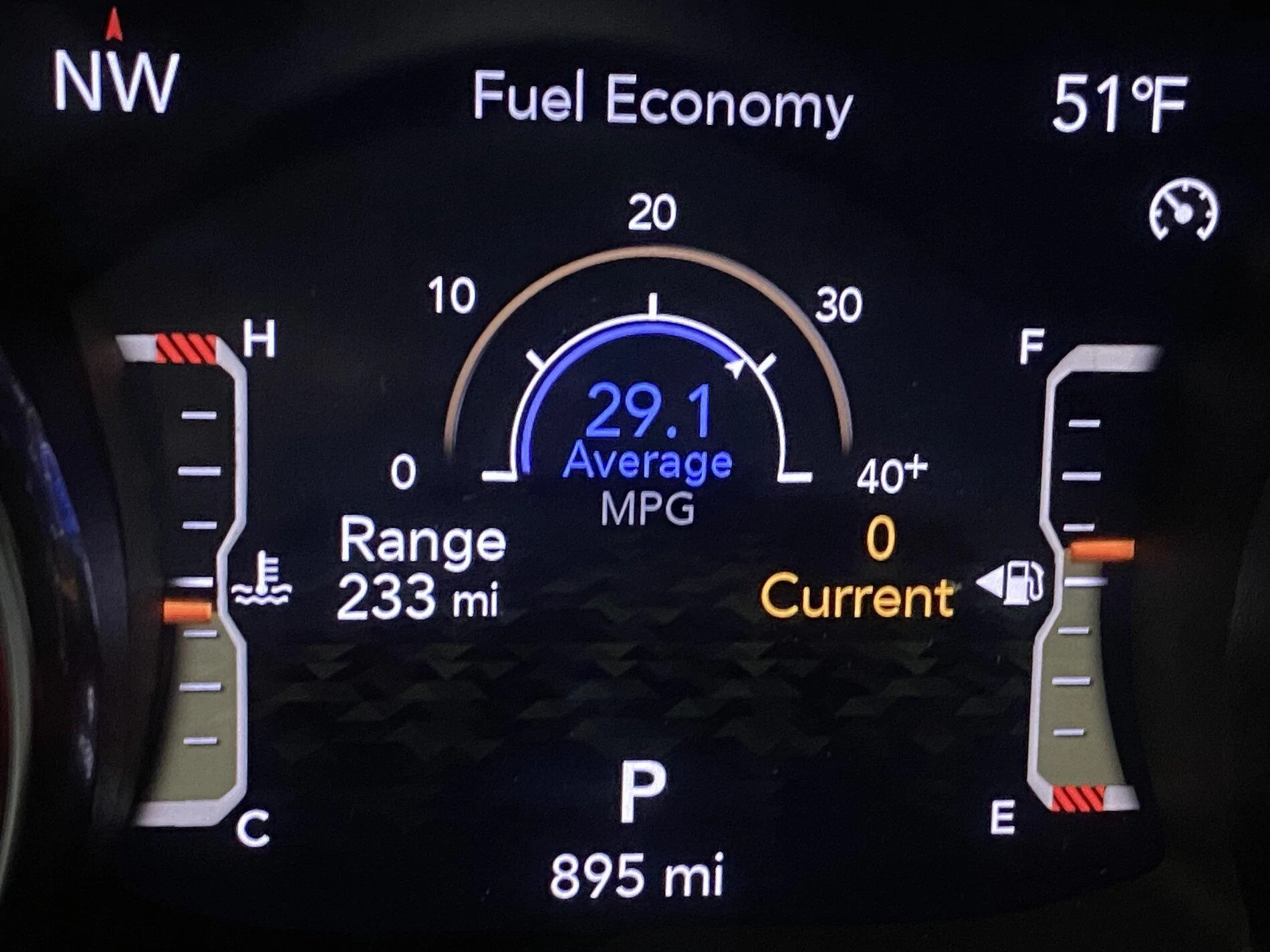

You are missing one of the most important part of fuel efficiency of which can not be changed on our trucks. If you have an identical powertrain and weight between the Gladiator and Ram the ram will get better mileage because its not a brick in the wind.
Not sure what everyone else is getting, but Saturday driving from Jacksonsonville to Gainesville, FL after getting the bed sprayed…I got the following on an engine with less than 1.000 in the odometer…
That’s impressive, but I take it stock 33’s + Florida really helps!
I have 37’s in Nevada, still get 22 highway though!
True. I done expect mine will remain in its current form for long. I suspect the 29’s will be a thing of the past for sure…but far better than if it were the 3.6.
