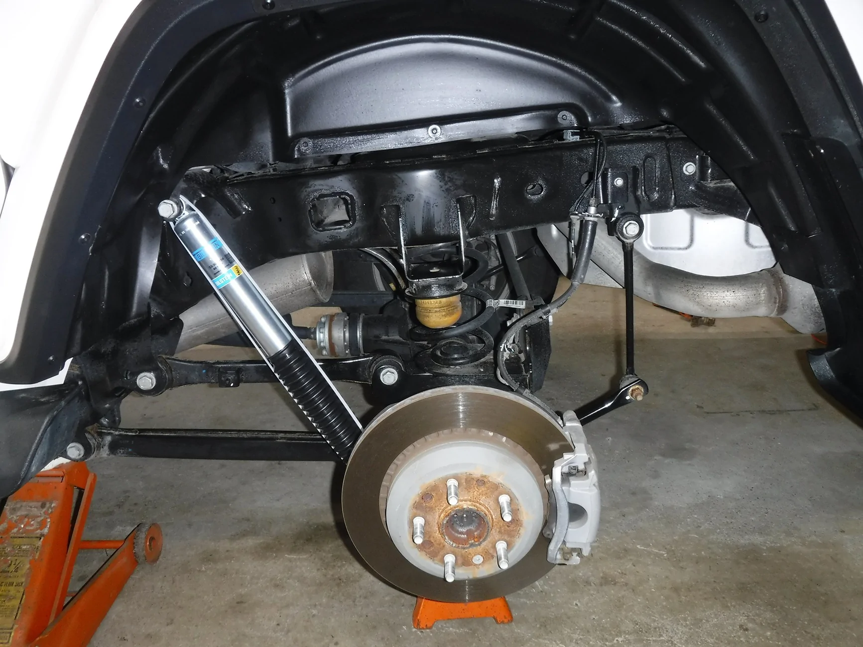

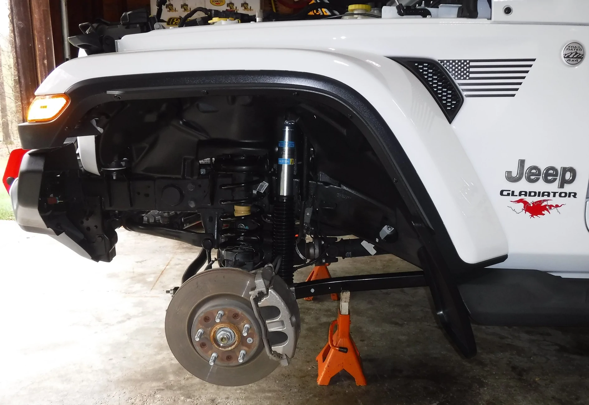

Since you dont want/cant afford remote reservoirs I'll stick with these comparable models.
Bilsteins 5100- Great all around shock that wont break the bank. Ride is slightly firmer than a stock Rubicon. Great for highway, good for off road. Digressive valving, meaning starts out firmer and stays more consistent. Not serviceable, but known to last +50k miles without needing replacement. Non adjustable.
Fox 2.0- Another great all around shock that wont break the bank. Softer ride, good for off road but will see more body roll on highway. Progressive valving, meaning starts softer and firmness increases. Serviceable with recommended intervals every 30-50k miles. Non adjustable.
Falcon 2.1- Most expensive of the three in its class. Firm ride, more feedback felt from road surface. Digressive valving, so starts firm and stays more consistent. Serviceable and recommended intervals every 30-50k miles. Adjustable, but need to be removed to make adjustments (shock body rotates to adjust).
I can say this much, I have AEV HD springs with Bilstein 5100s. The ride is surprisingly comfortable on the highway, especially with HD springs. Washboards and rocky trails it can get a little rough, but airing down tires makes a huge difference.
My buddy has Falcon 2.1's with Metalcloak Gamechanger 2.5 springs. It has a noticeably rougher ride compared to my AEV springs with Bilsteins, even though his springs are softer than my AEV springs. Every crack in the road or slight bump in the surface I could feel, whereas my truck I don't notice them much at all.
