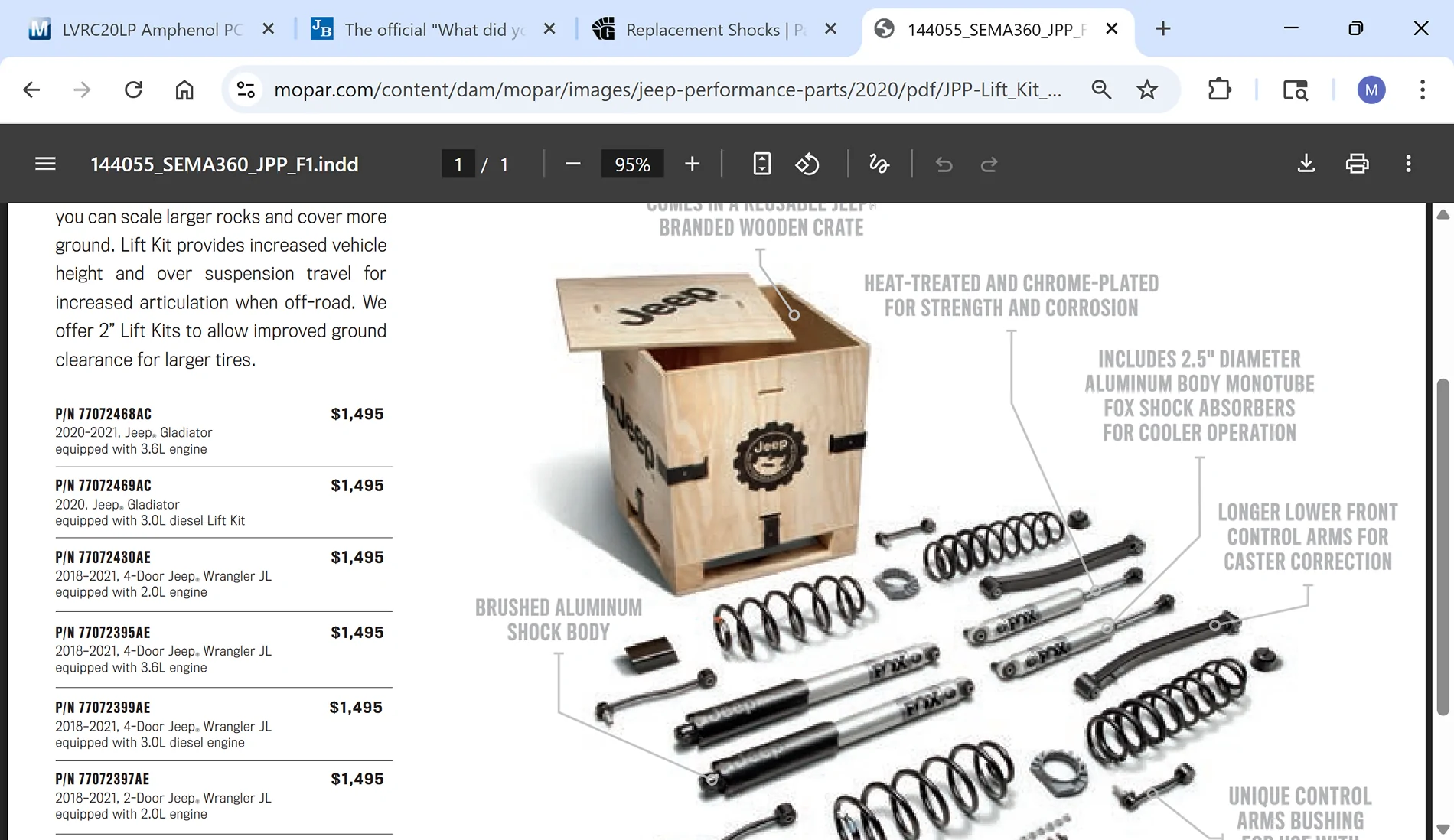

Maybe that's the nomenclature thing. They say Fox 2.5" diameter shocks. This was from the Mopar website.
  • Other Names:Suspension Kit
  • Description:Jeep® Performance Parts 2" Lift Kit has been developed by Jeep® brand engineers and off-road enthusiasts and allows you to use larger tires. The kit includes 2.5" diameter aluminum body monotube FOX shock absorbers for cooler operation. The lift kit increases articulation and tire-to-ground contact and the longer front control arms optimize suspension tuning for on-road driveability while improving off-road capability.
My issue is that those damn things are expensive as heck from what I have found
