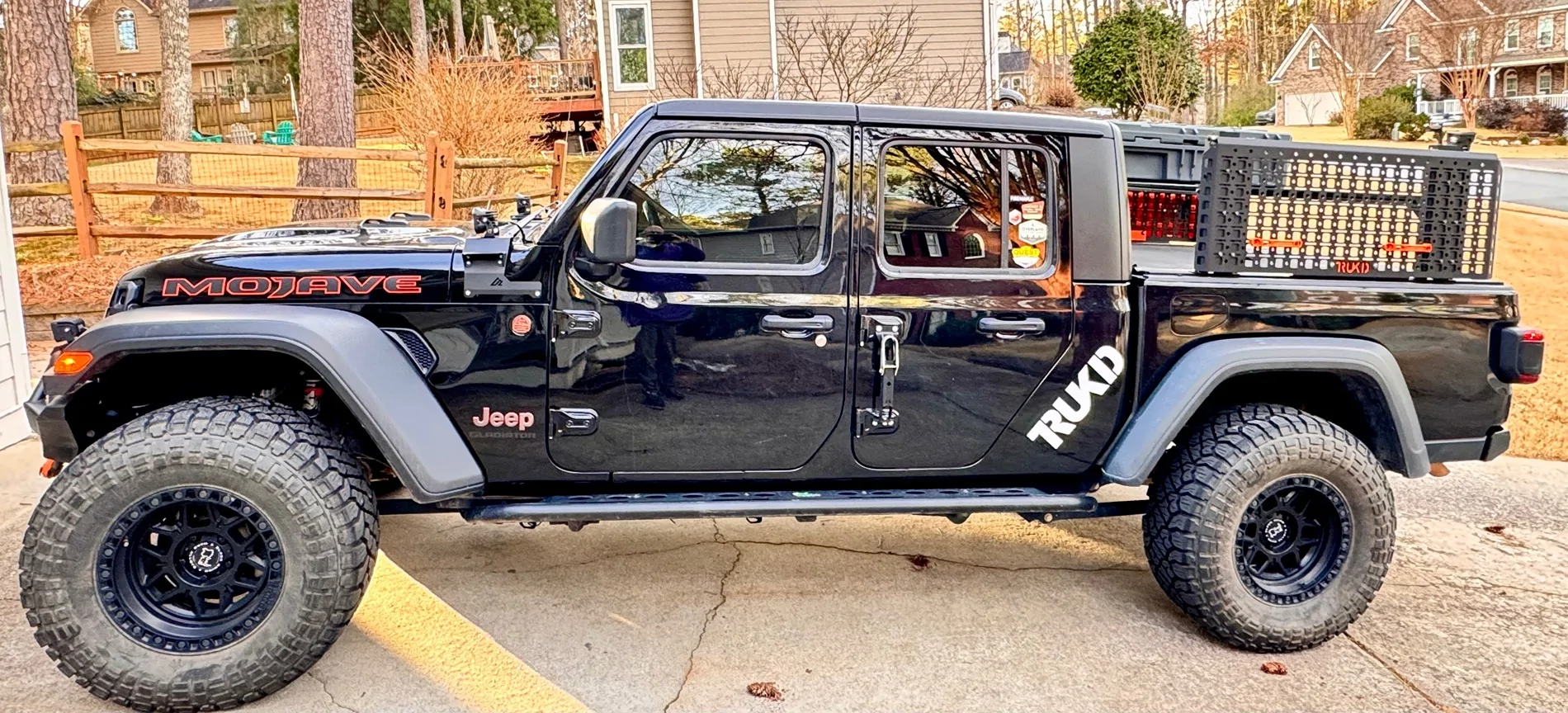

Is there an adjustable shock (not custom) out there that is equal to the stock Fox shocks on a Mojave? I’ve been looking at Rocksport Black, Falcon SP2 3.3, Bilstein 8100, Fox Elite 2.5, and King(EVOspec) 2.5. It seems like the Rocksport Blacks are newer, hence less feedback.
After many, many hours of running searches for opinions (good & bad) on replacement shocks for my stock Mojave ones, Ihaven't been able to find a consensus of opinions on what shocks have a ability to be adjusted to ride similar to the stock Foxes.
I would be the last person to build a frankenlift. I would run in circles trying to understand all of the nuances between manufacturers and capabilities of each component.
My 2021 Gladiator Mojave is a work in progress. I try to wait until a part has died (or put on life support) before I upgrade. I am currently on 35in Kenda Klevers and have purchased the Metalcloak Gamechanger 2.5in lift. My plan is to use my stock Fox shocks and MC’s shock mounts, but with 45k miles I am trying to determine if I should go ahead and go with new shocks when I install the lift instead of buying the shock extension mounts only to have to change those out within the next year or 2.
My Mojave is my DD, and with my goal of at least 30nights of camping this year, it will see a lot of Forest Service roads (GA) but also quite a bit of technical trails like the DBBB, or Windrock & Beasly. The desert rating is why I went with Mojave over Rubi, as I find the suspension is ideal for my enjoyment.
