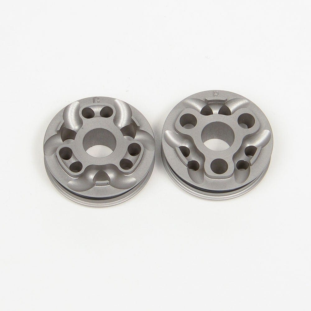

Here's a Penske shock piston in Linear/Linear config:

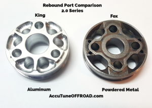

Here's King vs. Fox linear piston:
Jeep Gladiator Rocksport Black shocks - good replacement for stock Mojave Shocks? x-vs-King-2.0-Coilover-Piston-Rebound-Port-300x213
You notice that the way the ports are machined, they are at different heights. No port can be sealed up by one solid shim across the face of the piston.

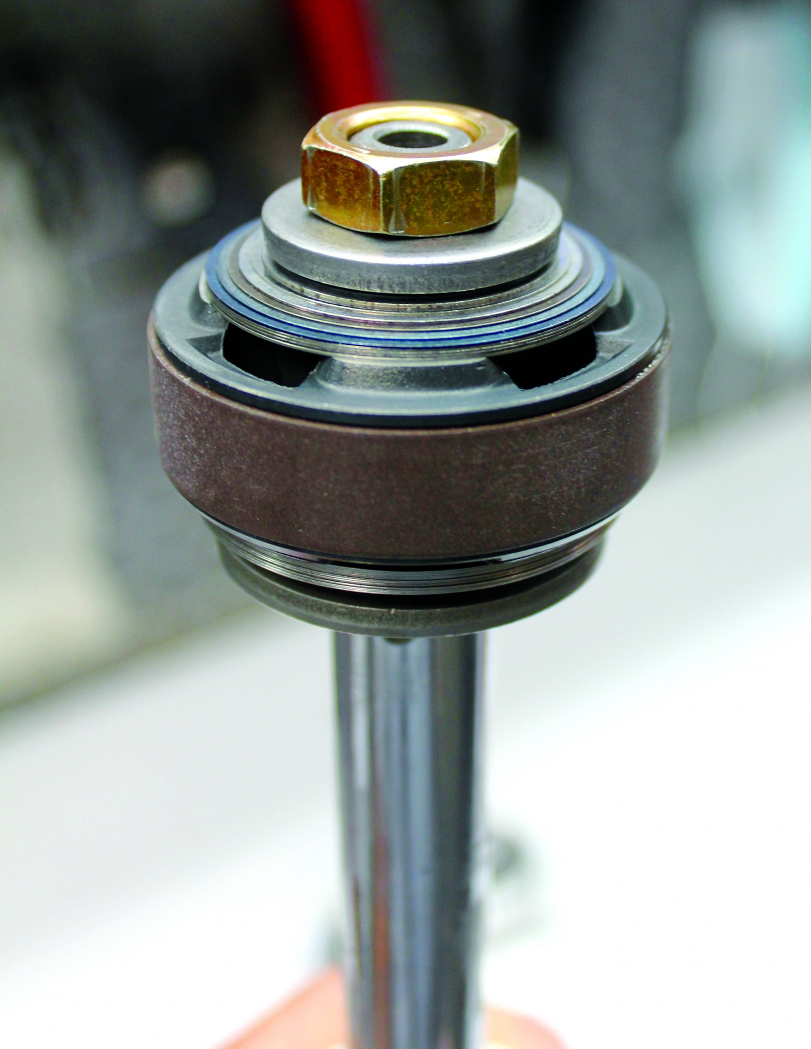

This picture depicts the shim stack - or valving - of the shock on the piston:
Jeep Gladiator Rocksport Black shocks - good replacement for stock Mojave Shocks? TEN-THINGS-SHIMS-3_e-scaled
See how some ports are still open? Those ports control slow-speed/low-speed shock action. Shock oil passes through those ports as the piston travels through the shock body. That's what controls the speed of low-speed rebound and compression (for "basic" shocks w/o external adjusters).

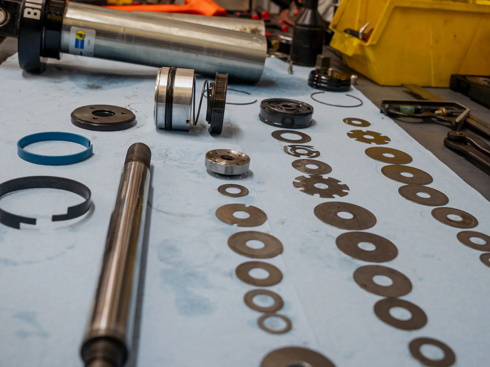

Before all this "stuff" became a thing, our race shocks were valved from the manufacturer and stamped with the valving, usually a number 1-10. 5 meant it was 5 rebound, 5 compression, middle of the road shock. A 4 - 6 shock was 4 rebound 6 compression, meaning it had less rebound and stiffer compression. This slowed the weight transfer to this wheel, but sped up the weight transfer away from the wheel.
With shim stacks, valving is infinitely more customizable. Shims are nothing more than thin washers you stack to give a shock a desired high-speed resistance (oversimplification). Shims come in a variety of thickness and widths for your every whim.
Shock broken down by piece:
Jeep Gladiator Rocksport Black shocks - good replacement for stock Mojave Shocks? dia-OEM-Valving-Specs-Wheel-Every-Weekend-32137983
You can create any combo you want with the shims. The main thing is to have the big one cover the ports. Because that's what activates the shim stack during high-speed movement. The pressure of the oil will bend the shim stack to let the oil pass.
The constant bending - or open/close - of the shims is why these types of shocks need to be rebuilt. Metal can only flex so many times before it gets fatigued, and eventually it can fail completely by breaking.
