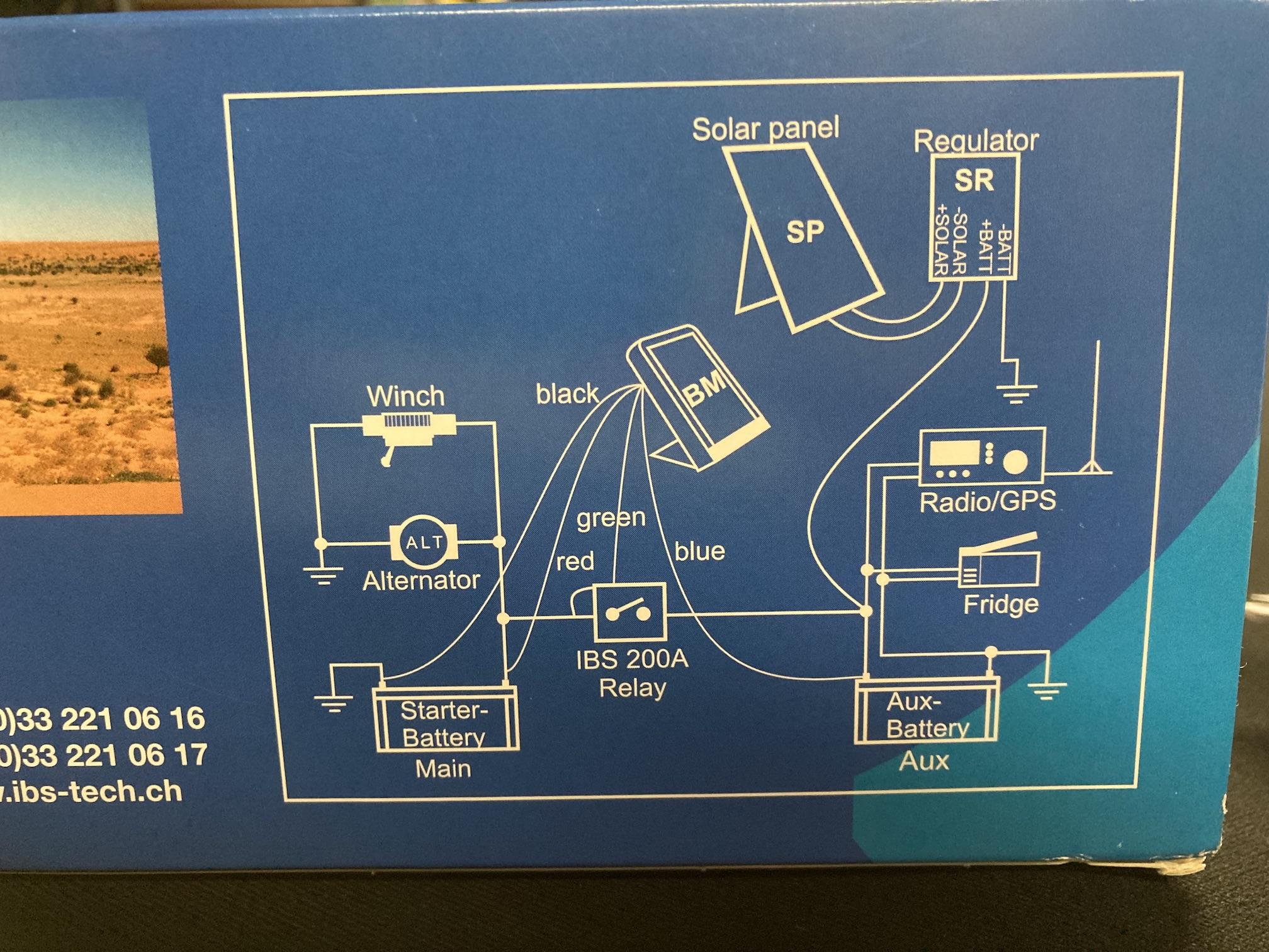

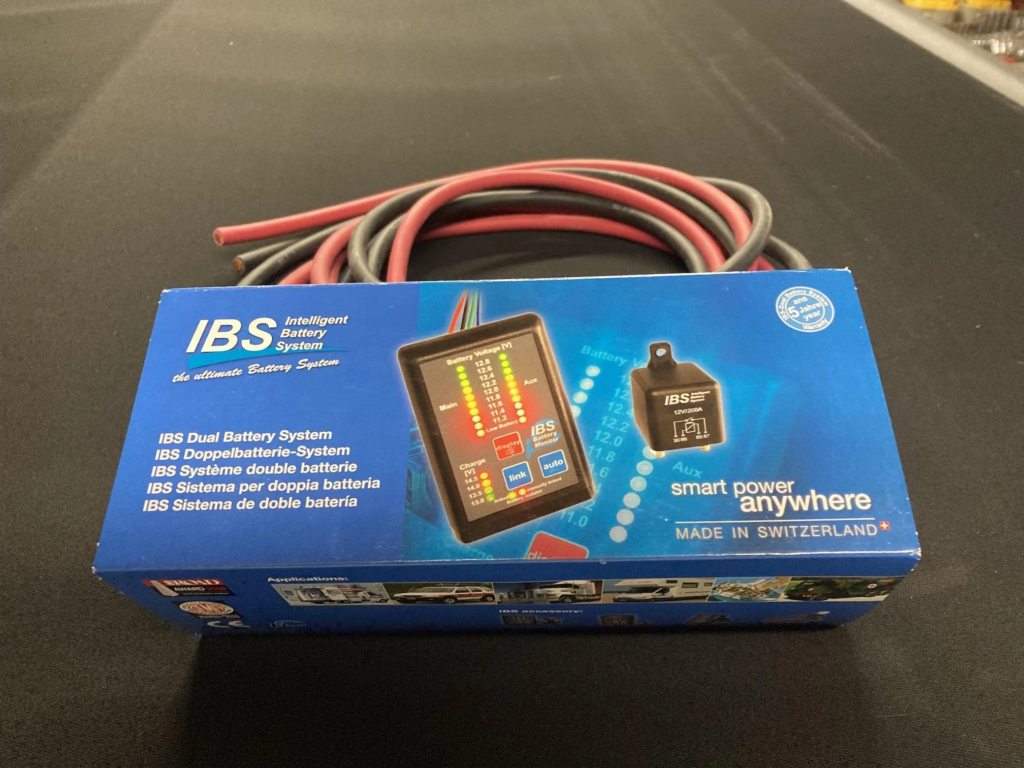

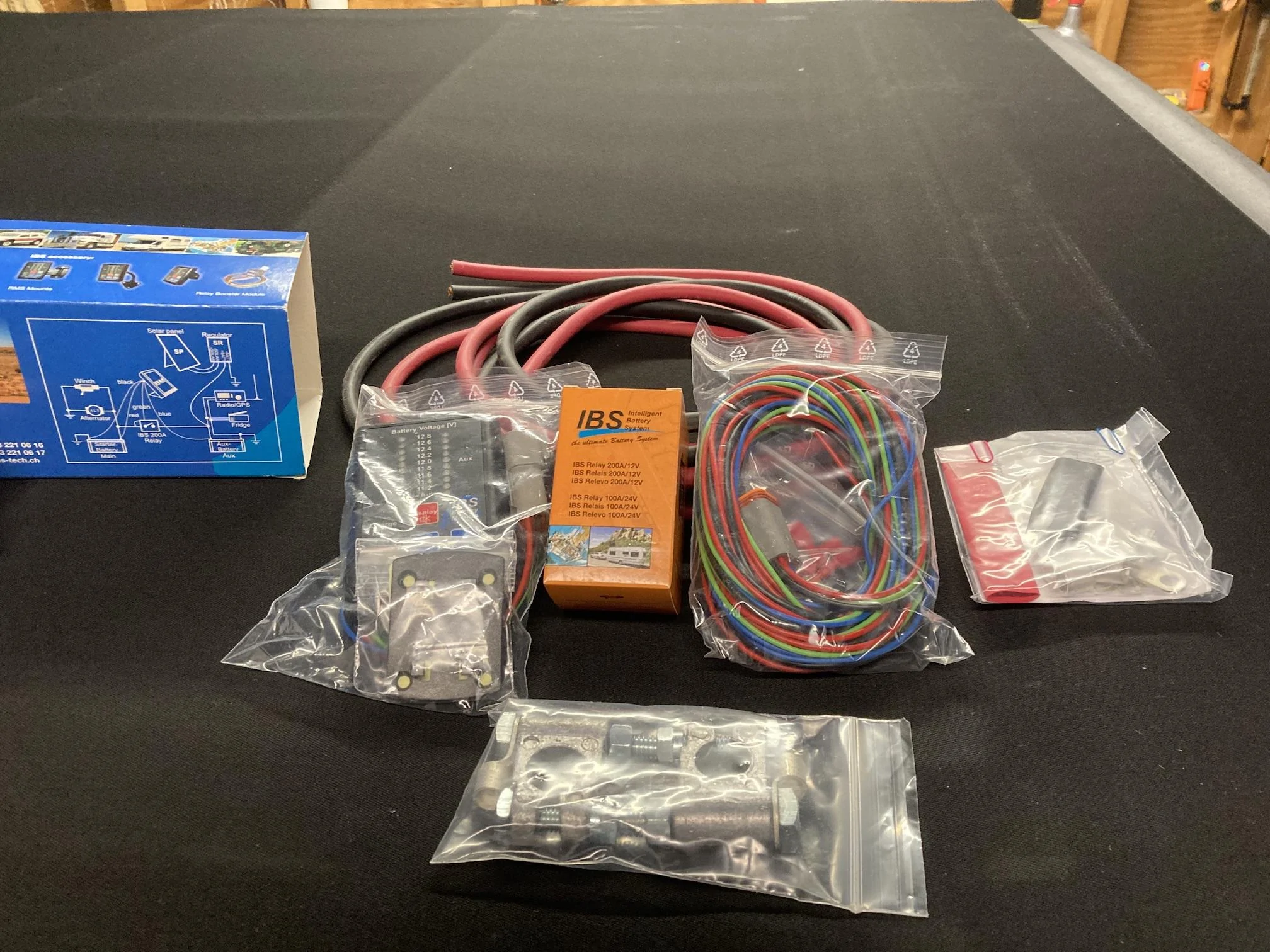

That got me thinking ... for a previous build that I retired 5 or so years ago, I had purchased a dual battery setup from a Swiss company called Intelligent Battery System (IBS for short, and not to be confused with the Jeep IBS system we all already have). It comes with a 200A relay/isolator, a control module for the cab, 10 feet of #4 Flex-A-Prene welding cable in red and black, a plug-and-play wiring harness for it all and all the basic hardware. When I unpacked the old box with this stuff, I also found a Blue Sea power panel (4363), 100A circuit breaker, a DC subpanel/fuse block and a bunch of wire and odd power outlets. This stuff was the real deal 8 years or so ago when I got into this, but I never found the time back them to install it.
The first, big question for the many folks here who are way smarter than me is: Can this setup work on the Gladiator?
From what I can tell from @Mr._Bill and friends, if I get the right battery I should have a viable "house power" system onboard. With the addition of an MPPT solar controller, a 200A breaker at the main battery for safety, and a little more #4 wire, I should be able to add a battery box to the front of the bed that can not only power my fridge and minimal gear, but also have the capacity and safety to add camp lights, power into a RTT if I add one, and be available as a backup to jump the main battery or link for added winch support if ever needed in a pinch. I save the cost of the added EcoFlow battery and a portable jump starter (about $500), and pick up the cost of an AGM battery, solar controller and added wire (I'm guessing between $500-$600). Seems like pretty near a wash, and I get a much more capability.

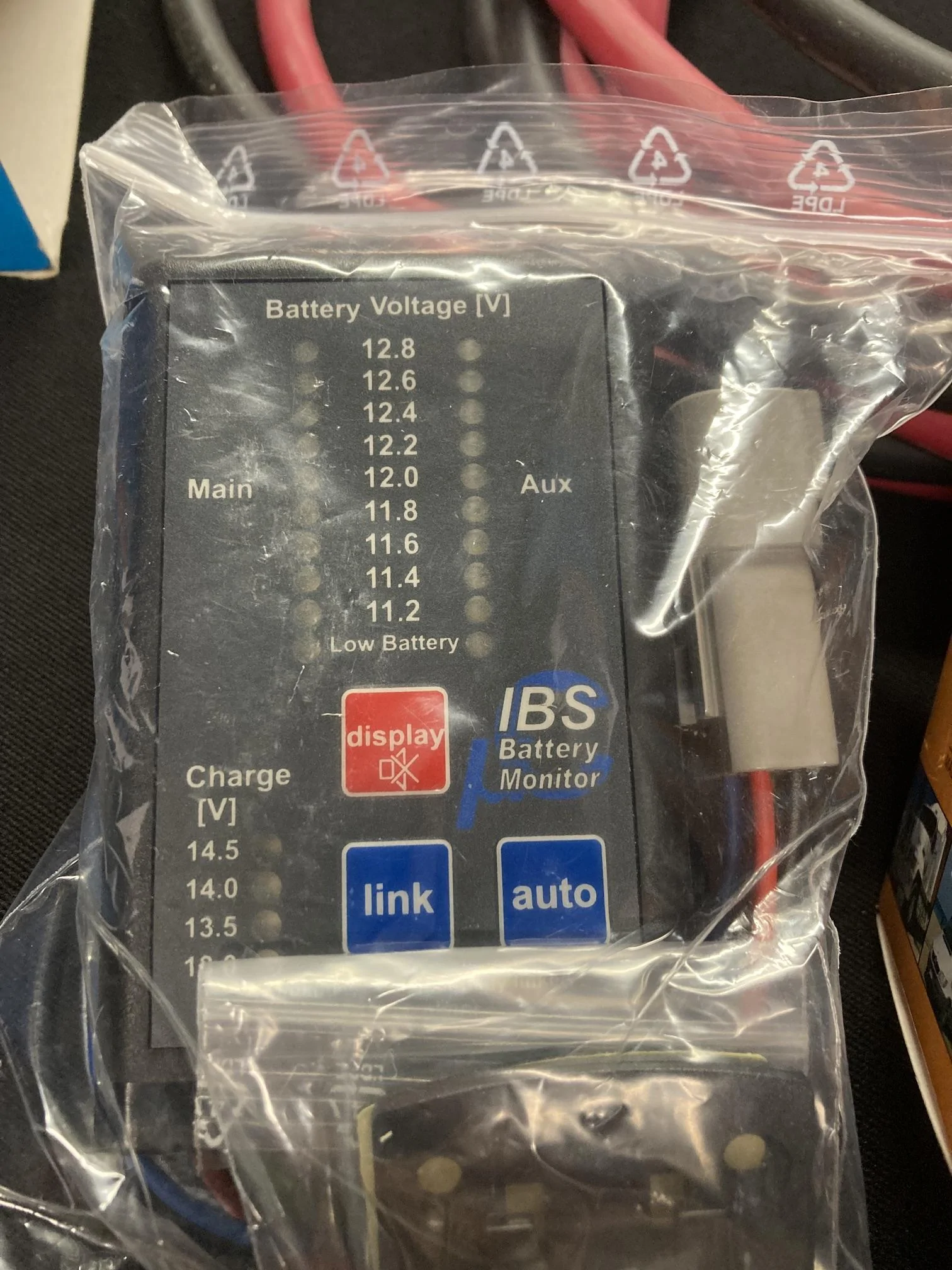

I'm very much eager to know what you think. For added background, here's the dual battery system I found tucked in my old-stuff box:
Jeep Gladiator Retro dual battery setup – will this work? IMG_2694
Jeep Gladiator Retro dual battery setup – will this work? IMG_2695
Jeep Gladiator Retro dual battery setup – will this work? IMG_2701
Jeep Gladiator Retro dual battery setup – will this work? IMG_2697

I don't see any reason why it would not work. It's a bit fancier kit form of what I pieced together. Where the diagram shows the 200 Amp relay is where I have the Smart Isolator, which includes a big relay also rated for 200 amps. My setup does not include the solar portion, but it would be nice to have.

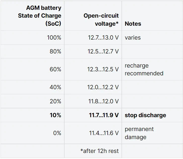

I had to sort of laugh to myself, though, when I saw the voltages and at the bottom was "low battery".
Seriously, when you get down to 12 volts that's REALLY low on an AGM.
Excellent point. I'll add few dots of red paint to that monitor display to remind me that if voltages drift south of 12.0, I'm into the danger zone and it's time to figure out why.

I'll temper my comments with - I see Mr._Bill said deep cycle. The numbers for that may be different but generally speaking - do be wary of taking typical batteries down too low.
It's amazing the number of "cycles" that fall off a battery that's taken too low even if charged fully, and it's worse if they are taken low and never 100% fully charged.
