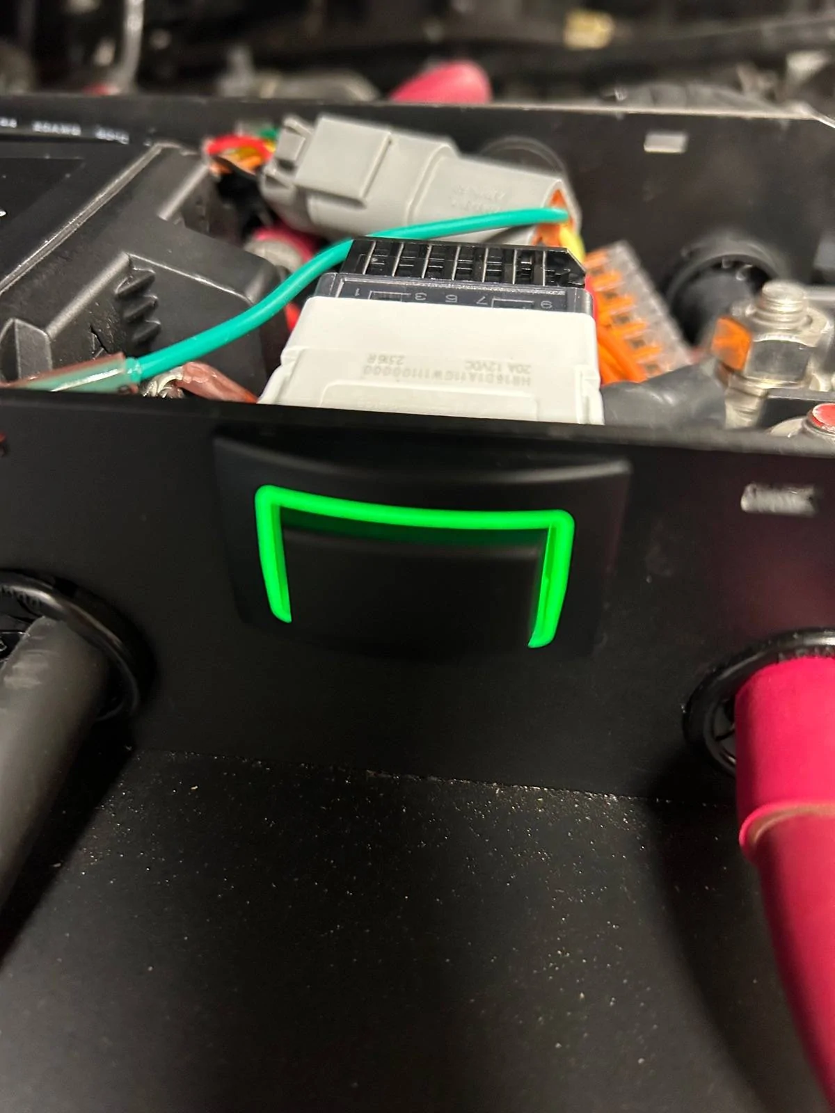

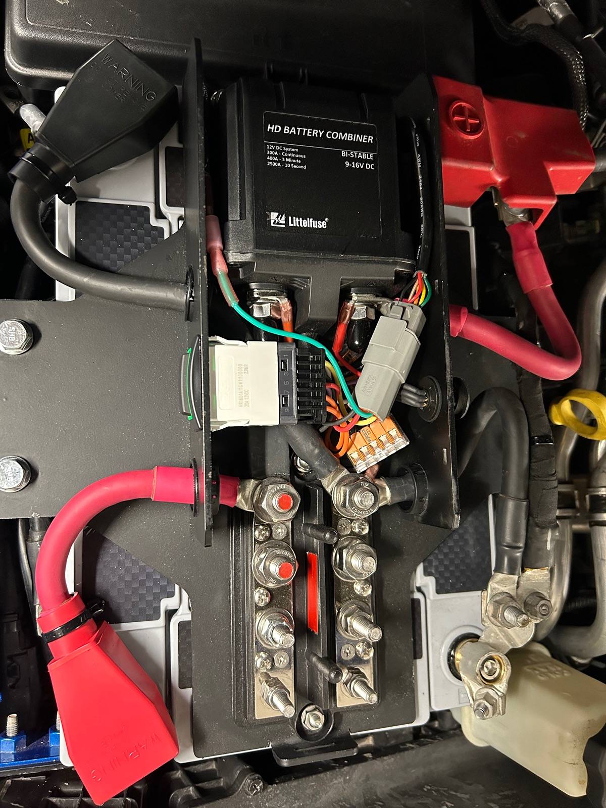

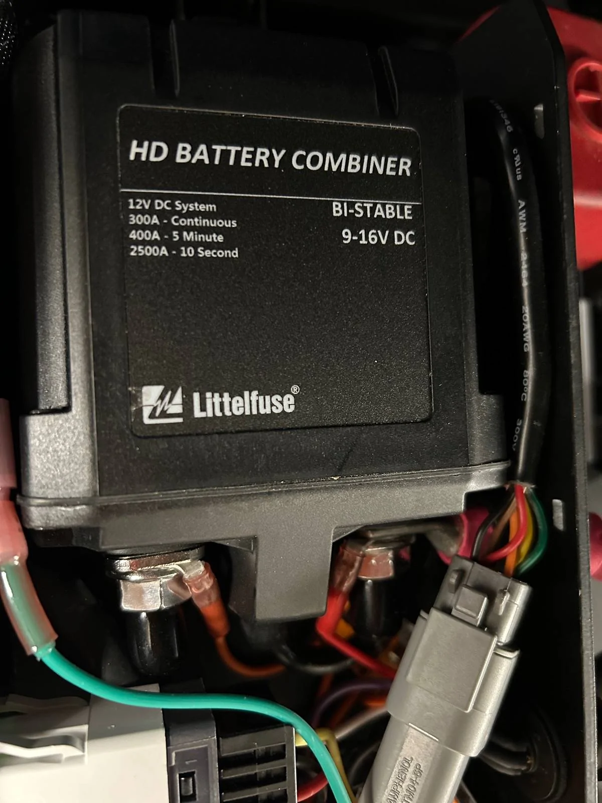

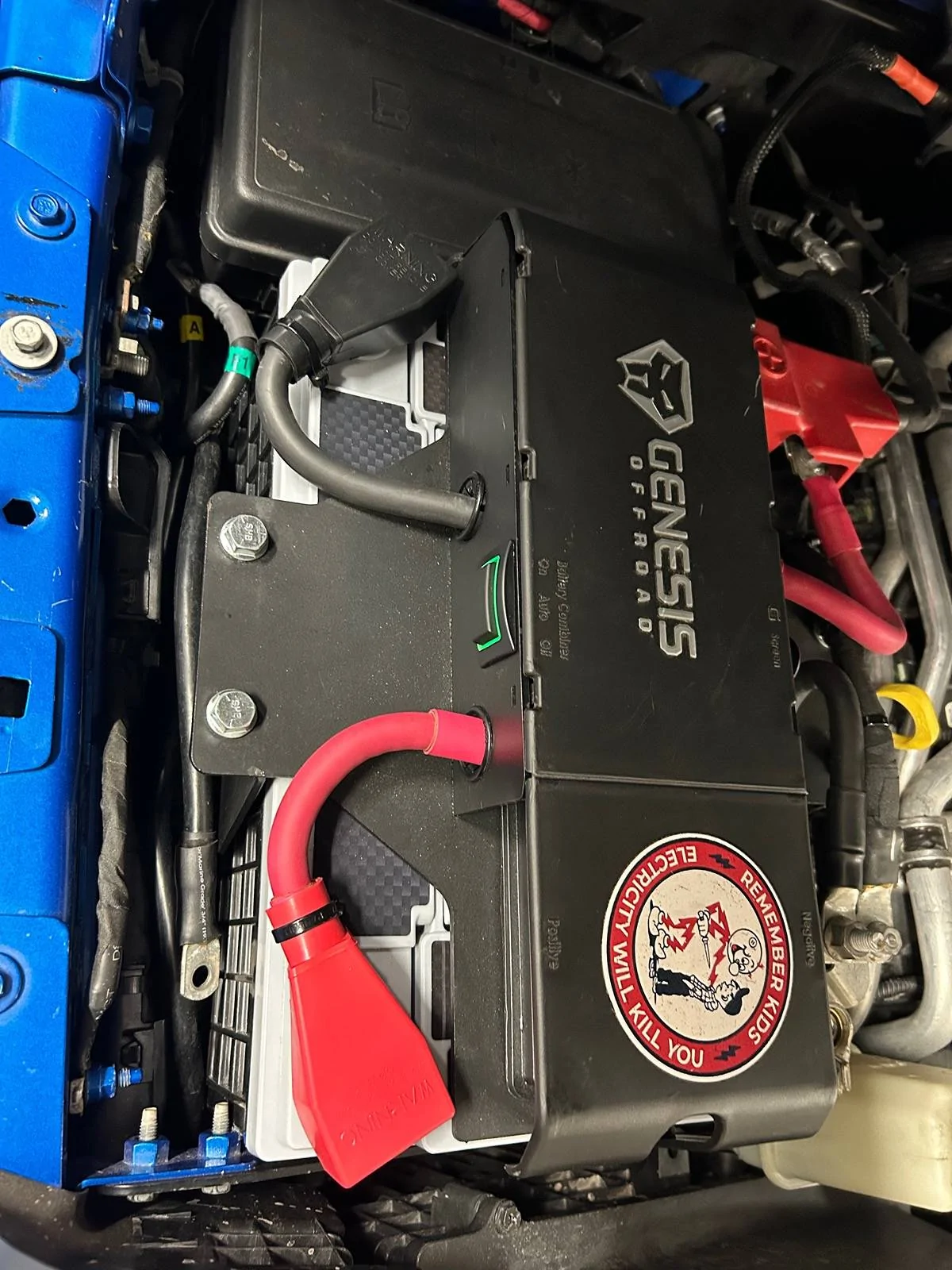

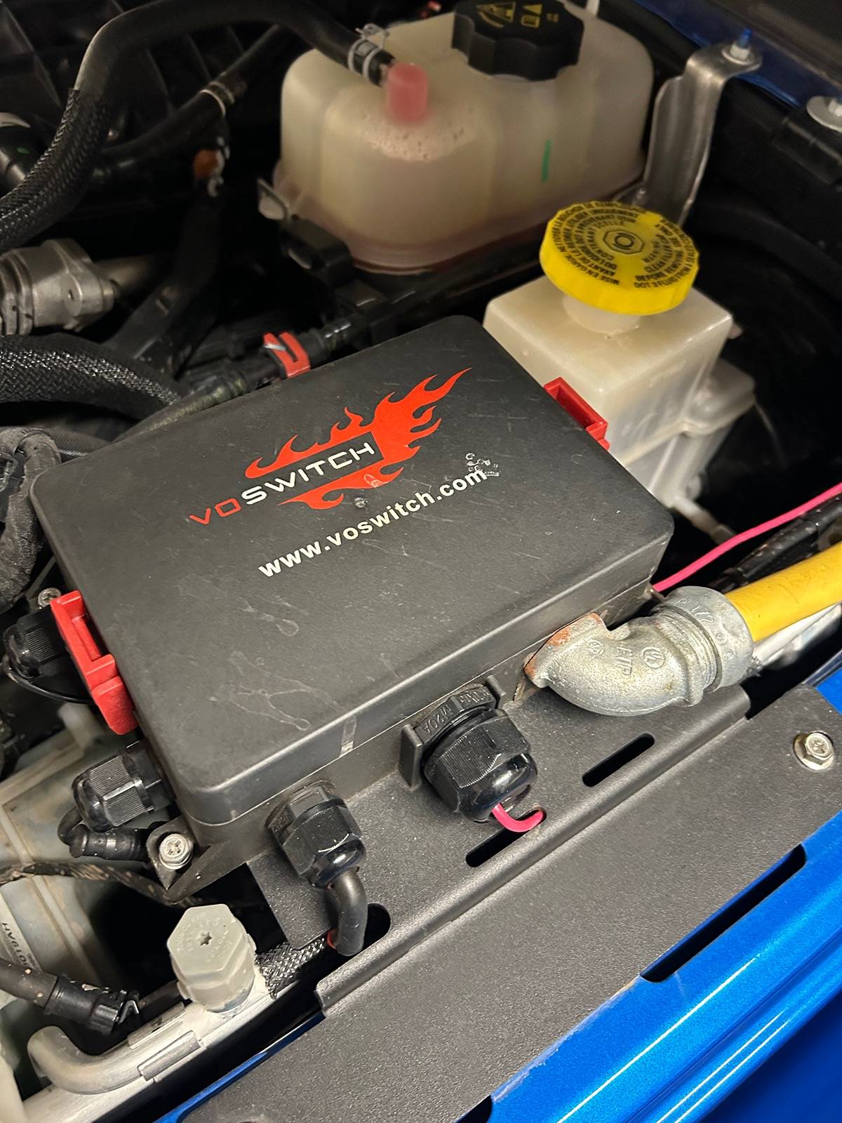

Henry234 here are some pictures hard to see it all but it is pretty nice there is no power draw on the combiner after it switches, the older version had a solenoid with a coil that would have current draw when activated and also create heat, which can draw down the battery. The new version is vastly improved with better lugs for hook up, everything is covered. Even the switch is improved with a light to show status of combiner and allows automatic mode, connected, or separated positions. I agree Genesis should perhaps do better perhaps trading in an old version as a core towards the new version , I can see their side also as upgrading everything they sold already would be a hit, and is caused by them improving the system. I would love to see the next upgrade being a larger house battery in future , but space is tight….Jack

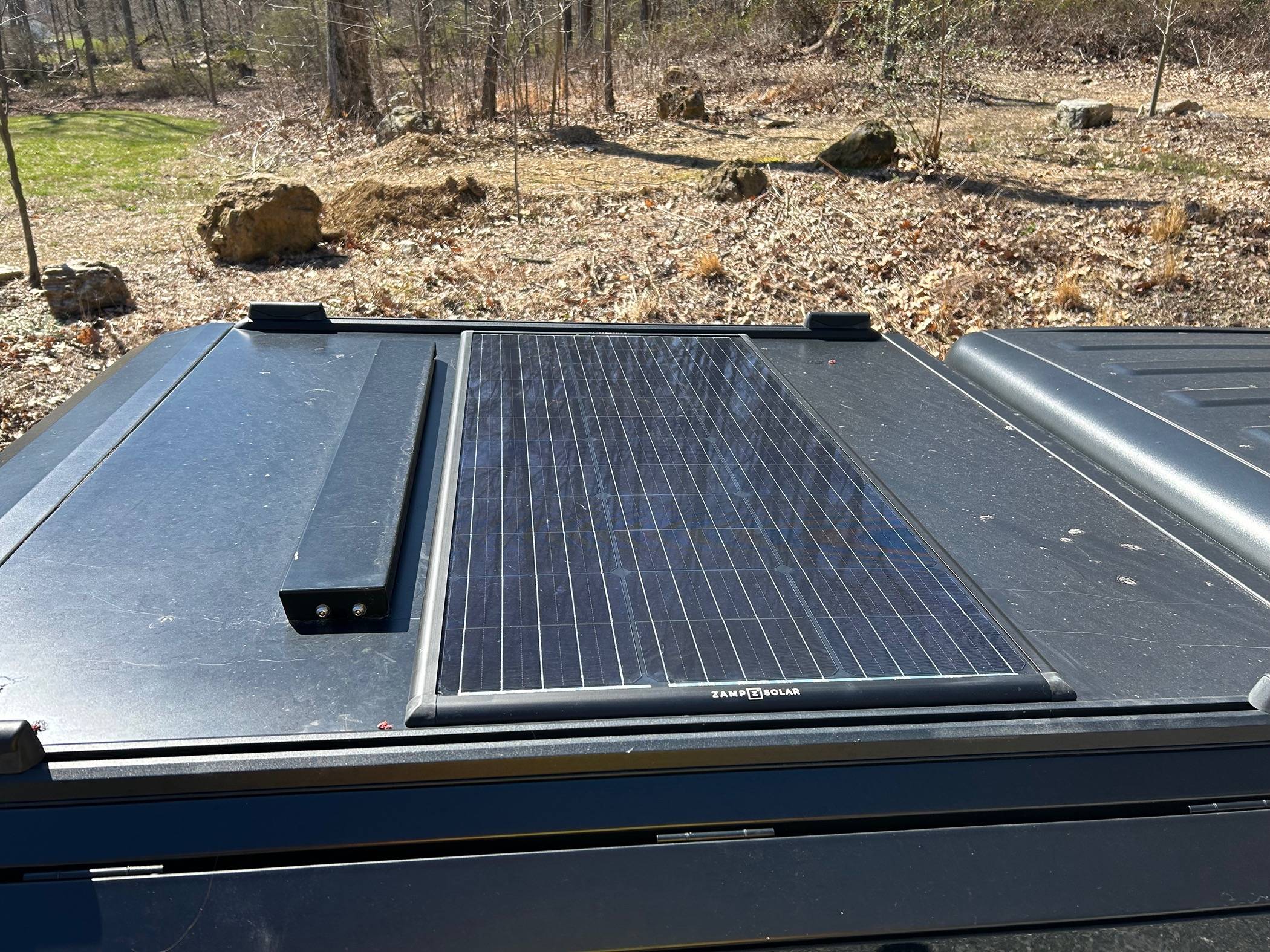

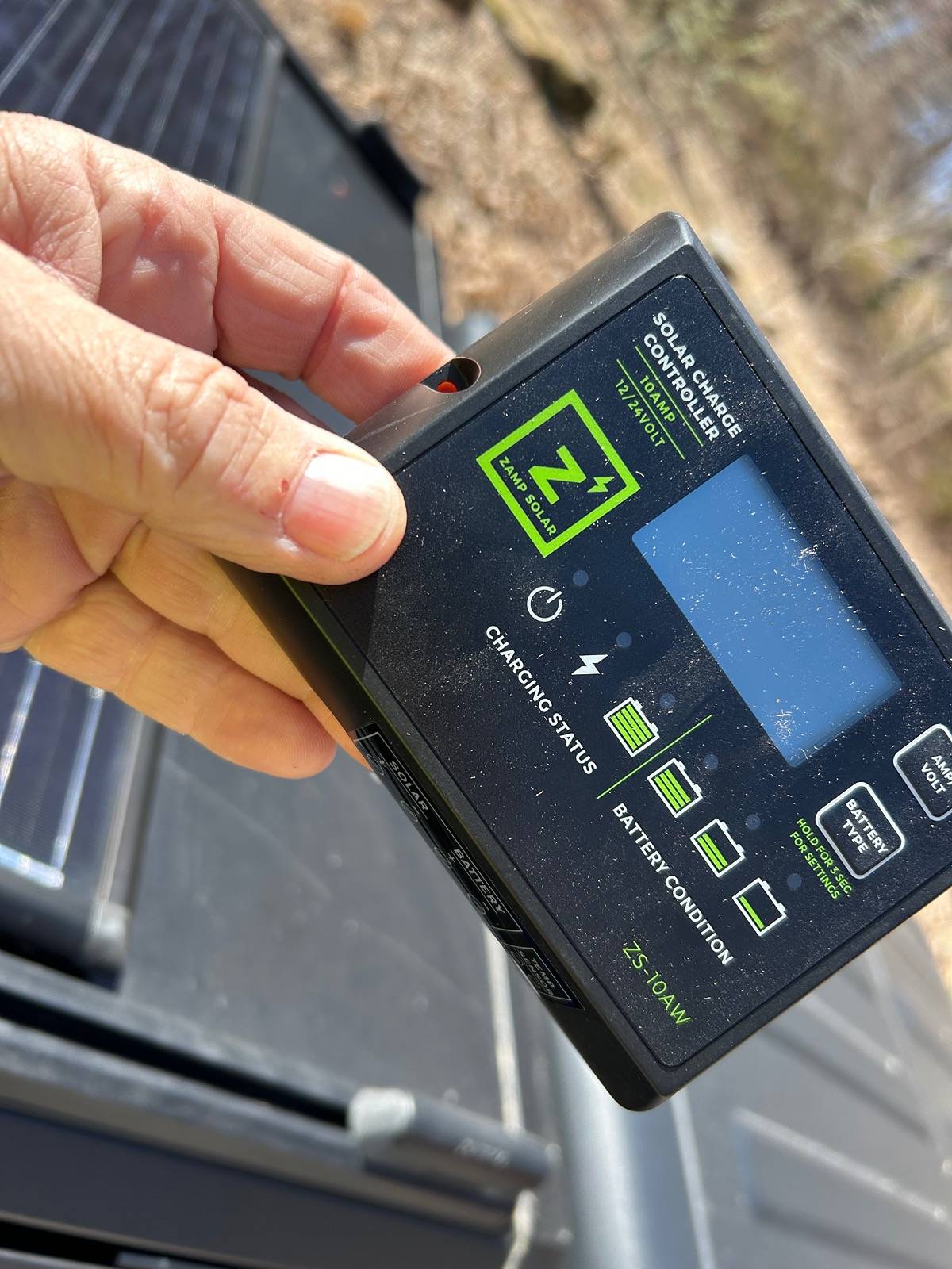

PS: Kudos to Chorky for helping me with my system which is small and focused on running an ARB Elements fridge , with a Zamp US made 100watt solar panel going on my RSI cap, utilizing a Voswitch system to handle loads.

Sorry for the late response, it's been a pretty crazy few weeks. Thanks to @Jaxmax for his photos. My wiring is exactly the same as how it came, I just put the brains of the system on a different mounting platform to accommodate the factory size battery since my aux batteries are in the bed. The wiring can get confusing though if you are trying to make modifications. I forget what wires exactly do what, but the folks at Genesis have been good at explaining it to me in the past just since I am curious minded.

Hey thanks for the pics! Badass setup you got! I wish they sold the system with just the connector and switch as I don't the busbars. I am going to email them to ask a few more questions on wiring as I used a littelfuse combiner in the past with problems.
Hey thanks for the reply! No biggie on the late response as I understand crazy. I will have to inquire about a few wires before I pull the trigger, so I will email them.
