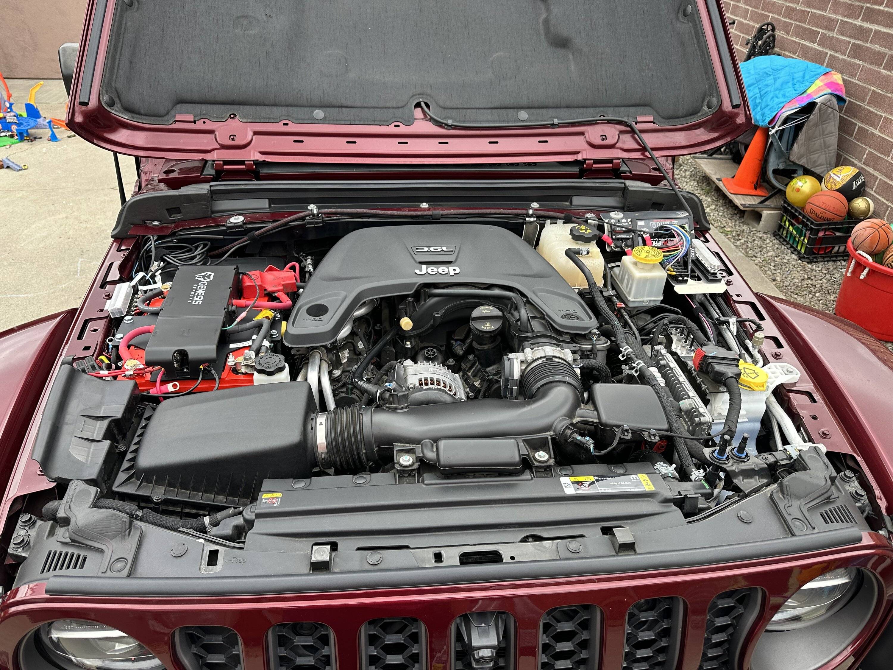

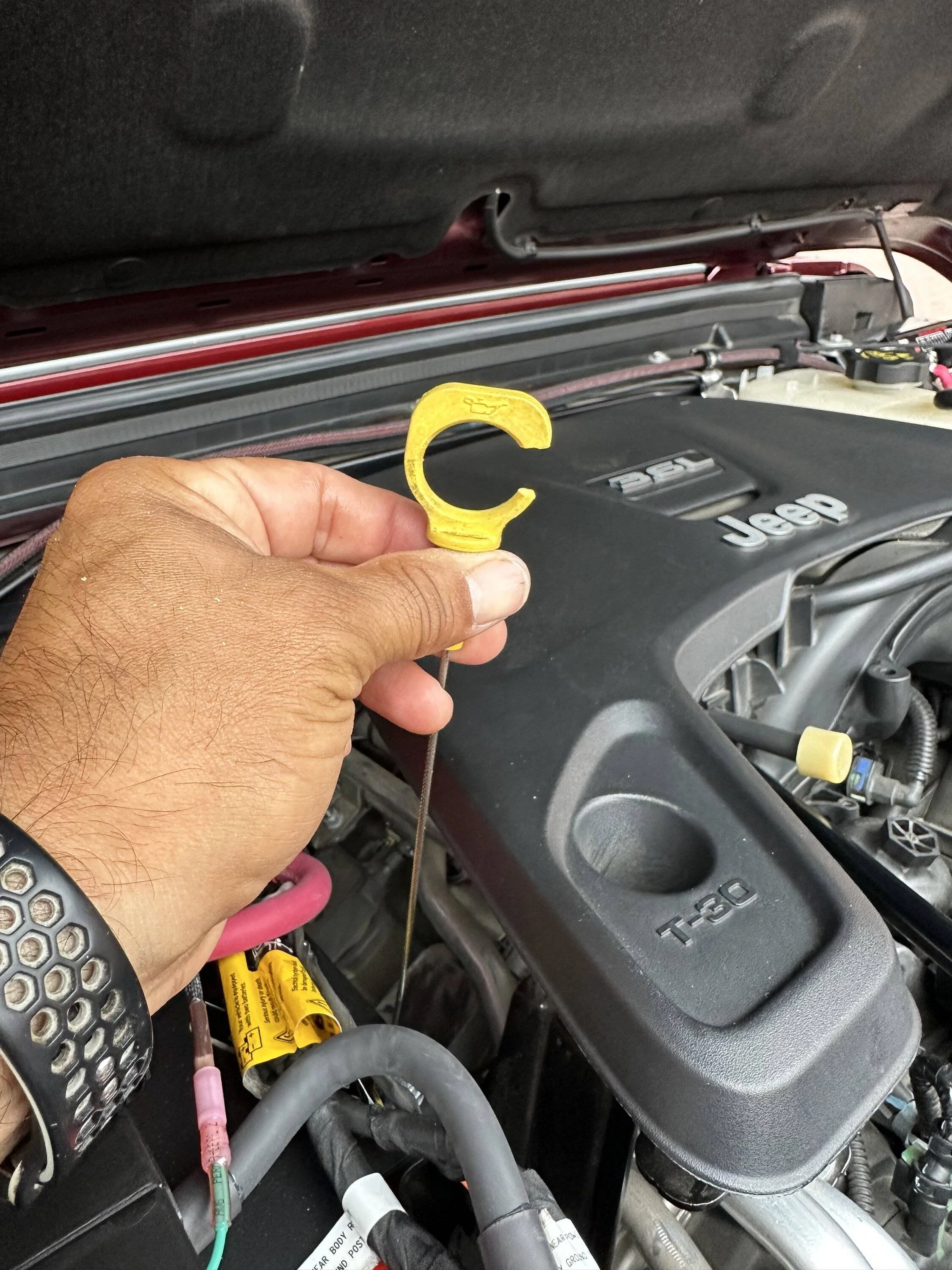

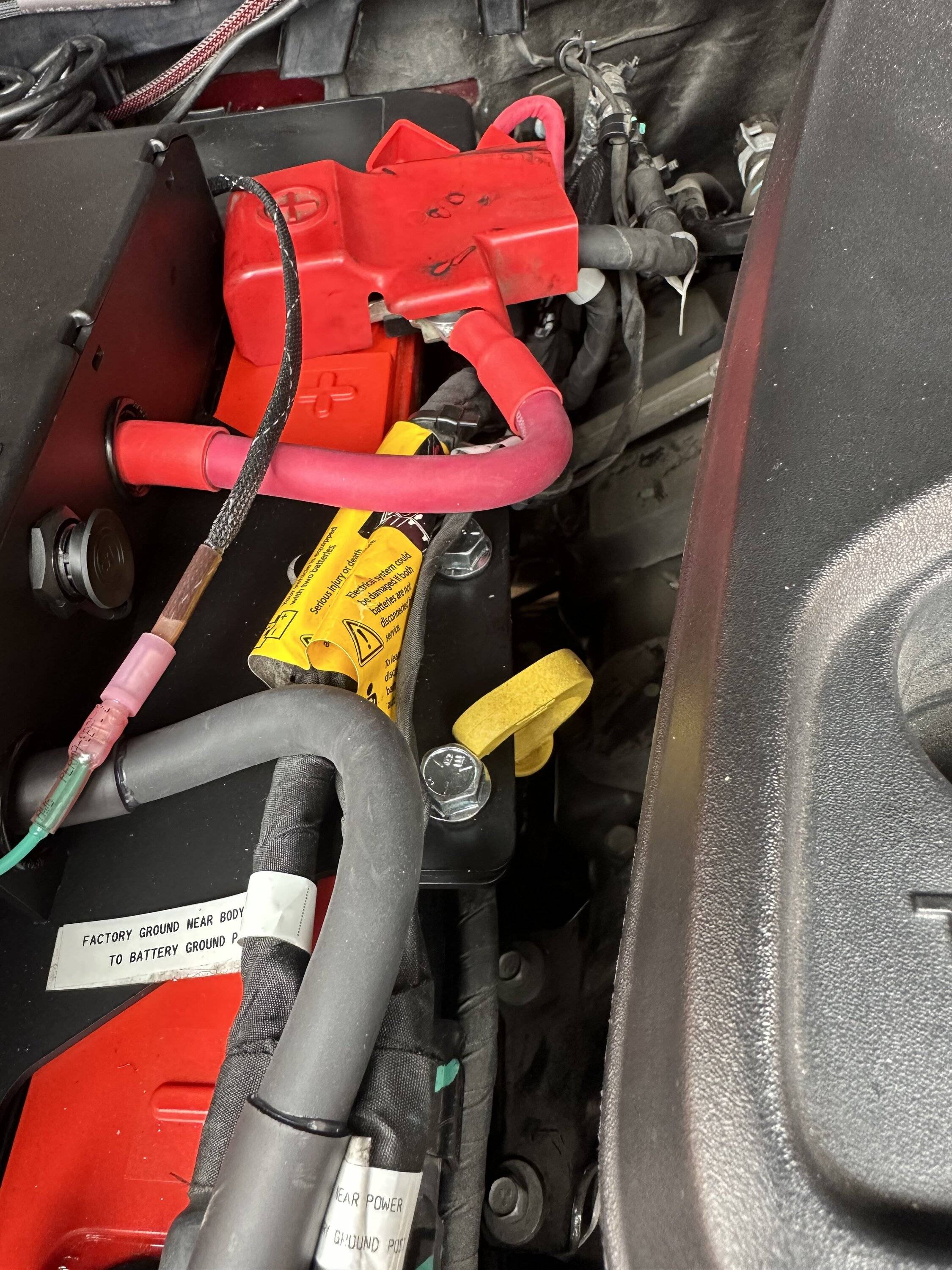

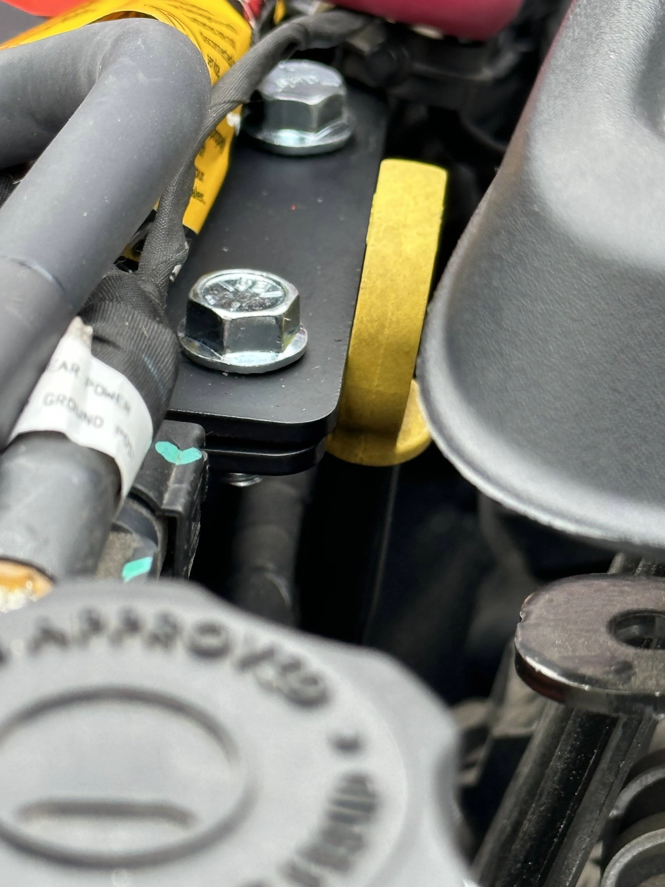

Just finished installing Genesis Gen3 in my 2021 gladiator Rubicon. I found that the battery chassis pushes against and partially blocks my oil dipstick. To remove the dipstick I have to slightly move the dipstick intake tube so that the dipstick handle
Can clear the Gen battery chassis. Can't do this forever without eventually loosening the dipstick intake tube right of the engine block. I am highly confident I installed the Gen3 correctly and don't see any obvious way to move the chassis in any direction based on the factory screw hole sizing, location, and the Genesis welded nut locations on the battery chassis but before I take it all apart to check if it can be moved toward the passenger fender by 3/16" to 1/2"anybody run into this problem? I had to cut the dipstick handle just to no longer have the Gen battery chassis push against the intake tube d potentially break it off over time. My last resort is to grind out a small half circle with a max radius of about 3/16" deep into the Gen battery chassis where it touches the dipstick handle so the dipstick can be easily pulled out. I am hoping some one can tell
me I did something wrong to avoid any grinding.
My 2022 does not have an engine cover. I slightly bent the oil dipstick tube with no issues so there is clearance.

Thanks for the reply. So I take it the battery chassis did block your dipstick and hence why you bent it slightly. Well atleast I know I am not the only one.
I don't think it blocked it totally but it did impact enough that I needed to bend it about a half inch. But it works just fine.

Same here. It takes some force to get it out but can get it out but not without concern that I may eventually break/bend the tube if I keep doing it.

You should be able to bend it enough to be permanently bent and be fine. That's how mine turned out. It did take some force - but all is well. Nothing is broken and no leaks. You can take the dip stick out, put a small size deep socket on an extension in 1/2" to get good leverage.
