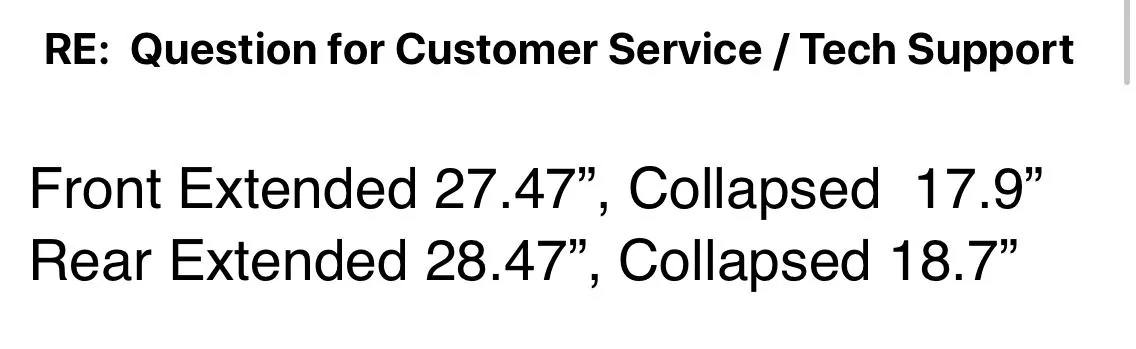

Exactly which Falcons did you get? I had asked them their lengths for the 2-3.5” shocks and was give the info below for the Falcon 2.1 shocks. I know for the JL that they spec longer shocks when you move up to the 3.1 or 3.3 for some reason.
I got the 2.1's in the 2-4" lift size as I ordered before the 3.3's released for the JT. Plus I kind of wanted to wait to drop more $$ and get their aDapt series when it comes out later this year. Or I might go with some King's at some point if I don't care for the falcons.
Right now on initial impression while the truck is still up on my lift is the front's could be longer and the rears are a little long(But I think once I get the brake lines the extra droop will be nice with the Pro-X). The pinion angle improvement when I bolted in the Pro-X uppers was insane. Everyone needs the longer upper links on their lifted JT.
