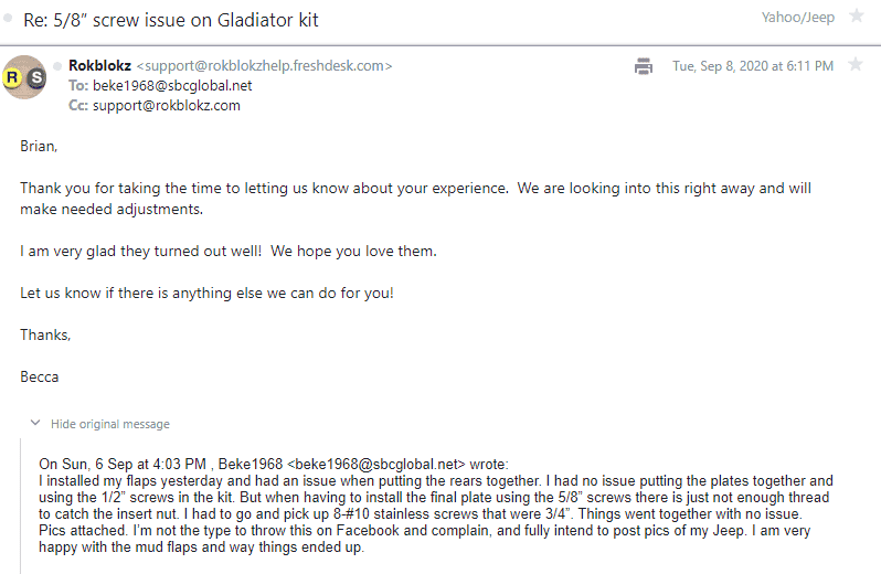

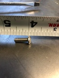

Bought and installed mine in September. Mine lined up, though I do remember the rigidness of them made it a bit difficult to get lined up in the front. My only real issue was the stainless screw length for the back when you stack all of the pieces together. I had to go and purchase screws that were 1/4" longer to get them together, because there was just not enough there for the thread to catch. I took pics of the issue, and how I corrected it, and sent it to RB, and they got back to me the next day and thanked me for the feedback. I didn't ask for anything because my only goal was to give them feedback to help future customers. Responsiveness was good, and I hope they fixed the issue. Good luck, but I think you may have gotten something incorrectly.
Here is what I sent to them...

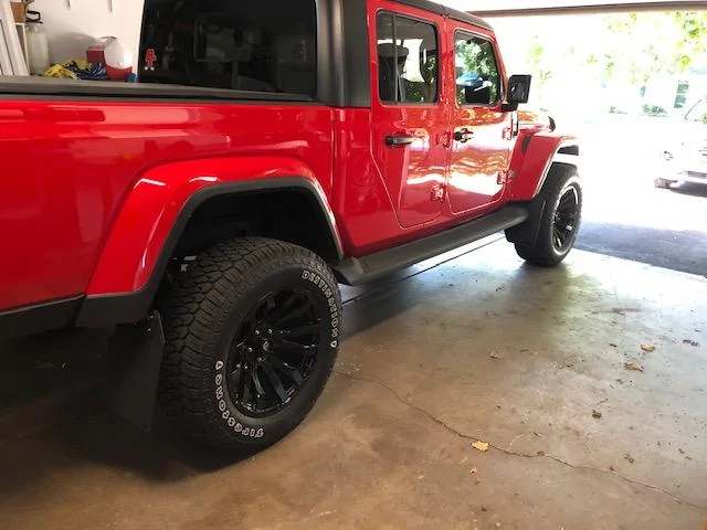

Mine fit just fine. The entire instillation for the front and back took about 1 1/2 hours. I did have difficulty determining which side was smooth and which was textured.
