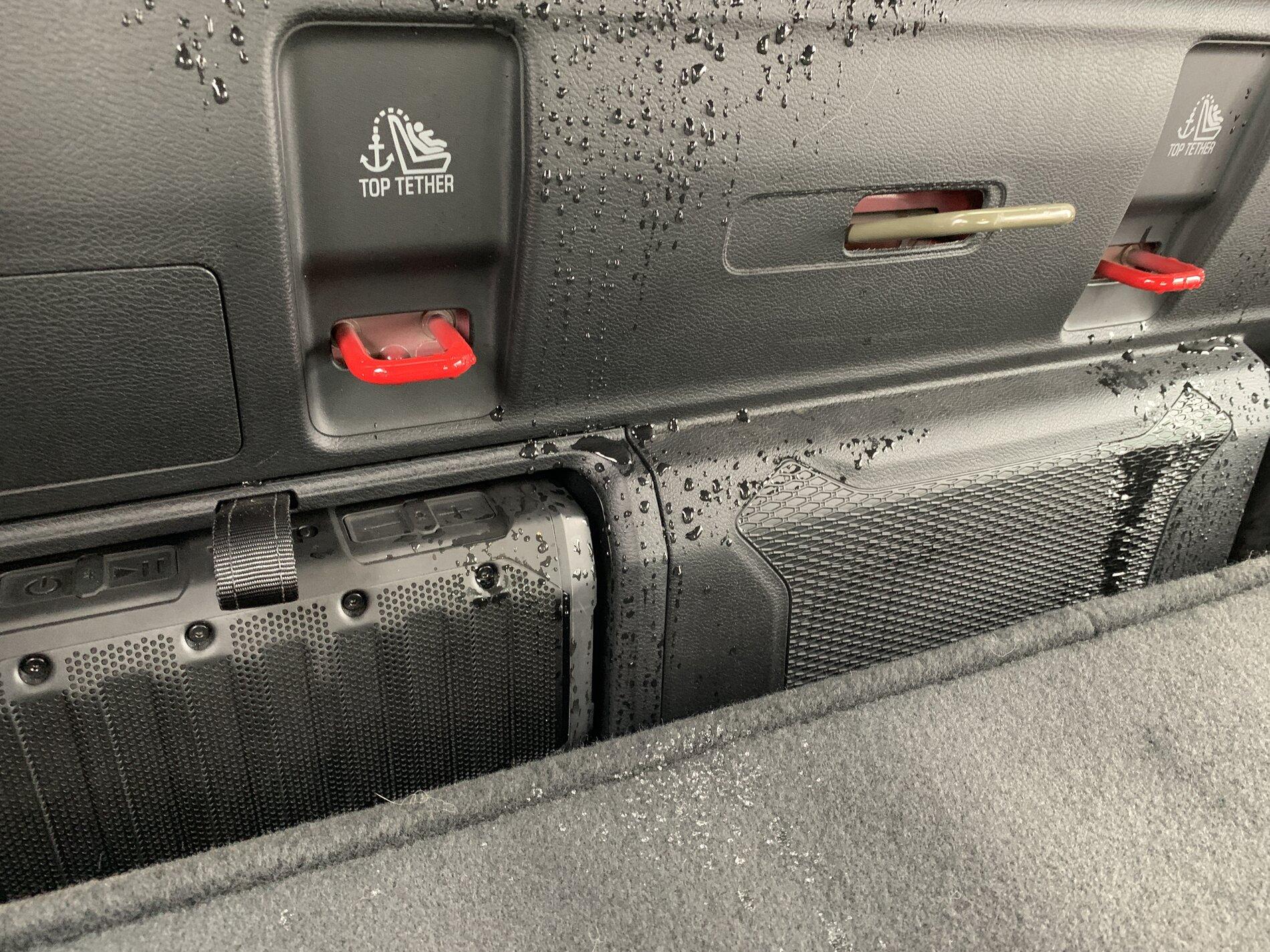

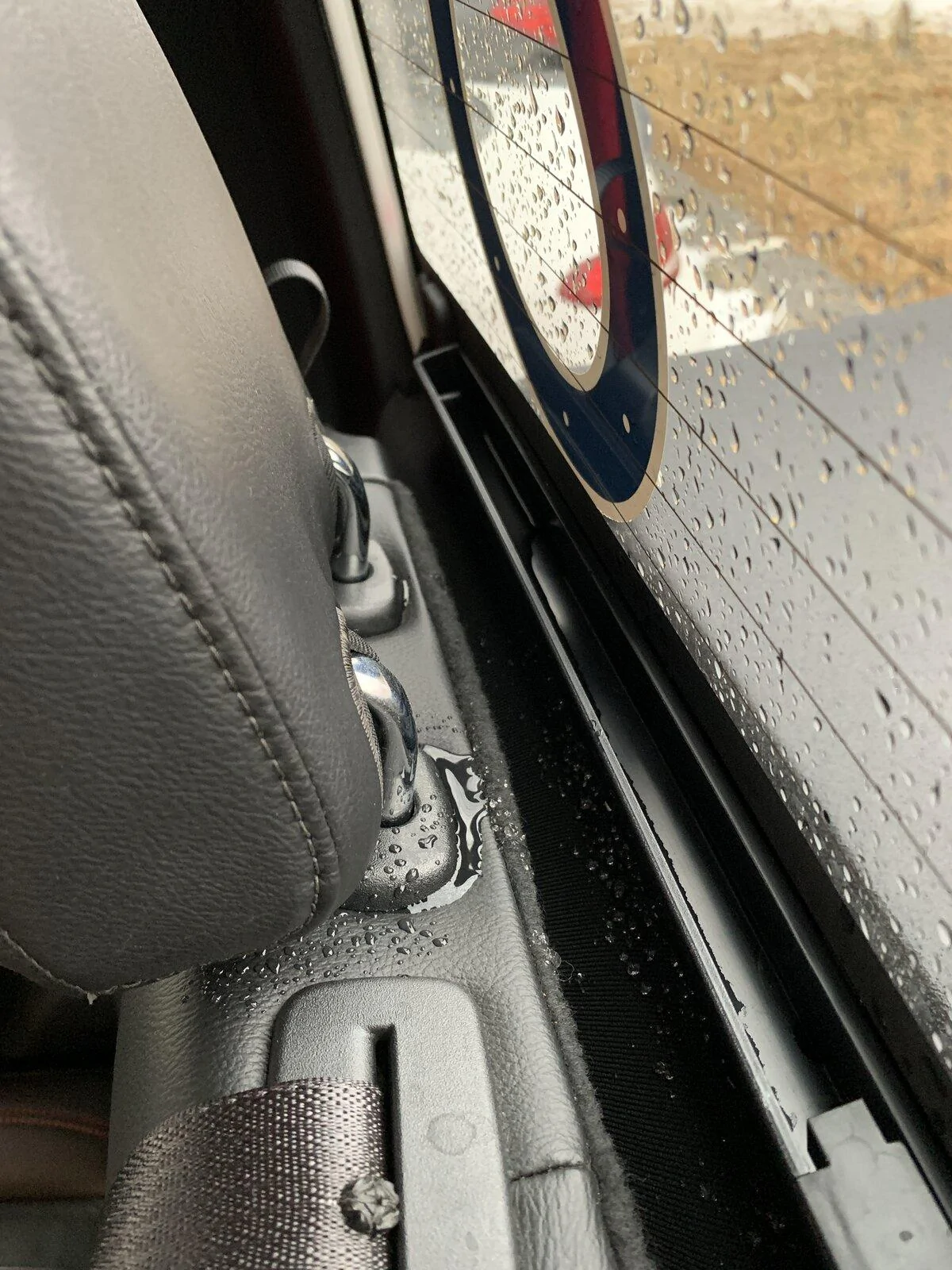

Rained yesterday and here are the results.
Jeep Gladiator Roof leak in back 470065B1-1C51-4D55-9AD1-FE8FCC7E8DB7
Jeep Gladiator Roof leak in back CFF0DDED-6F50-434D-9A14-66F2508850DA
Jeep Gladiator Roof leak in back 31AD372B-14FF-461F-A59C-D8440EC5FC48
Took it to the dealer today for the leak specialist to look at it. The service specialist told me someone else came in with same problem and showed me a picture of the inside top of the window with the trim pieces removed and you could see the seal was damaged. They are going to look at mine and if it looks the same, they are suggesting replacing the seal and window.

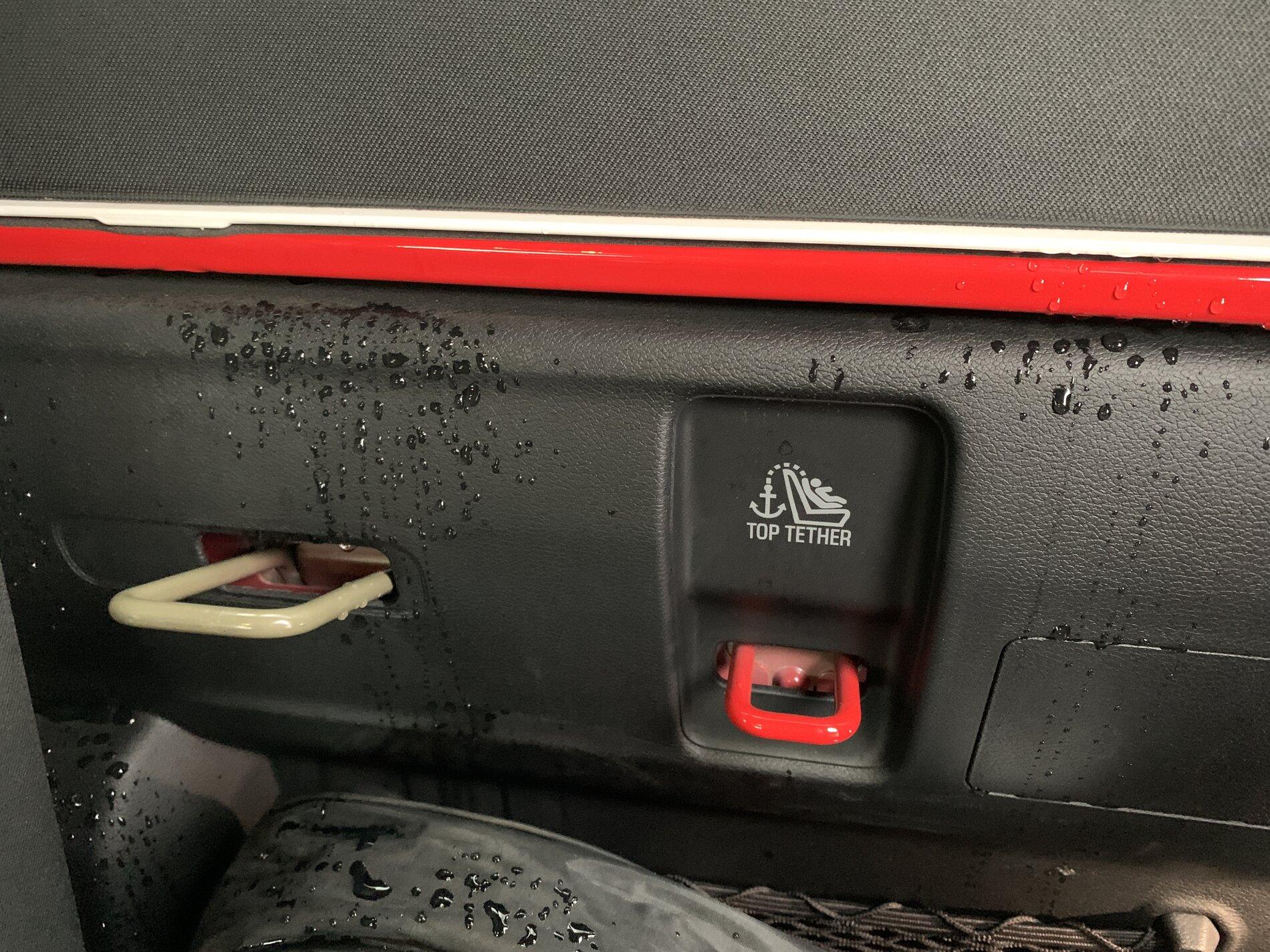

That's a long time to wait, guess I'll get in line too. I did stop by Lowes and get some weather stripping. Install took about :30 and hopefully it'll keep the water out.
Jeep Gladiator Roof leak in back 4CADD363-C02A-41CF-A275-6DBD496A506E
